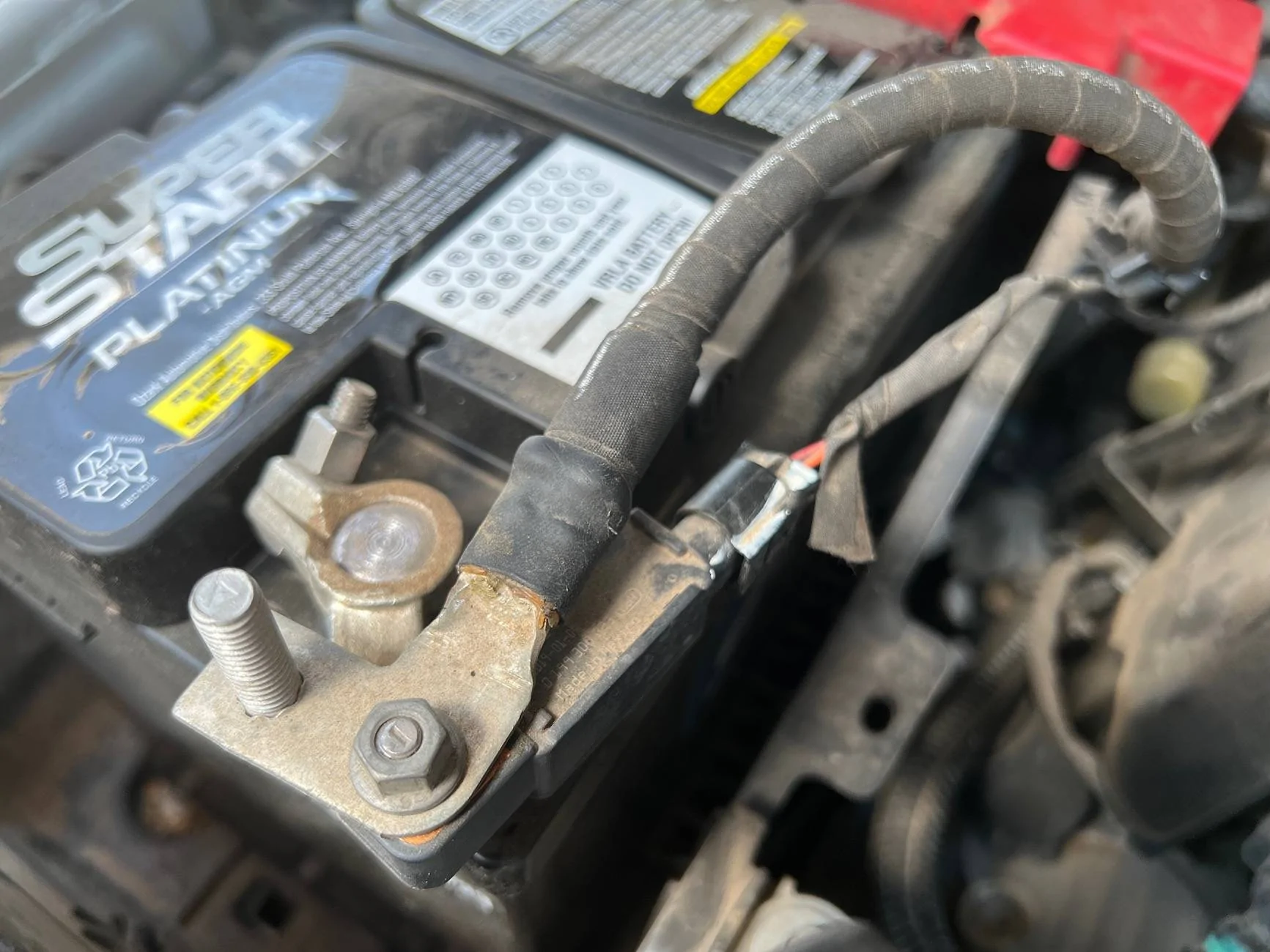

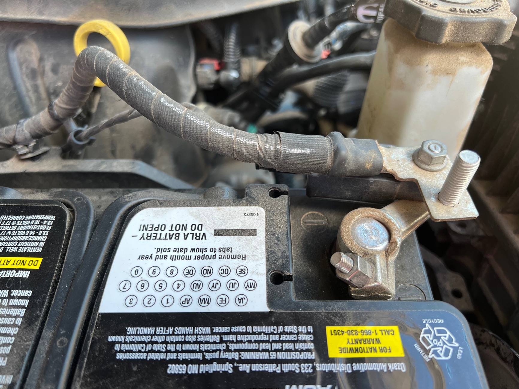

I really appreciate all of the information you guys are providing. My cousin and I are giving this a try, but the chords going to the main battery look different from what I’m seeing on YouTube.There is only one thick cable along with a small and skinny one.

After much online research, it appears that my model does not have an Aux battery. I have a 2.0L engine.

How old is the main 12v battery? Looks like an aftermarket that's in there. Tried having it tested yet?

Etorque for sure, if the 12v battery isn't charging it's got to be a problem with the 48v battery, DC to DC inverter, or belt start generator, all of which are covered by the 8 year 80k mile emissions warranty. The 12v battery however isn't covered. The smart move to avoid a costly tow and repair bill is swap the 12v battery and see what happens. If all is well it was just a bad battery. F it isn't charging/ starts to drain, it's covered. All the other issues are just the weird symptoms of low voltage in a modern vehicle.

Yep. Doesn't mean anything, batteries can just go bad. I'd say it's suspect until proven innocent :)
And it's a 5 minute fix that costs less than 1 hour of diagnostic time at the dealer. Odds are it is the fix, if it isn't you're only out $150 and your Jeep has a brand new battery.
