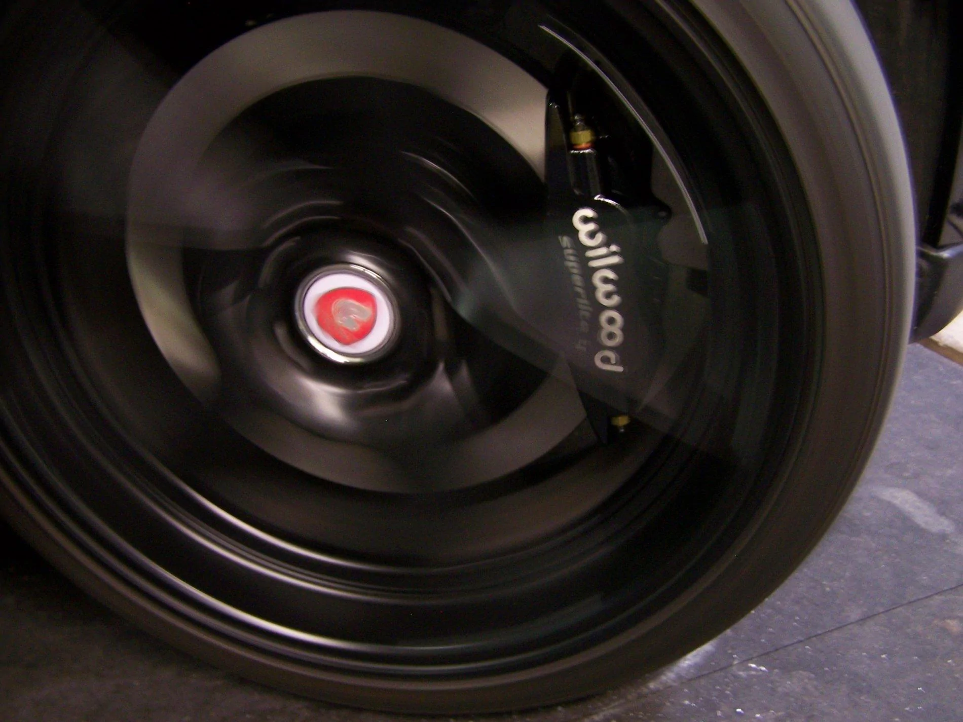

I see you have what looks like Milestar 37 or 38 tires. When I put large tires on my truck, I went to a larger rotor and 6 piston Wilwoods. It really made a difference. I currently have stock BFG 33s on my JLUR and I think the stock (large) brakes are fine. But if I went to larger tires, I'd figure the cost, of at least the front brakes in an aftermarket kit, into a tire upgrade. I think aftermarket brakes are the most overlooked performance upgrade. In fact, some guys over on the truck forum I used to hang out on, wanted to argue that it wasn't a "performance" upgrade at all. LOL.
But to your point about replacing the lines, my experience is that it isn't much of an improvement. But if you're at the last few percent of braking power, definitely do it. But the effect of such a large tire really needs more brake, either by larger diameter or more clamping force. If you have gone to a PSC steering system with a pump, there's opportunity to use a hydra-boost, which will provide a huge boost in brake line pressure over vacuumn systems (definitely go to better lines with this).
