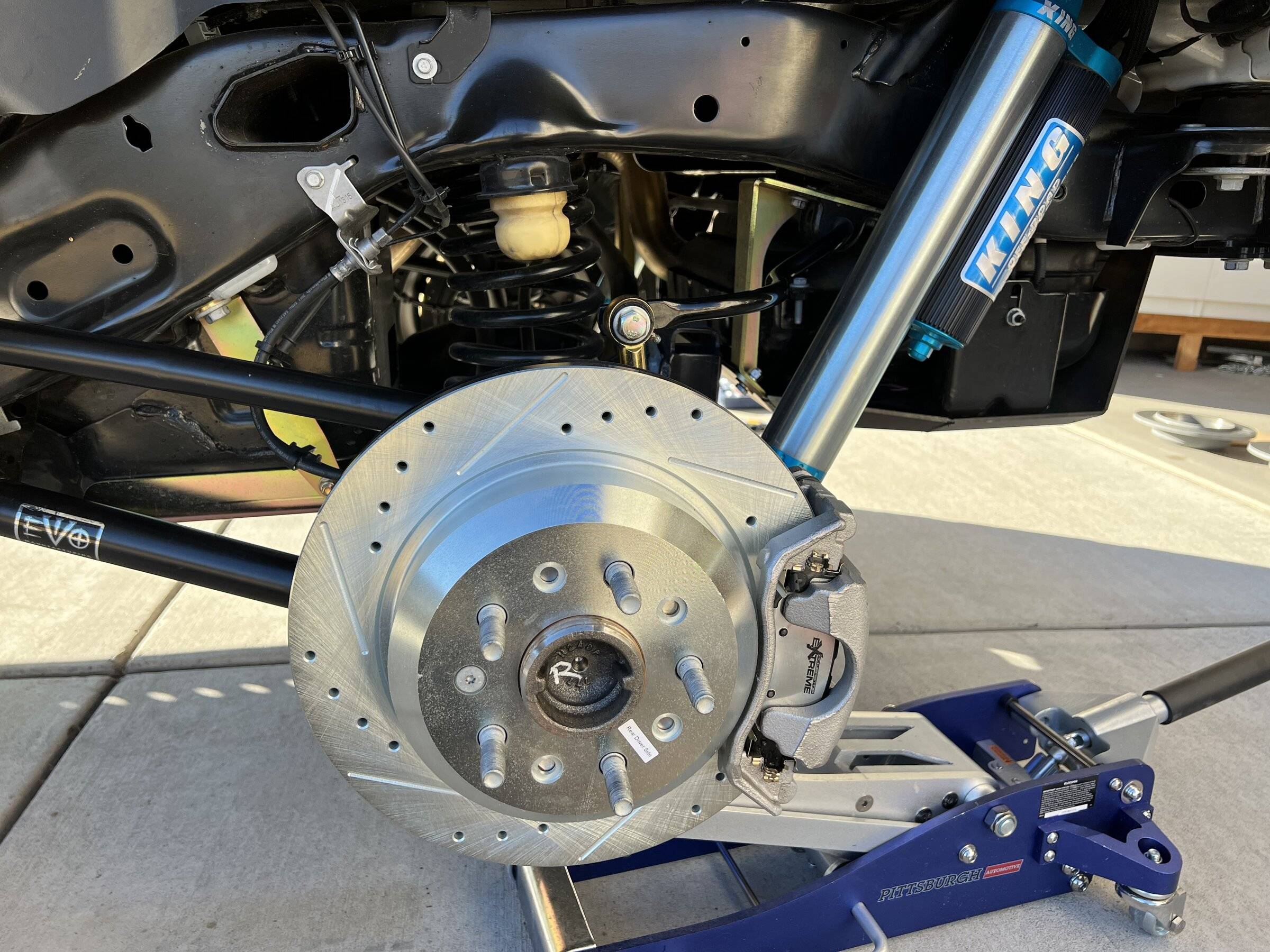

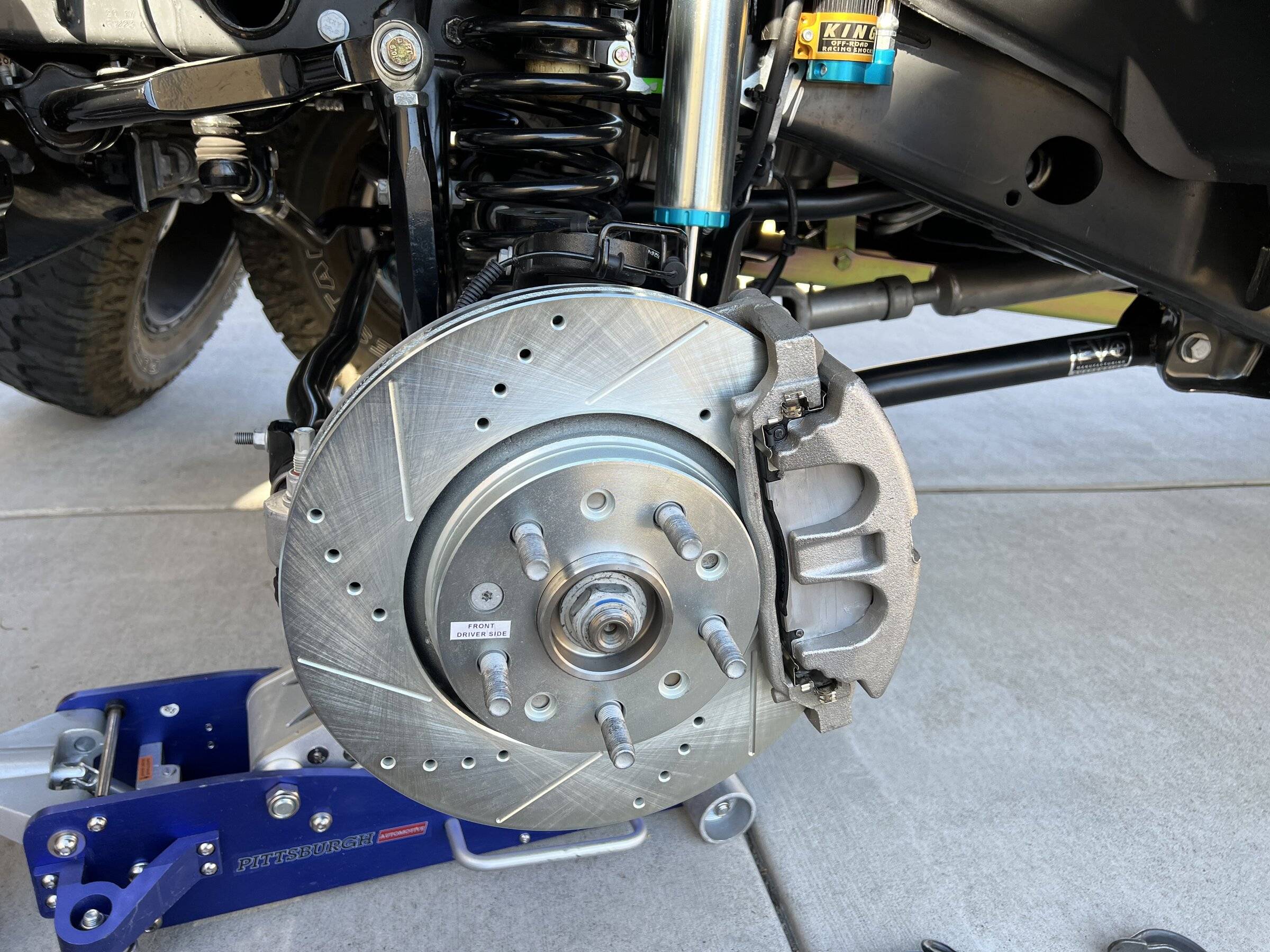

Pull your wheel And remove the brakes pads so you can inspect them.
Jeep Wrangler JL Brake squeal at start-up 07994AC6-296E-4BB3-AFDC-9E72EC5E102F
Jeep Wrangler JL Brake squeal at start-up 7627DF0C-50A2-4409-8AEC-5D04454006E3
I replace all my brakes and rotors at 3k miles because stock brakes suck and did not perform. Most likely your pads are worn and you need to replace them.
