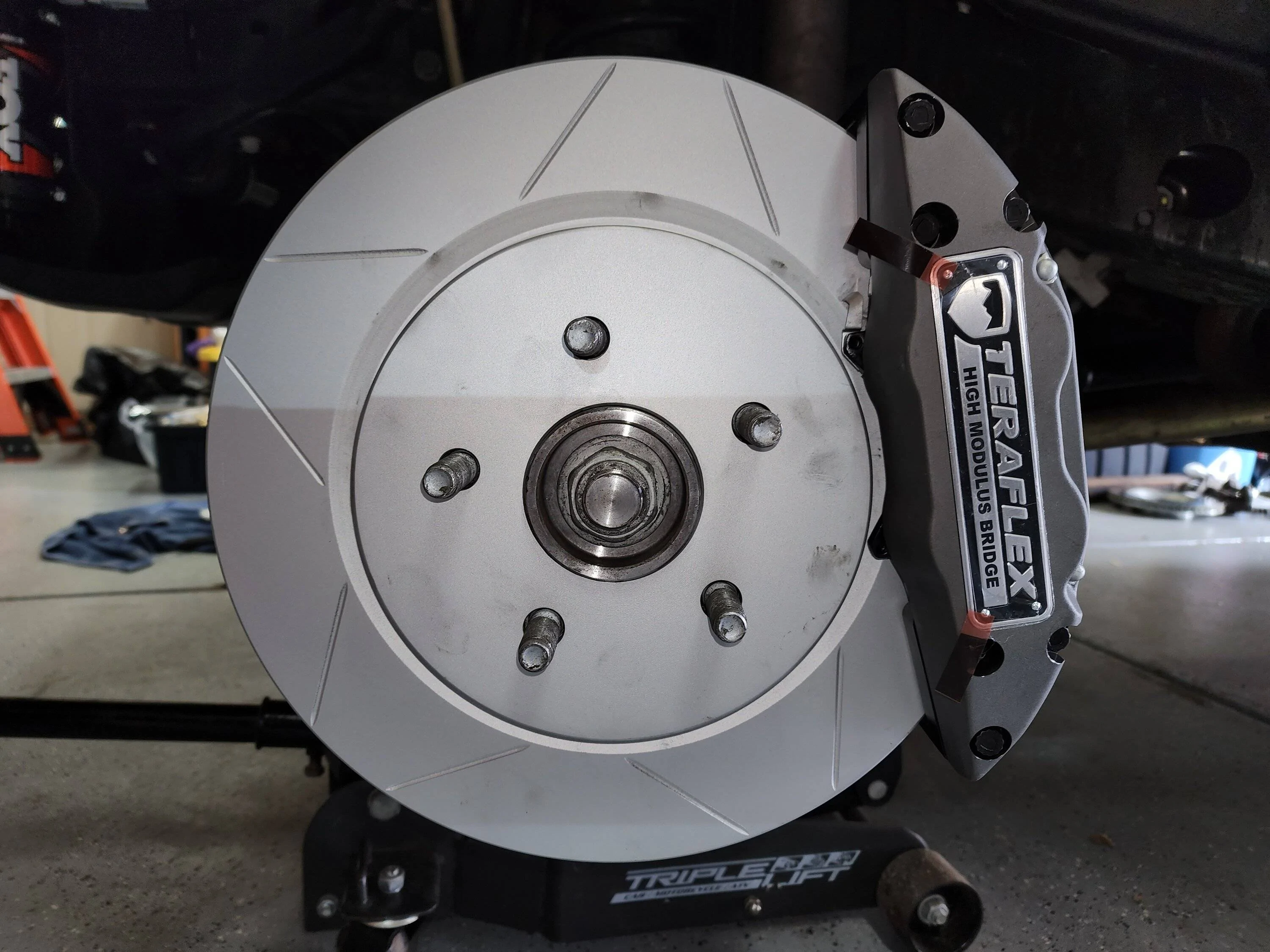

Without question, this:
Jeep Wrangler JL Brake pads make a difference? 20230414_094252

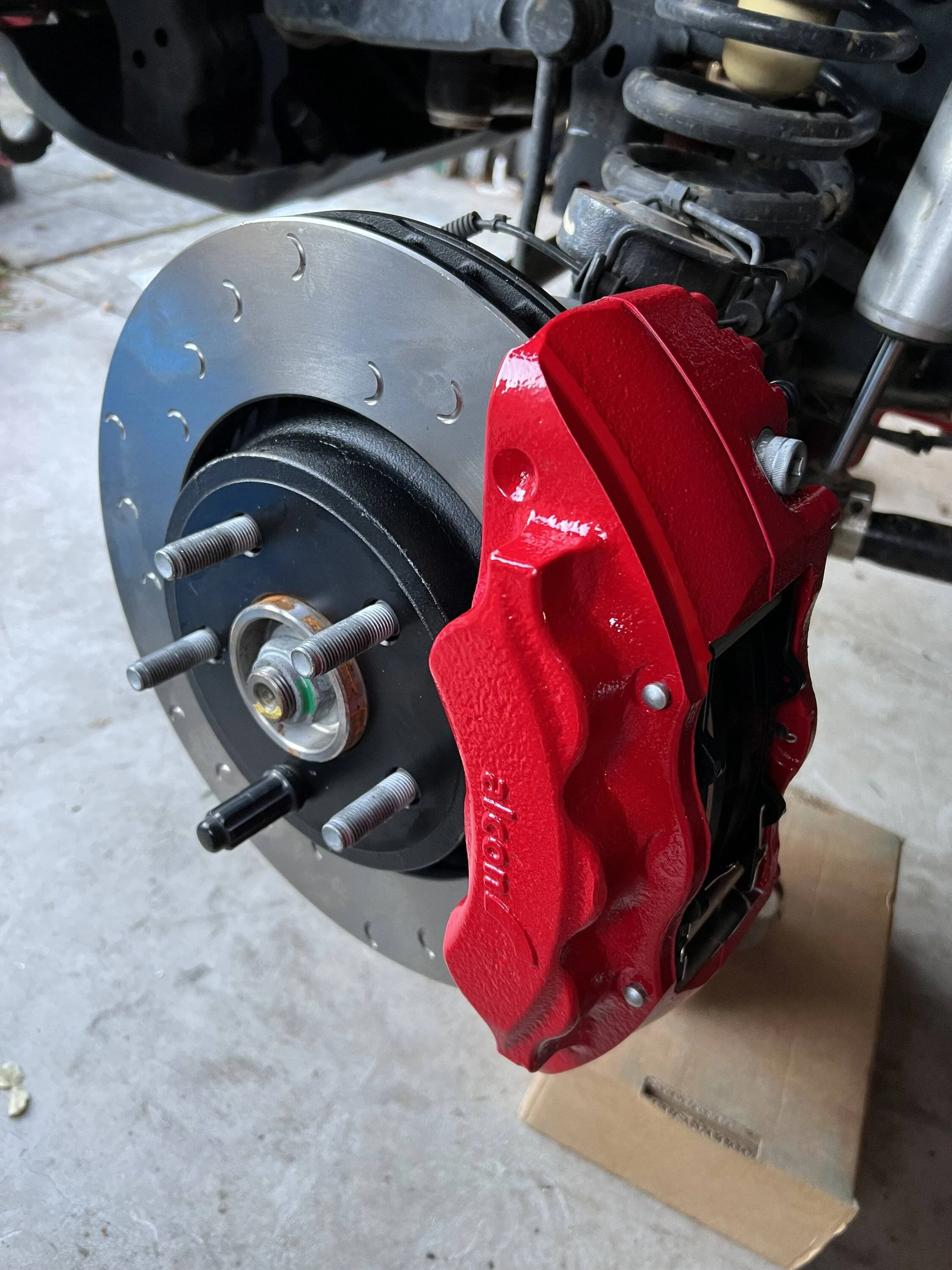

Will never match this:
Jeep Wrangler JL Brake pads make a difference? 20230414_101331

interesting; i had pictured a bigger difference in outer diameter and swept braking surface.
The rotors are larger as is the pad contact area, but the magic is 4 pistons on all 4 calipers for a total 16 pistons versus 6.
The clamping force is exponentially higher than OEM and because the pistons are pushing on both sides simultaneously, less pedal effort is required for more braking pressure.
As far as the rotors not being interchangeable, it is much ado about nothing. I would guess than many of the brake rotors included with aftermarket brake systems are not interchangeable with anything OEM nor would you want them to be.
The Teraflex rotors are not only thicker, but much heavier. You may eventually wear them out, but it will not be any time soon. You could always run softer pads and allow them to be the "sacrificial anode".
