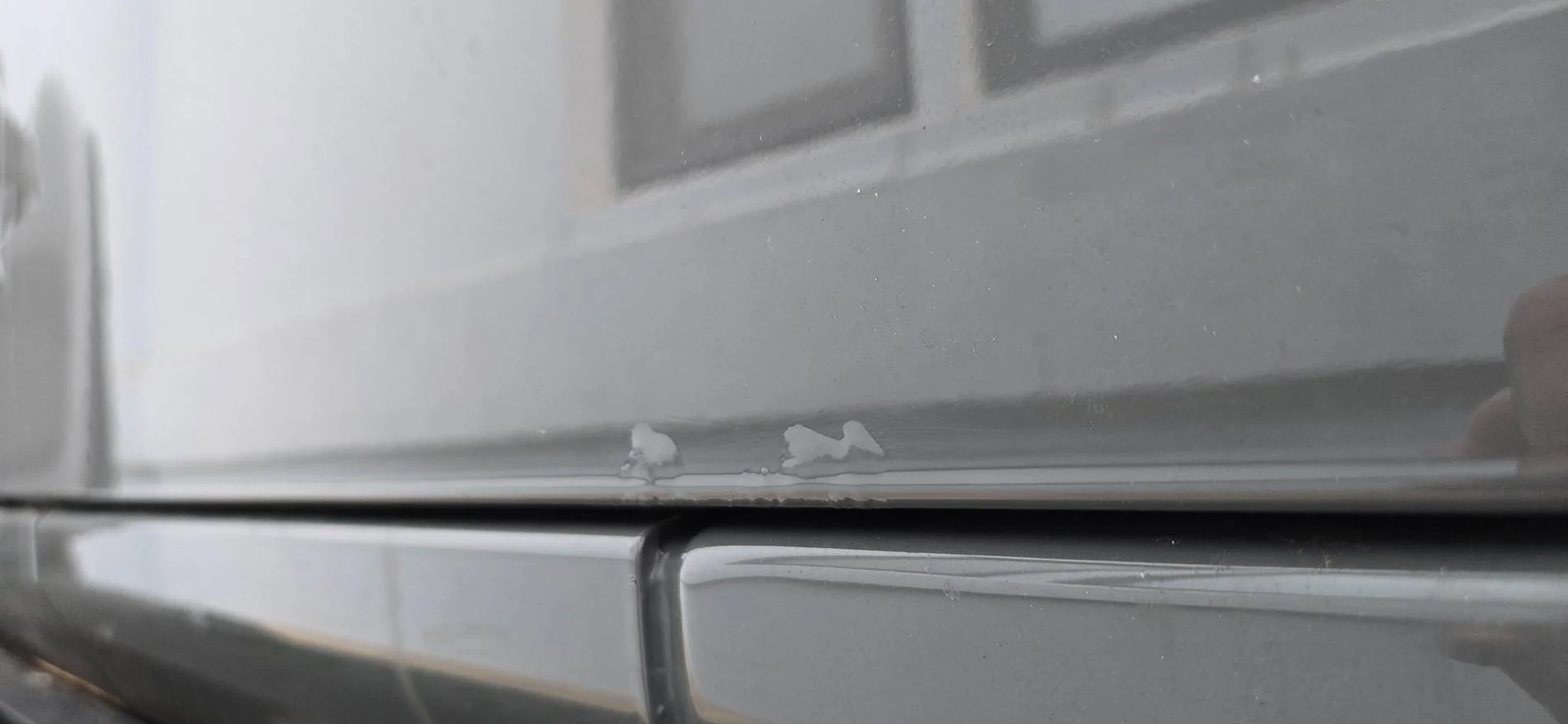

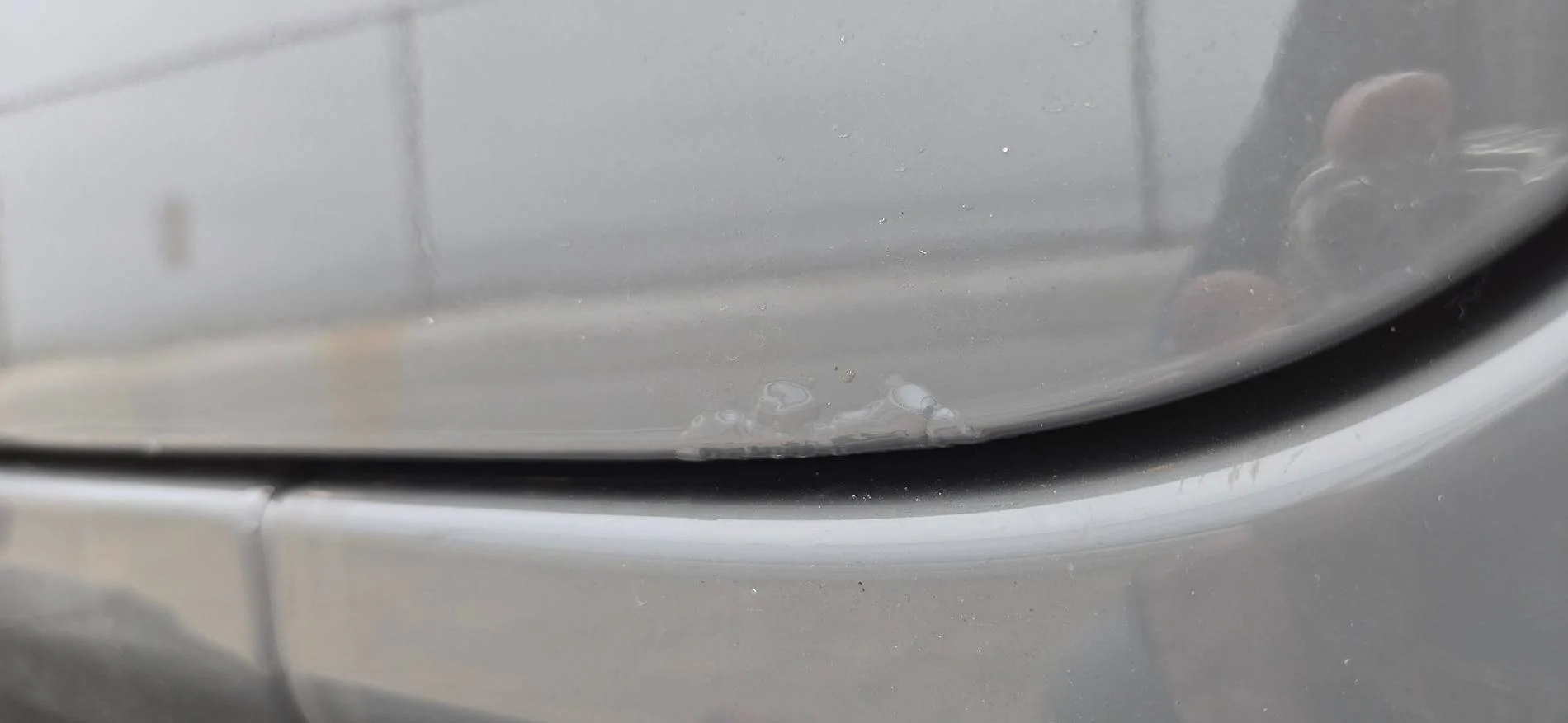

Is this what I think it is? Have this on bottom edges of 2 doors.
The Jeep is barely 2 years old, has Expel protective film installed on all surfaces (including all door edges with film wrapped around them). Zero damage to door edges (no dents, scratches, anything that would penetrate the paint). I even sprayed a bit of Blaster Surface Shield inside the cavity of every door a few weeks after taking delivery.
WTF???

My passenger rear is doing it, along with all the hinges. My clinic manager’s JLUR had it on the hood.
ill be getting mine repaired under warranty this summer while im on vacation.

looks pretty typical.
since the issue is with the prep before the paint is put on, no amount of protection on top of the paint is going to make any difference.

Your warranty covers corrosion for 5 years. Personally I would wait another year or two to see how many more areas pop up so it can all be addressed as opposed to returning more than once. Oddly my 2020 has no corrosion signs yet.

This happened to my 2018; given you're in the 5-year period from the manufactured date, it should be covered under warranty. I would also check the inside of the door along the pinch seam/weld line. The corrosion can eat away at the inside of the door jam, and it will spread to the body of the Jeep. If I remember correctly, if the corrosion is just on the outside, the dealership will strip the paint and fix it. If the corrosion spreads to the inside of the pinch seam, they have to replace the whole door. My two cents would be to wait a little bit for it to spread to the inside so you get a full door replacement, assuming you have time on your warranty. I noticed it when the paint was scraping off, so I would encourage you to put something in the door jam to prevent this. I've heard horror stories of it becoming a REALLY big bill for people. The dealership quoted me about 12k for the 4 doors, but one bill they had was over 25k for the 4 doors' tailgate, windshield frame, and hood. I think it is the biggest issue with the JL platform

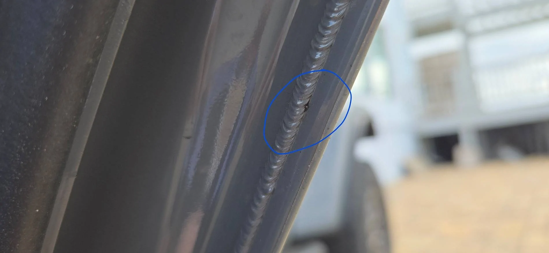

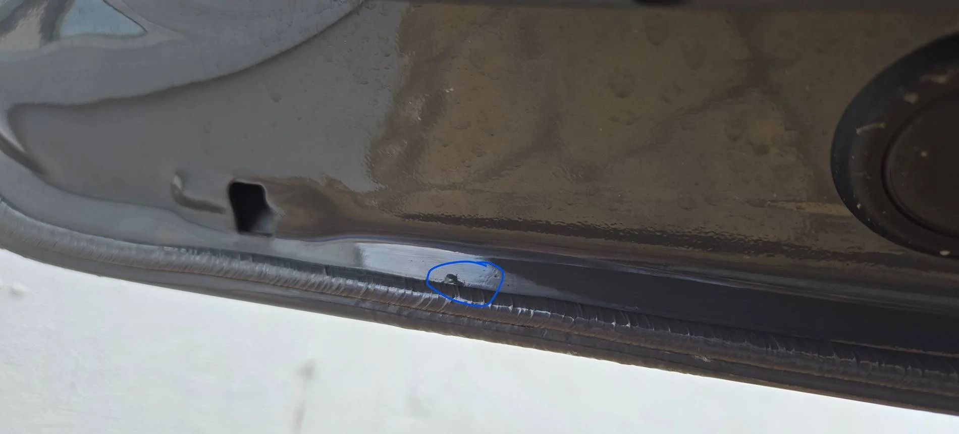

In this case the corrosion is coming from the bottom edge of both doors. I already found a spot of bubbling paint on the inside of one door and a spot of rust on another.
Still cannot believe this. Jeep is 25 months old and has 11K miles.
I agree with you that it does look like corrosion coming in. Unfortunately, knowing how a lot of dealerships are, I don't think that's enough to justify them replacing the door. I would still wait a little while to make it more obvious that you need a door. It sucks to have to dealwith it after 2 years, definitely not something you should have to worry about this early.
