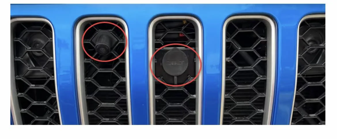

Hoping to revitalize this post…. Has anyone done anything successfully with this? I already have a Bolt lock installed. Now want to do the Z automotive trail camera. Can’t seem to find a lot from anyone on this. I did find a guy on the 4xe forum who mentions just mounting it to the side…. But he didn’t provide a lot of detail. Had anyone mounted it directly below? How did that work. Any pictures? How did it work? Any advice?

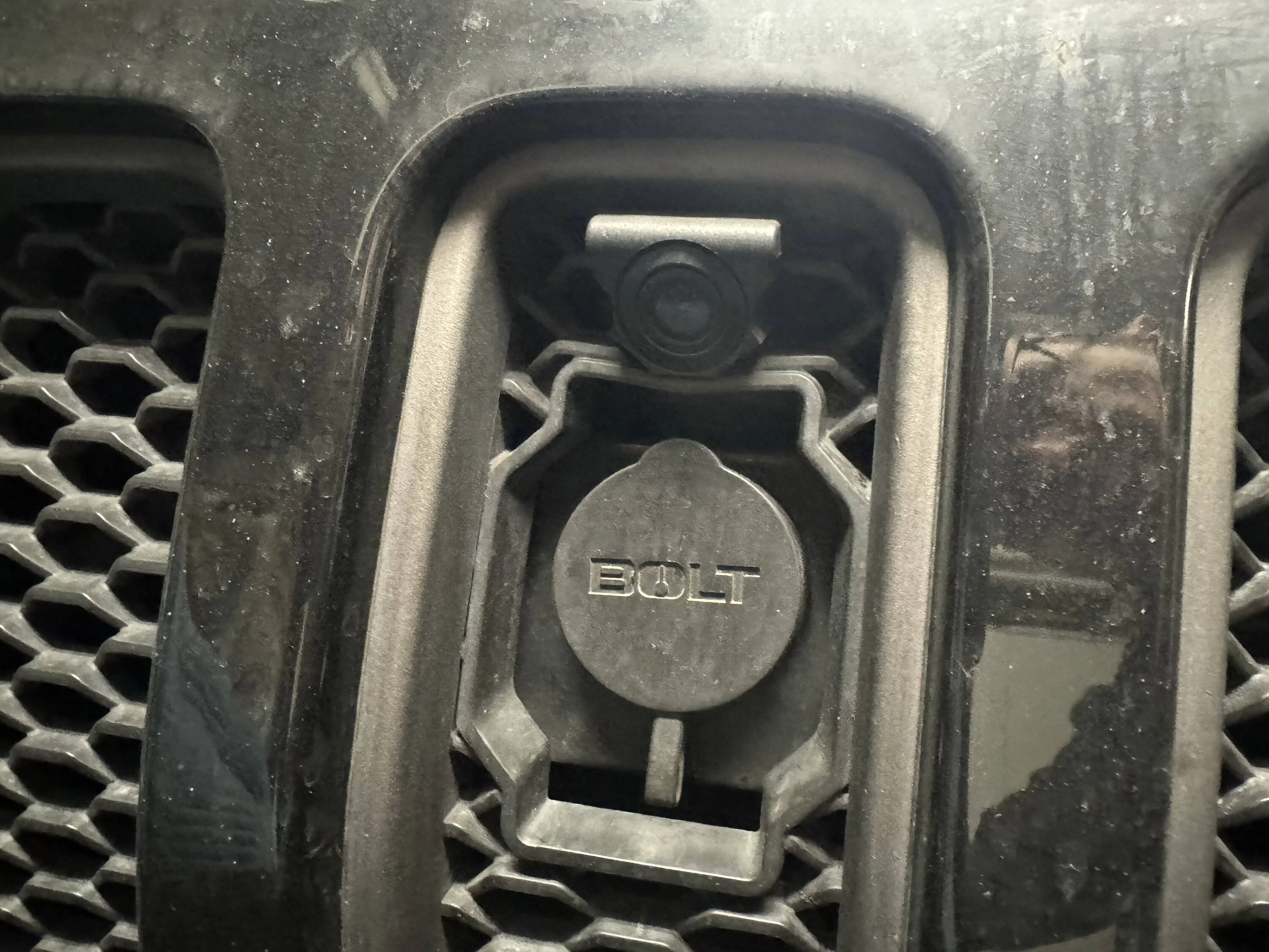

It’s a little anti climatic but here it is…. I literally just cut out the space right above the lock. It just fits. But - absolutely no issues. Sorry I didn’t take a picture of it before mounting the camera……. Good luck with it.

One additional comment, @Racerxtx , part of what I was nervous about was that the bolt insert is much thicker where the camera has to go in. But you can see from the picture, it just seemed to push down a bit and everything fit in place. So in short, I just did the cut exactly like they recommended when I was mounting the camera. And just more or less ignored the fact that I was using the bolt grill insert. It all came together. Let me know how it turns out for you.
