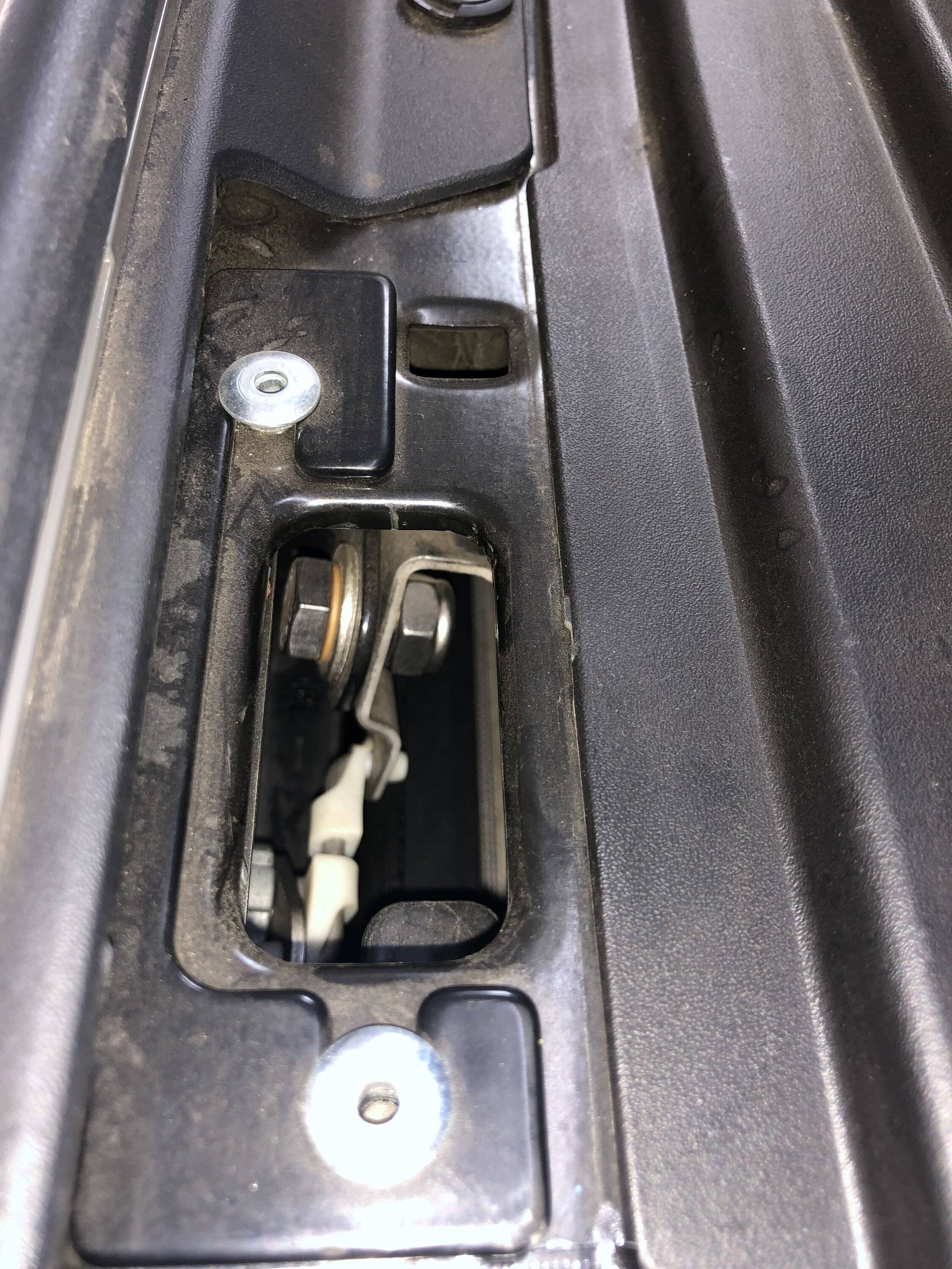

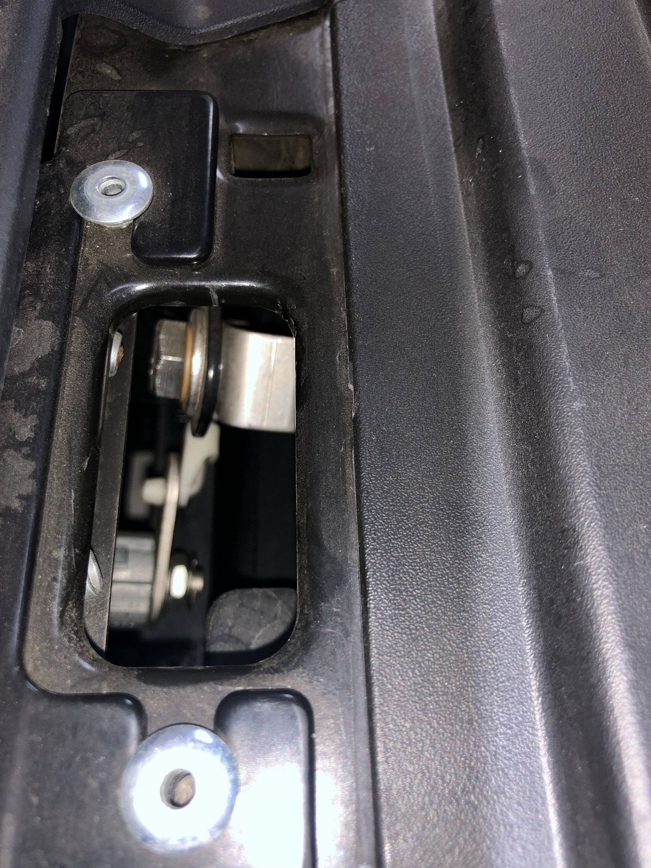

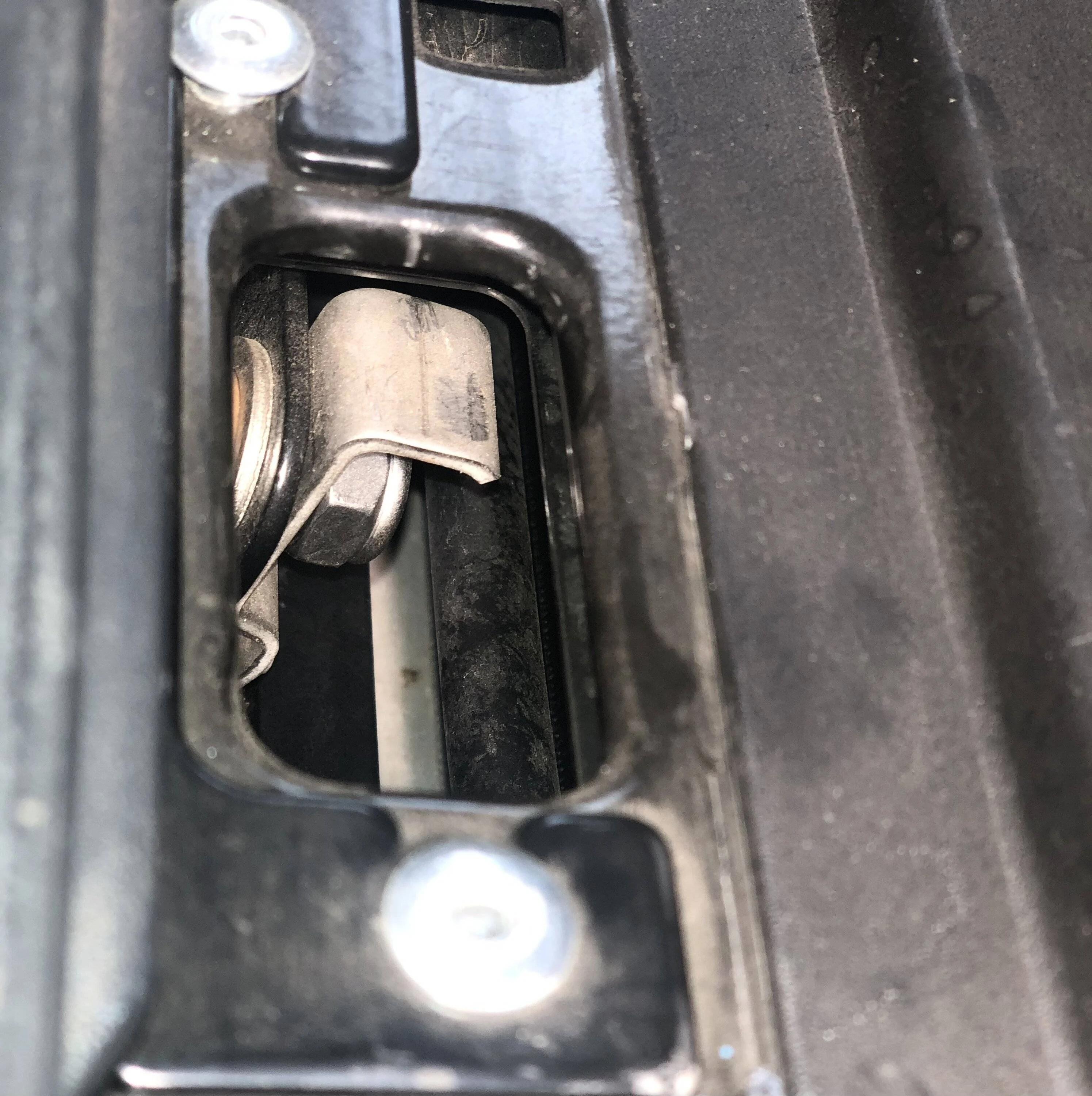

Looks like you’re missing one of the top rivets. I wonder if that allows it to shift enough to cause interference. Here’s some pics of mine. I have about 1/8” of clearance (last pic) where your latch is hitting. I tried to show pics at various points of the the latch as it moves from locked to unlocked. Make sure your hardware and internal mechanism looks similar to mine. Then maybe send your video to Bolt.
