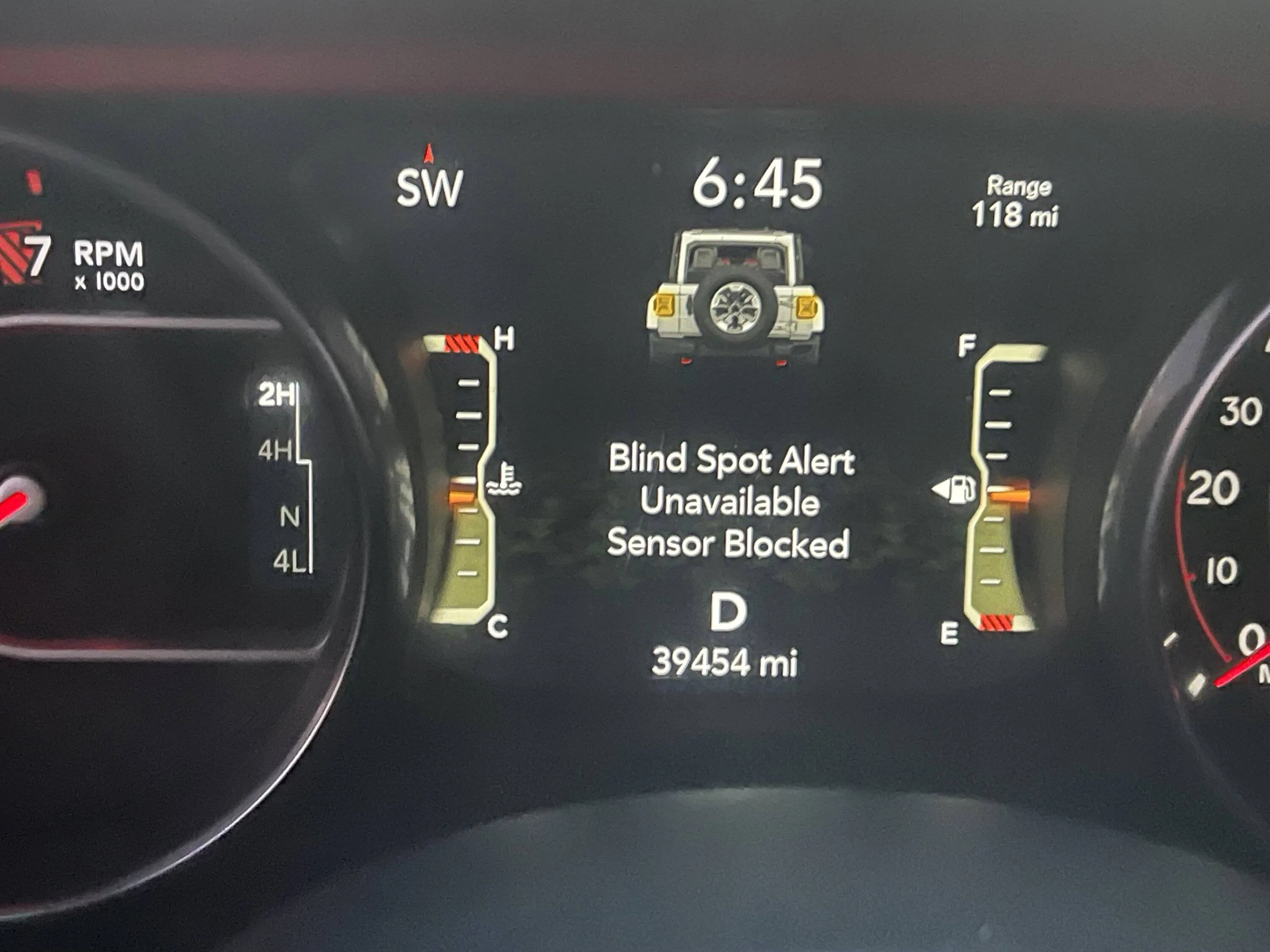

Hello All,
I have a 2018 Jeep Wrangler Rubicon 4-Door,
I recently got it used with one owner. Since getting the Jeep it has been a dream come true. However, there seems to be a error with my Blind Spot Detectors. The keep triggering on the road when nothing is next to me. So I took it in to my local Jeep dealership. The first time I took it. The said that there was not issues or errors and they were not able to recreate the issue. Note, I had all turned off the car and it seems the error reset, and erased. The second time it the error came up I was able to had straight to the dealership with the car on. They were able to pull up a error code, and it was for a sensor number nine. They had it a week. And claimed to have fixed the issues. That same day I pick up the jeep the error happened. The manager told asked me where the issue was happening and what I was doing, and what my surroundings look like. I told him that I was getting the issues in specific areas, and with nothing and no one next to me. I also told him the I thought there is a shortage in the line or something. He told me that is seem to happening in areas where the signal is weak. Based on what I told him. Saying that the Uconnect goes in to dead zones and that is why the error happens. Does anyone know how to fix this issue? It can’t really be a Uconnect issues since people take Jeeps in to the mountains and trails where I am sure many dead zones are. And this issue would have been fixed by now.

Well mine has the two tail light ones and the four on the back bumper. But that is what the computer pulled up. And I saw it. When he connected the OBD scanner to his computer to check the codes. That was the error that popped up. And that is what they claimed to have fixed. But the sensor still messes up. And just like someone else hear stated, one will go off like if someone is there, then shortly after the other one will, then the car dings and the screen show the image I have posted.
