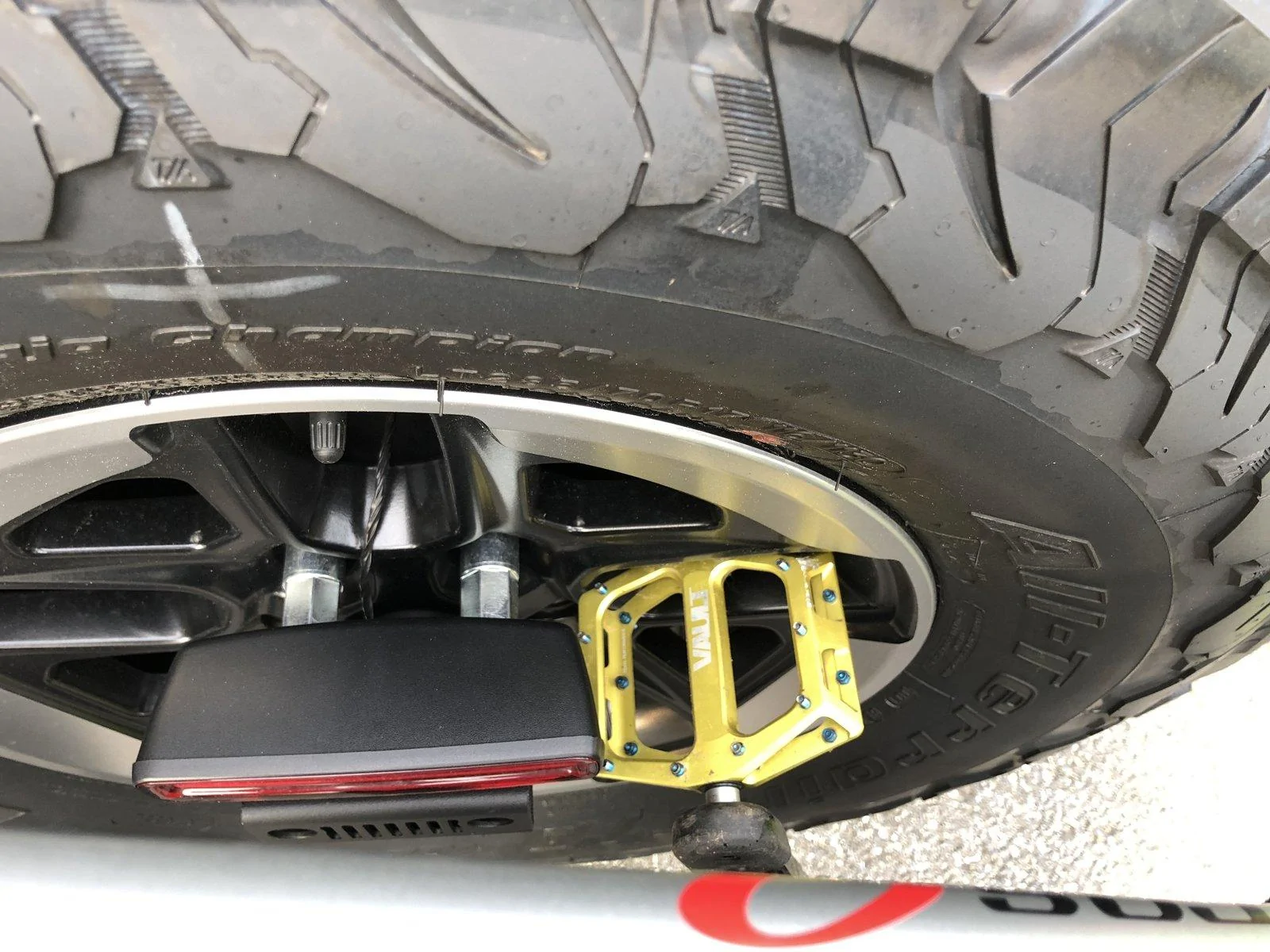

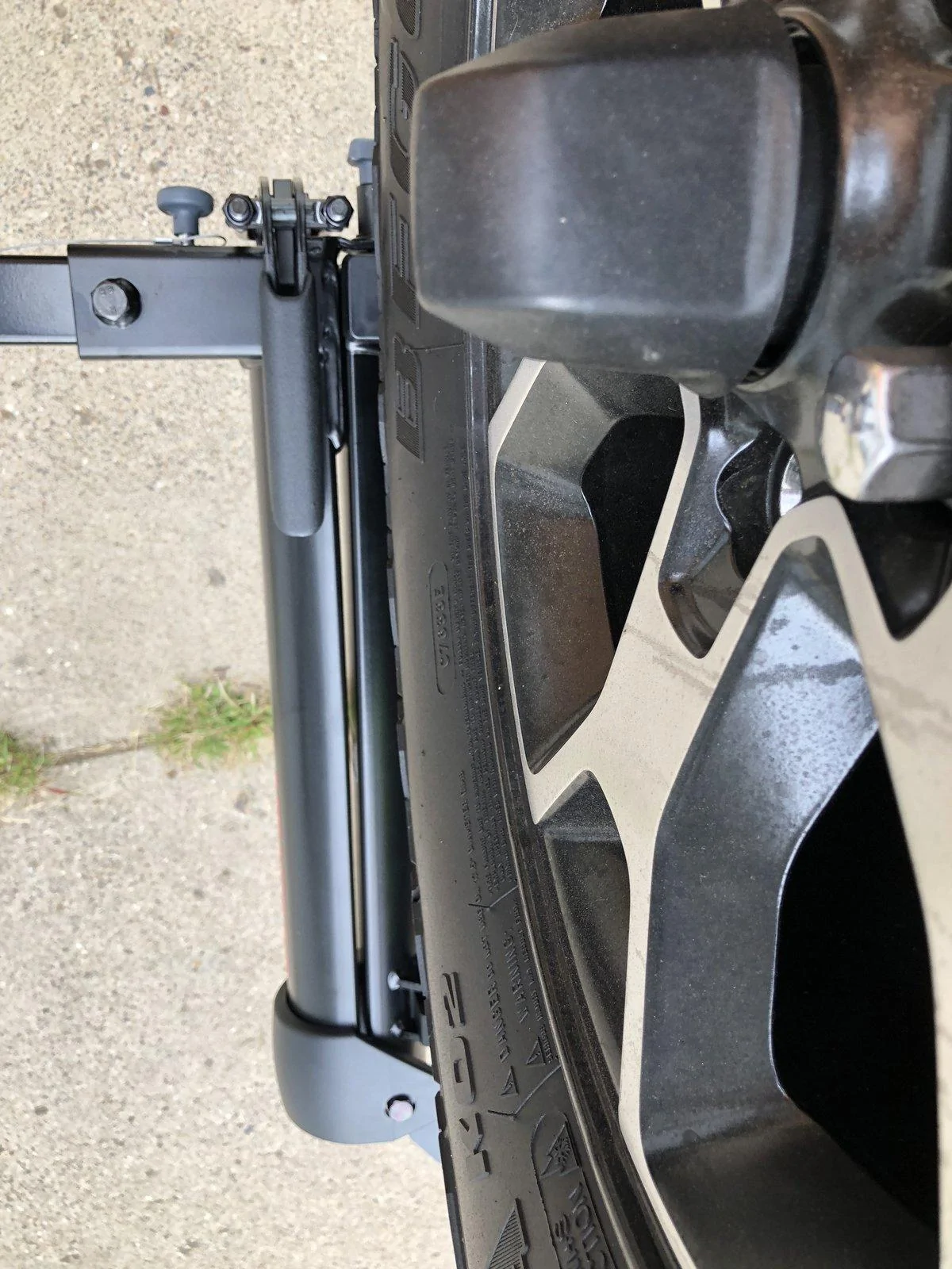

    Just in case anyone else is looking at the Yakima Single Speed hitch Mount here’s some pics. I tried to use it without an extension, but the pedals hit on the tire. I have flat pedals, so you may get it to work if you run clipless. I ended up using a 7” extension and it fits perfect.
    My preferred mouting is inside the Jeep via a 2x6 and fork mount so I can secure the bike when I know I’ll be running errands and such before or after riding. When I know I’m heading directly to the trailhead and back I use the hitch mount as it’s much faster loading and unloading. Also, despite some reviews online this things doesn’t sway or wobble more than any other hitch rack.

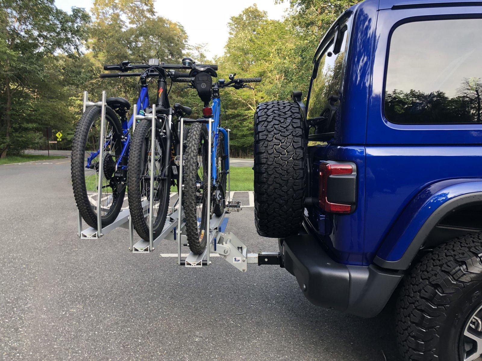

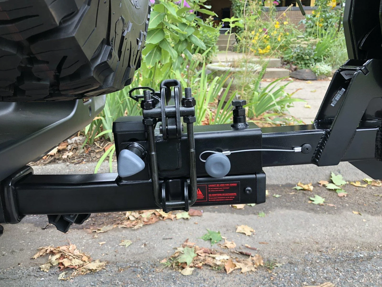

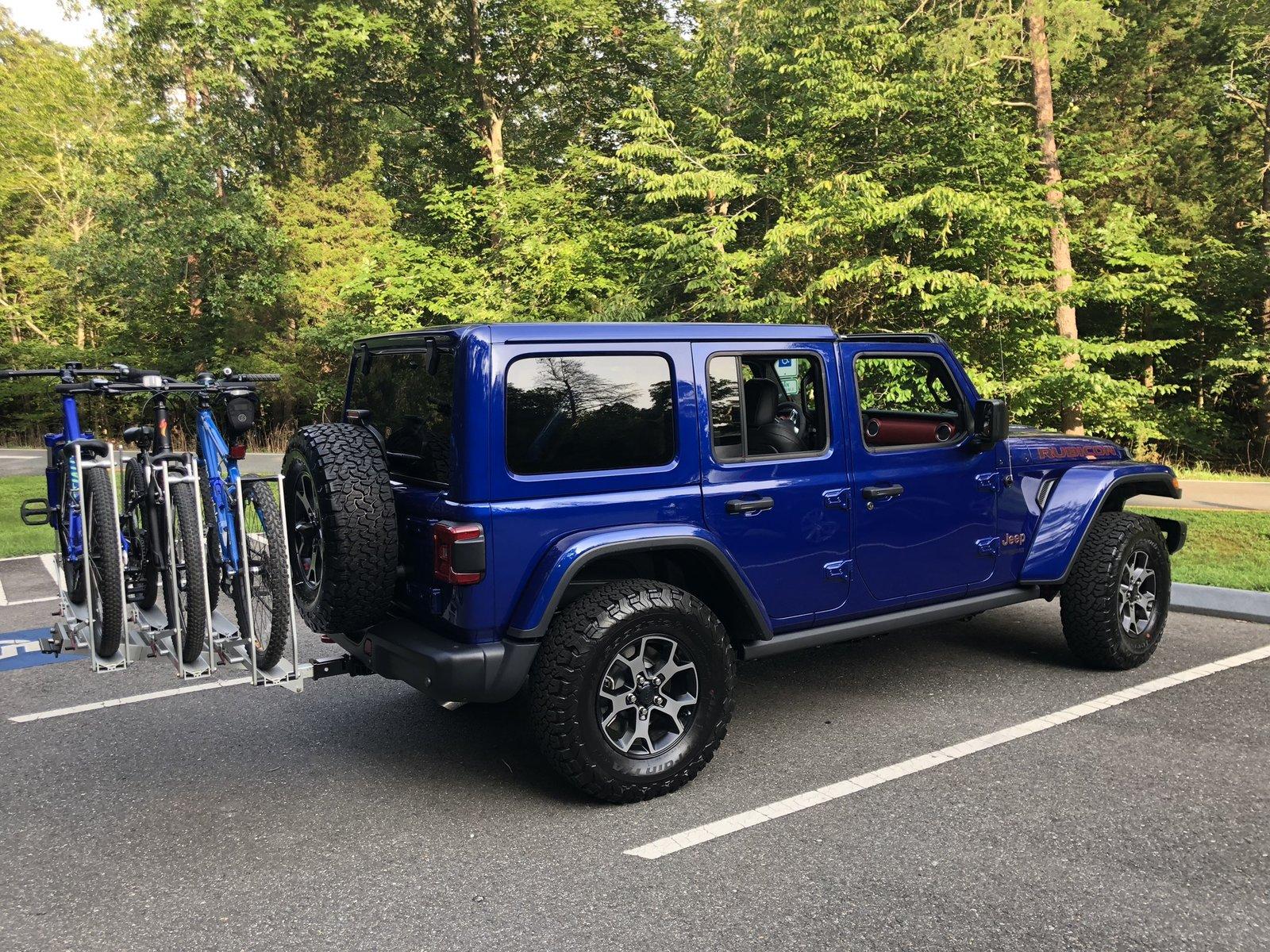

    Picked up our new ride yesterday. The 1up rack fits great with the extender they sell. But I think if I put bigger tires on they won’t clear the rack in the down position. Anyway I prefer the black version they sell. The quality is great! Expensive but no plastic and made in the USA!
    Covfefe likes this.

    Can you open the tailgate with that extension? I've currently got a 4" drop extension and would prefer a non-drop version as long as I can easily get in the back.

    You can but it was tight. The rear tire squeaked by. That was why I made the comment about the tire size. I think anything larger than the Rubicon’s stock 33” tire isn’t going to work if you want to open the rear tailgate. I probably won’t be upgrading tires anytime soon, so I’m good at least for a little while.
    On a side note, the extender that 1up sells is made by Acme products. Not sure if it is cheaper to buy it elsewhere but I really like how solid it tightens up with no rattling or movement. I am planning on leaving the extension on to tow my little trailer.

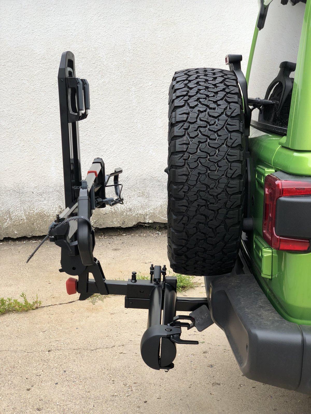

    Ok I got the Yakima Backswing and Dr. Tray installed today. This is a nearly perfect solution if you want an easy way to gain full access to your rear gate without removing bikes.
    PROS
    • high-quality product,
    • SKS "same key system",
    • built-in locks for the hitch, the rack and the bikes,
    • modular system so you can add a third bike if you want,
    • 4-way sliding trays and tons of room between bikes
    • full 90° swing away from your gate,
    • the lever is not obstructed by the spare tire,
    • rack folds up and out of the way,
    • dead simple operation, the release handle is in the ideal place
    CONS
    • very expensive
    • the lock cables could be a tad longer - they scuffed my painted rims because they were tight to reach the pin
    Overall I'm very happy with this solution. I had to have a swing-away solution so I could access the back of the Jeep without fuss. This was really expensive ( $299 for the Backswing and I found the Dr. Tray for $505 on Amazon ( yes newer model ) ) so that was not the happiest part, but I feel the quality is high and the ability to synch all the keys/locks is a big plus for me.
    Ask if you have questions.
