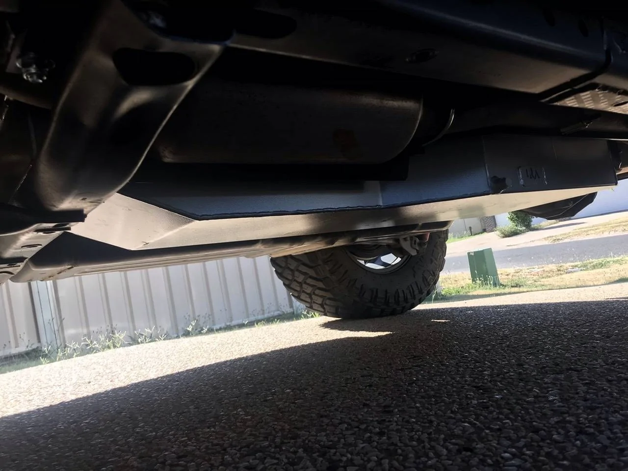

i Have a LRA tank. Not sure what capacity is in old fashioned measurements but I now have 146 litres
