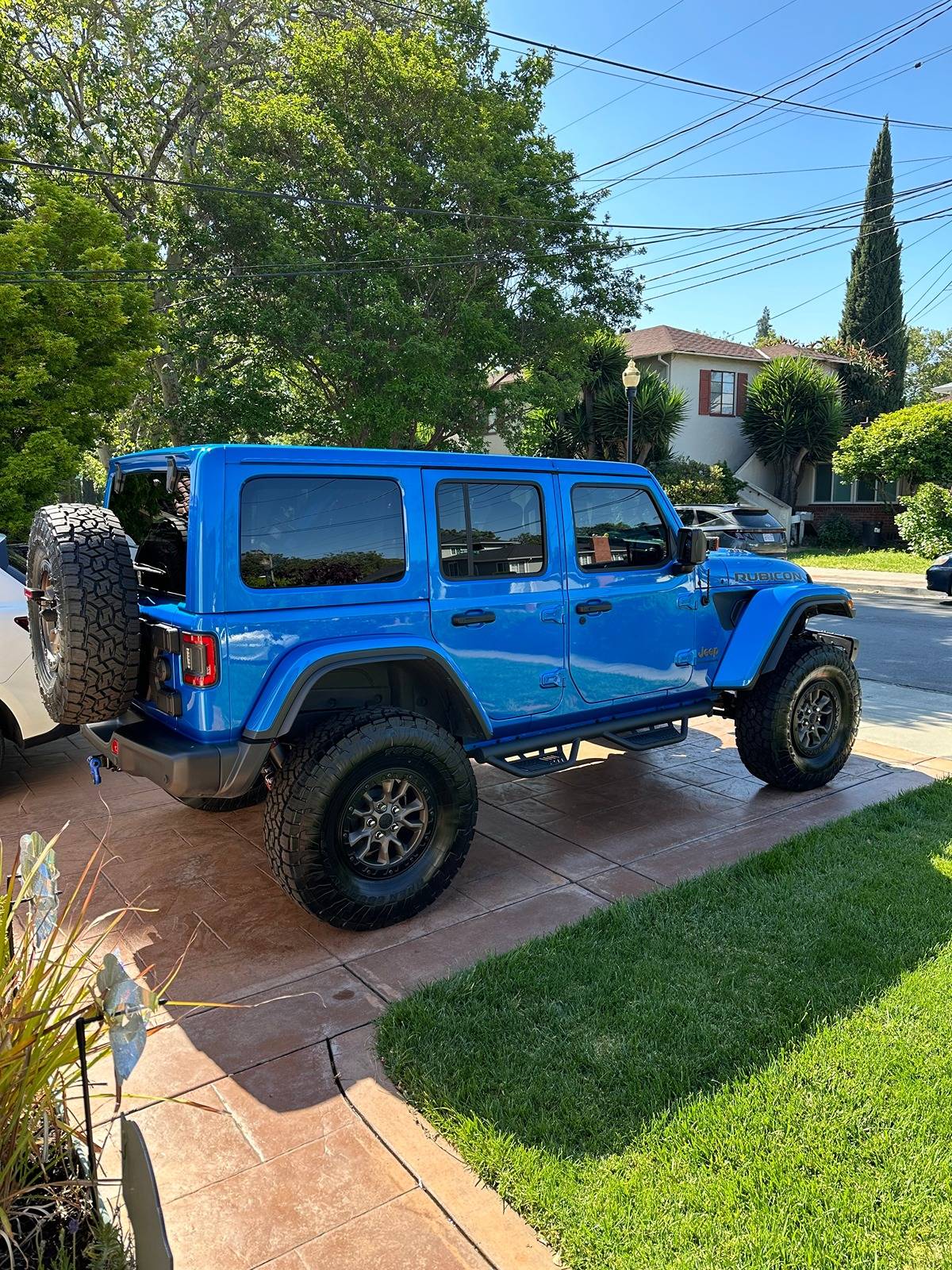

Hi, looking for advice on bigger brakes for my 2023 392. I have the stock 17 inch x7.5 inch Beadlock-Capable wheels with Toyo Open Country 37” A/T tires. I also have hub centric 1.25 wheel spacers. With the larger tires the brake petal is now a bit sluggish.
I don't want to have to change wheels / tires and hoping there is an option that would work.
Any advice would be greatly appreciated.
