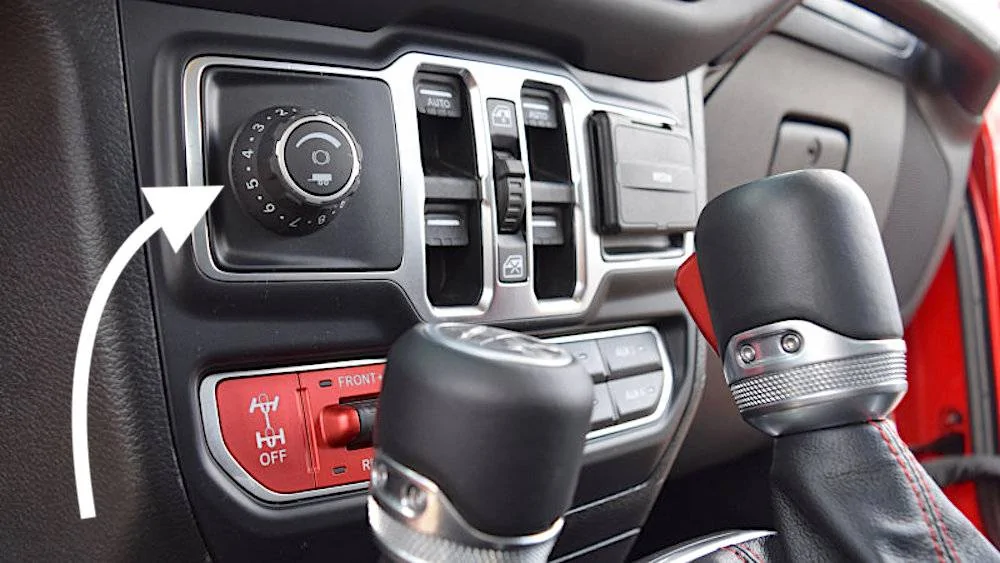

Do you mean this as a brake controller? Mine came installed on my 392 from the dealer with trailer tow package...to the left of the hitch? Sorry I don't tow things so I'm an idiot with that stuff lol

Yes I ordered the same tow package from the factory. It does NOT include a brake controller to work with electric trailer brakes, that you need to install.
