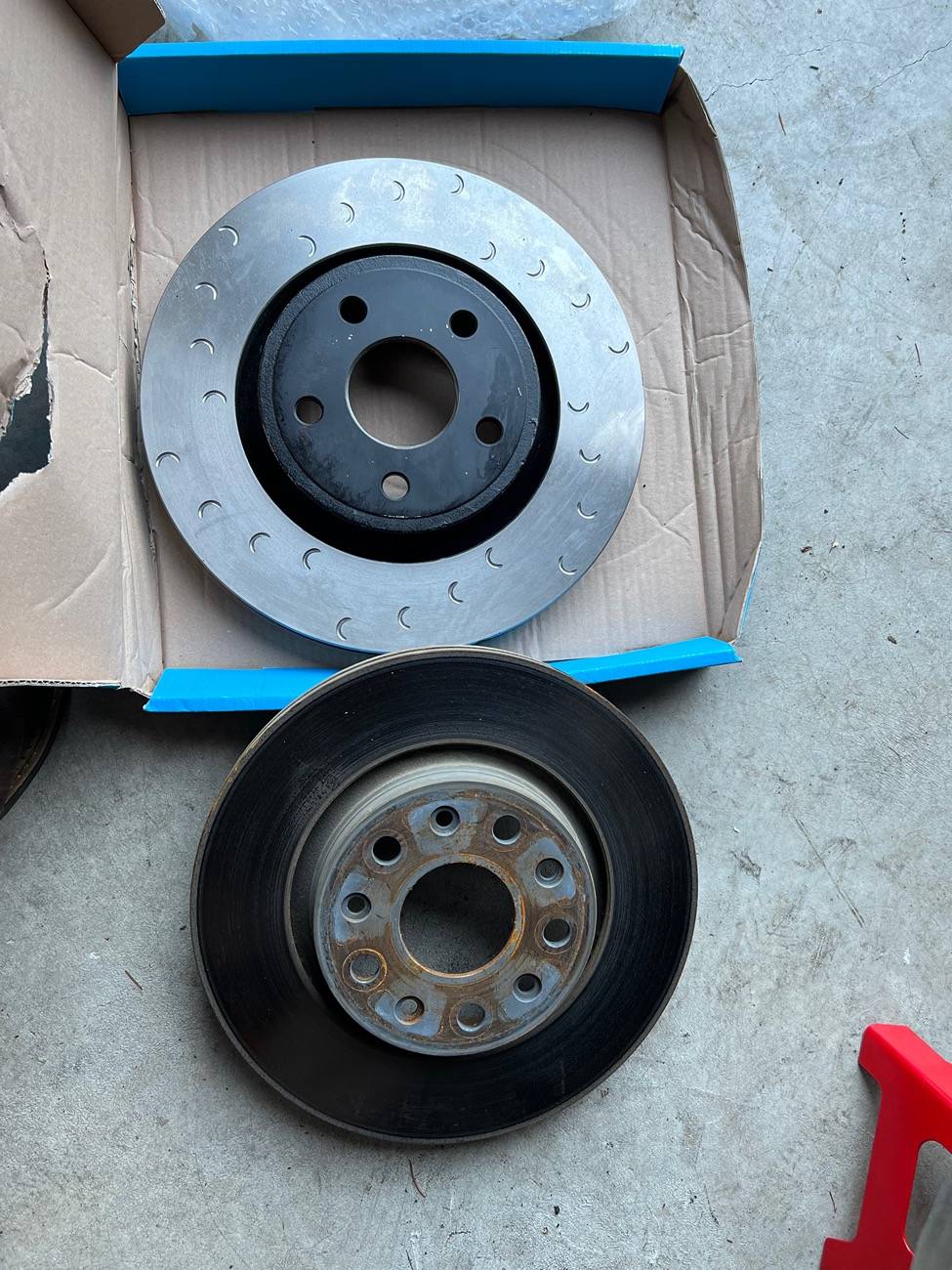

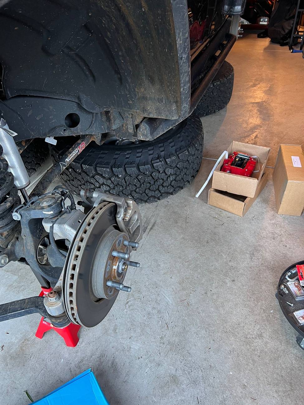

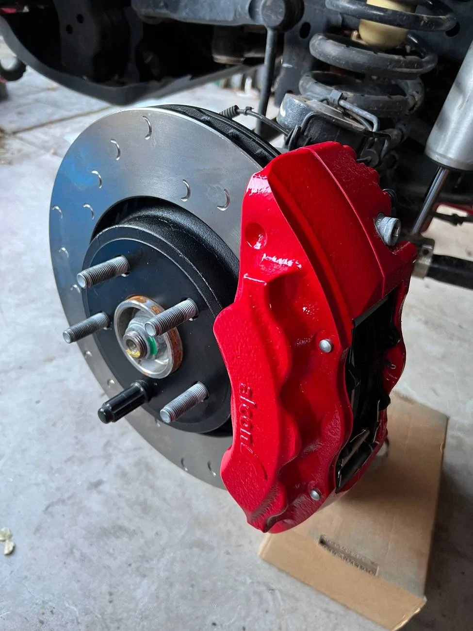

Jeep Wrangler JL Big Brake Kit for 392 IMG_4219
Jeep Wrangler JL Big Brake Kit for 392 IMG_4217
Jeep Wrangler JL Big Brake Kit for 392 IMG_4215
