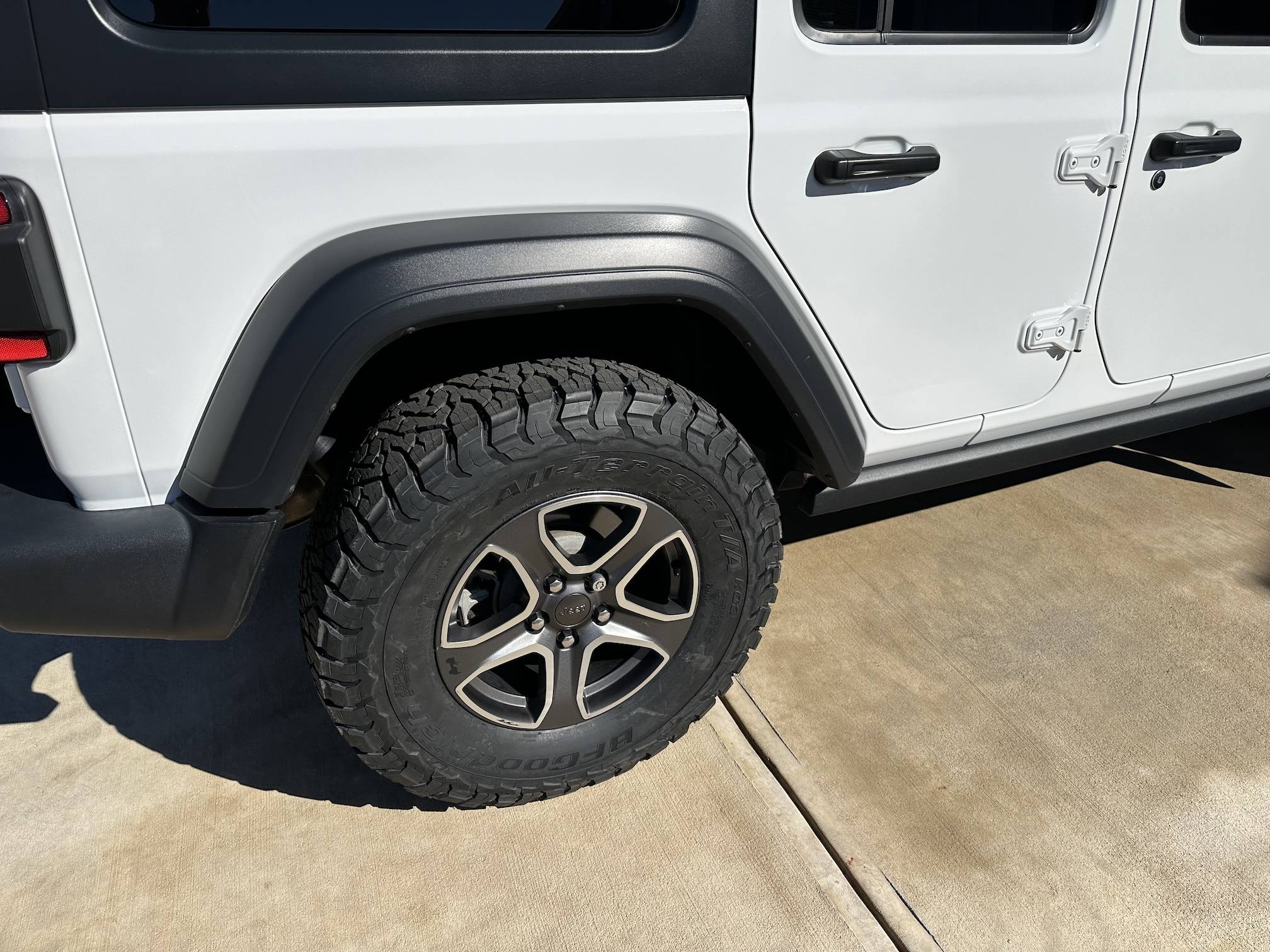

Got my 285/70/17 KO3s on this morning. When I left the right front TPMS was reading 56 pounds, guess they forgot to air it down after beading it :). I dropped them all to about 36 when I got home, I'll re-adjust in the morning when they are overnight cold.
So far so good, I had the Dueller 245/45/17s that the Sports all come with so the Jeep does feel like it's higher, even though I know it's about 3/4 of an inch at best. Definitely drives different with the taller fatter tire. Surprisingly the ride is pretty good even though these are load range C tires.
I am happy with the look of them, makes my Sport not look so wimpy with those 245s it came with :). I am hopeful that these do better in the rain than my Dueller's did with 30K miles on them as well.
I set my wheel diameter to 32.75" with JSCAN, my speedometer and GPS speedometer are spot on at that setting. My speedometer was about 3MPH slow at 60MPH before I changed it.

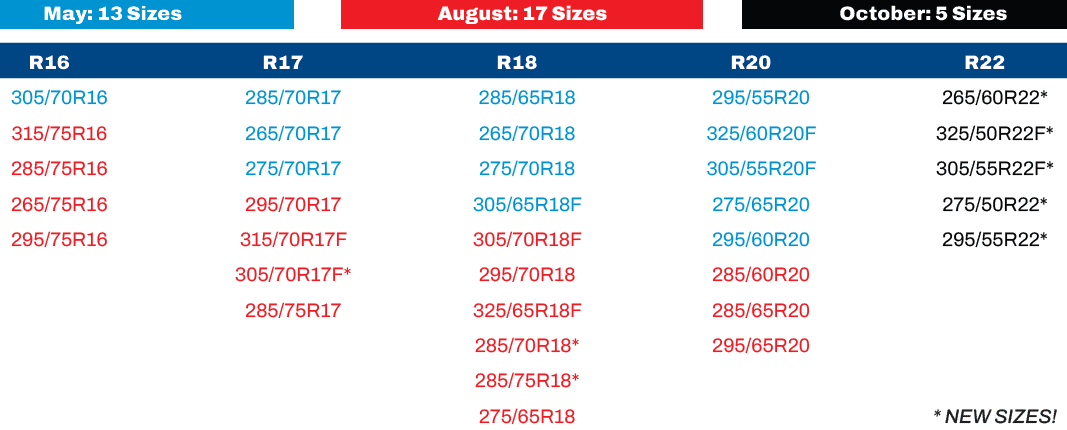

@Discount Tire, according to the release date chart that's been floating around the 37s will be 315/70R17F. From what I understand, that F says they're run flats. Seriously? Wouldn't that have significant implications for how their sidewalls flex when aired down?

The F designation means that the tire is a Load Range F. BF Goodrich (and others) are designing the tires that way to accommodate the load carrying capacity of the new generation of light trucks that are coming to market.

Does a load range F imply an incredibly stiff sidewall? Those have a max PSI of 95!?!
Any idea if they're planning on releasing 37s that are marked as 37s?

It does imply a stiffer sidewall. Remember, it's a 12 ply rated tire. There are not 12 actual plies. It may be stiffer, but a reinforced sidewall and other components will help with puncture resistance in off road scenarios.
BF Goodrich will be releasing the LT 37X12.50R 17 KO 3 in May of 2026. The spec sheet shows it measuring out at 36.5" OD.
