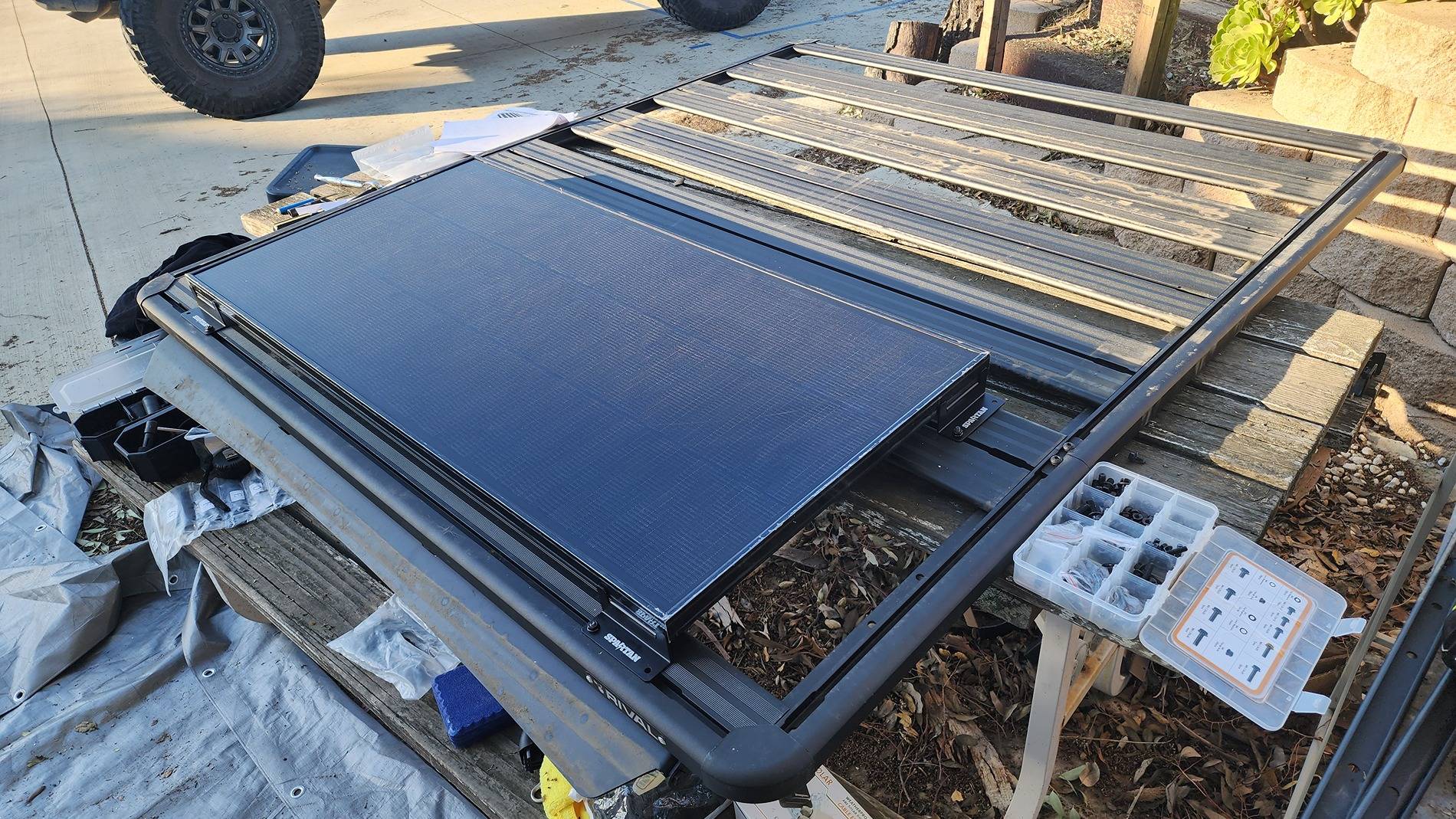

I've never kept my fridge (alpicool 35qt) in the back seat, but it is a taller design, which I liked, if fits long way in the cargo and the rear door can close on it.
As for powering, I have a roofrack mounted 120w panel, powering an ecoflow delta 2 (1024wh). If its sunny, I'll have continous fridge for months, even with the freezer on.
I do plan on the delta 2 max (2048wh) because I want to start trying electric cooking, instead of propane. Also, ecoflow sells a cable that connects to the jeeps battery, so its always charging the ecoflow, without worrying about your jeep battery.
For now, my ecoflow is not connected to any of my jeeps electrical.

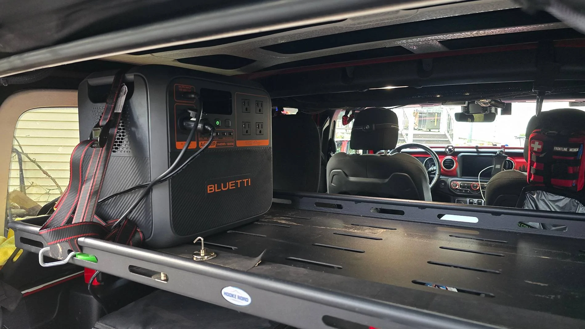

So an update. I've now permanently mounted the Iceco JP40 and slide to the Goose Gear plate system, and I spent the money I would have used to upgrade the fridge to upgrade power to a Bluetti AC180P instead, and a Bluetti 1 DC-DC charger. The weakest link is there is no app for the fridge, and thus no way to know or be audibly alerted if the fridge loses temp or goes above 40°.
EDIT: Now that it arrived, the Bluetti is FAR too big to fit on the back shelf of the Jeep. I can no longer see out the back window, and that is 100% out of the question for me. I know some people stuff that shelf with gear but I can't drive like that. And with a Trasharoo in place for trips I don't have access to the rear camera either.
Guys, I seriously need help here. It shouldn't be all that hard to keep a fridge powered 24/7 in a modern vehicle but everything I try has a show-stopper problem that I don't have the knowledge or experience to overcome.
My goal is simple: I only want to power the fridge, and nothing else, but it needs to stay alive and at temp without having to plug the Jeep in at home, as I don't have a way to do that easily without disrupting everything on our driveway and deck. I'll do it once a week or before a long road trip, but any more than that and it's just a pain for the family. This is now my number one priority, and cost isn't really a big issue (to a point). I'll gladly throw money at this until it's solved. I can't believe anything this simple is really this hard!
You might try an extra RV/boat deep cycle battery in a trolling motor carry case, that will get you a day at least.
I'm not understanding how you think you can keep a cooler cold just drivng jeep around? Do you have solar panels on roof? MY RV has 3 big ones and it was good for 3 days.
I'm just not sure what the best way of doing it is, but the end result is I'd like to find a no-maintenance or low-maintenance way of just keeping the cooler running, regardless if I'm driving the Jeep or it's sitting in one spot for 3 or 4 days, or just being daily-driven around town.
Some combination of solar, a power station, an alternator charger and???, along with how/where to mount them. I have a Goose Gear plate system and 60% rear delete and a Hooke Road shelf, and at the moment, I have the Charger 1 from Bluetti but I haven't decided whether it's the right device for me or not.
This is how it looks inside as of today:

Maybe try putting the Bluetti on the right side of the cargo rack. At least the blocked view is of the side of the road.
The cable they provide is far too short for that, although if I can procure a longer one of sufficient wire gauge that would possibly be an option. I will have to try it out in a dry run.
