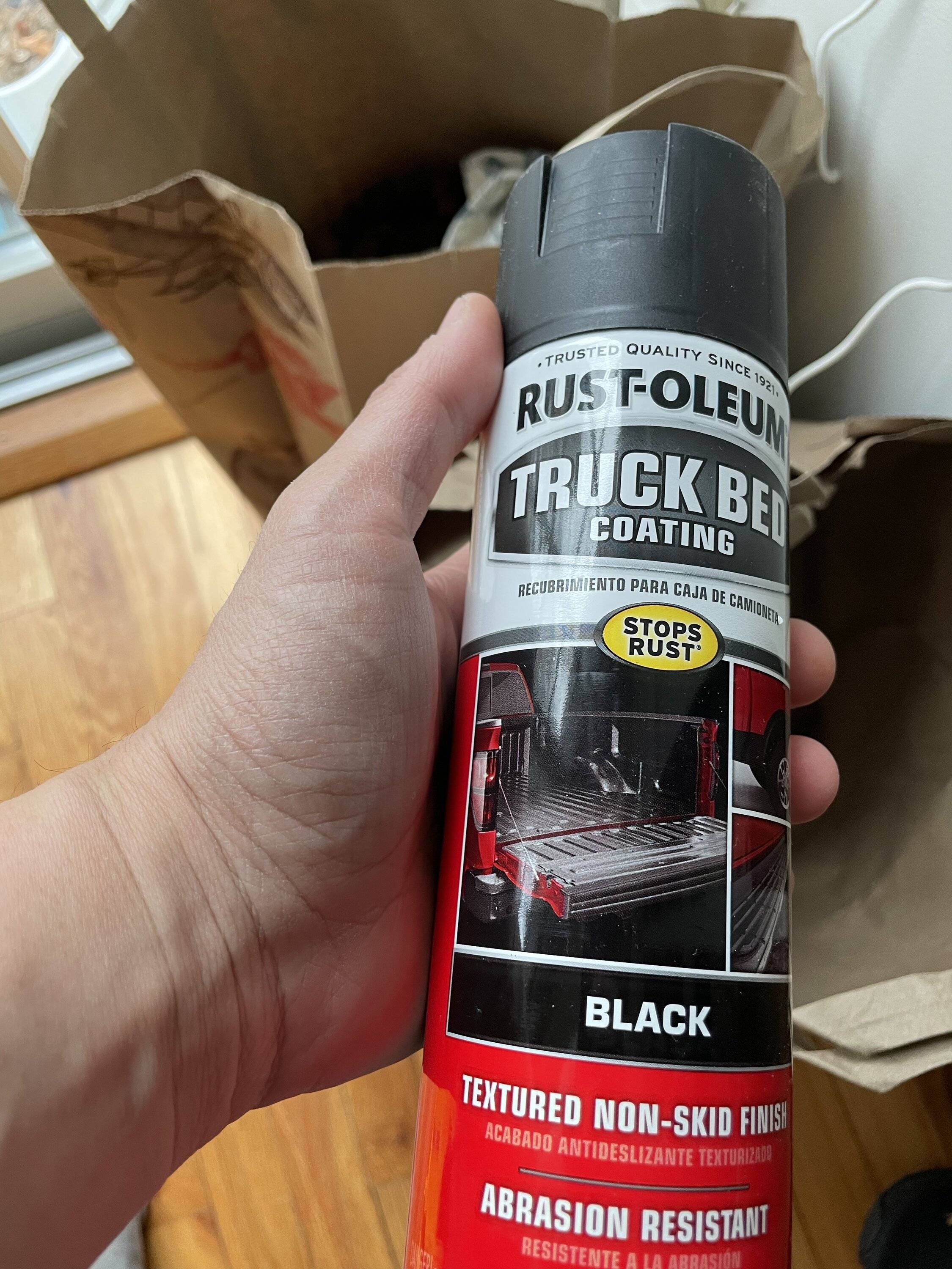

I’ve used this on bumpers
Used this in my Ace Engineering rock rails (had rust in several weld areas).. went through this winter ... still look great. Gives a slight texture for better grip with shoes etc... happy with results so far
I thought about rolling it on instead of the spray can. Over spray could be an issue if touching them up while still mounted on the Jeep.
