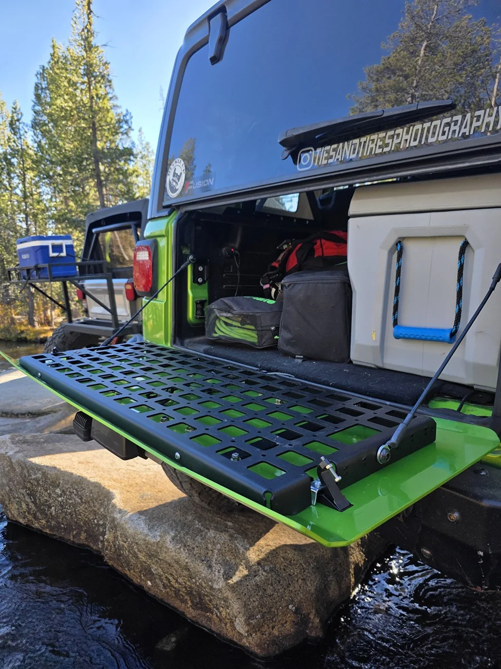

Went with the AAL table with cutout for the Renogy Battery Monitor.
No rattles and looks awesome. Only downside is the price and the freight i needed to pay to bring it to Singapore....

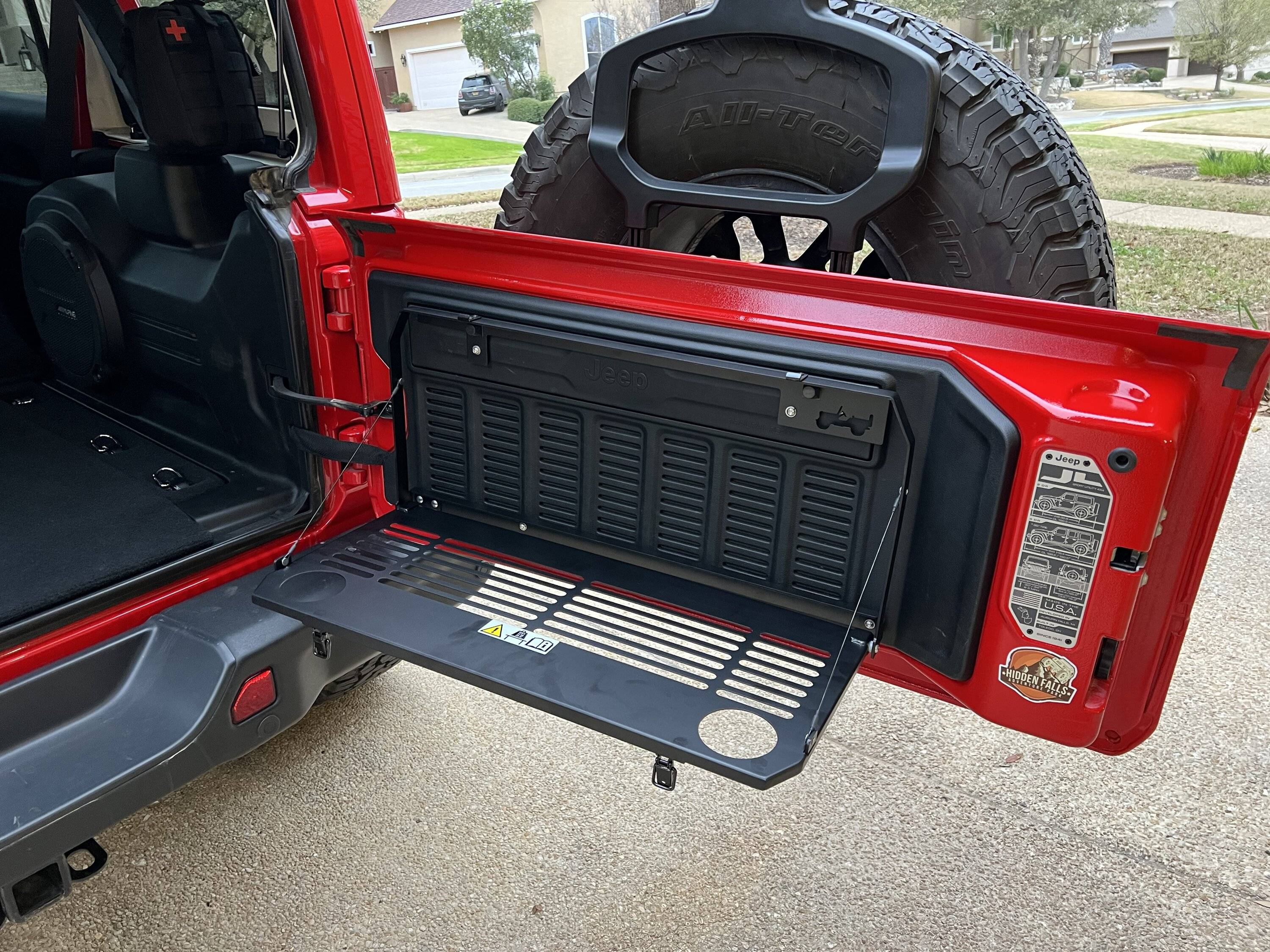

Just installed the mopar table. Disappointed it’s rattling. Need to find some bigger rubber bumper pads. For now I just wedged in some cardboard from the box when it’s closed.

Mine rattled when I first installed it, but I was able to get it fixed by just bending the tabs on top a little to tighten it all up.

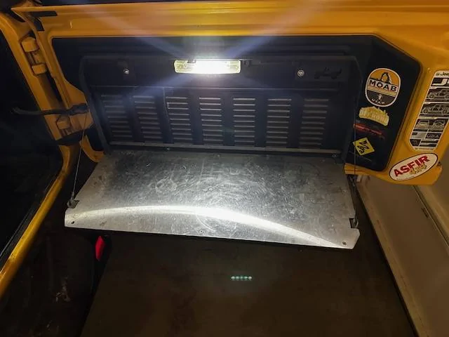

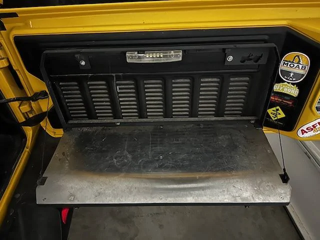

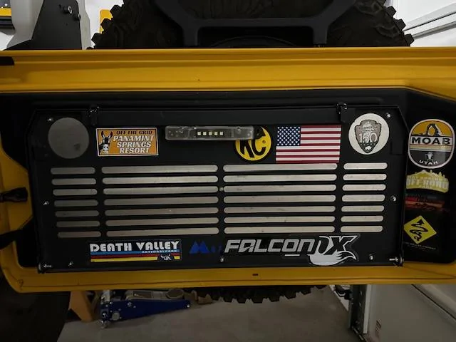

4 years ago I bought the cheapest one on Amazon at the time. Identical in every way to the Mopar unit with the exception on crap hardware mainly the washers which were actually O-rings. I fortunately have access to material and talented people at work. I added UHMW washers to the hinges and a buddy surfaced the table with food grade stainless steel. I keep a cheapo battery powered light on it with neodymium magnets.
It has been rattle free and useful.
(I need to clean it).

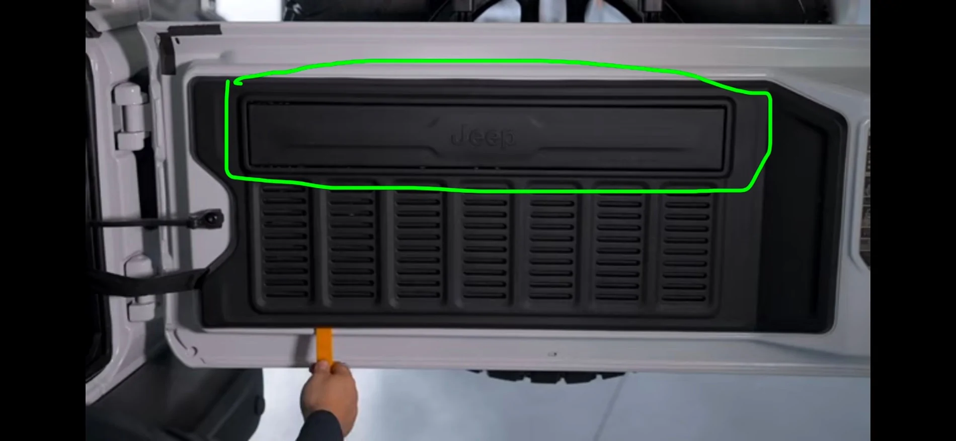

Are the installation instructions available to download before purchase? Is there a detailed installation video available?
Just spitballing here as I don’t have that table, but I have installed a couple other tables.
Pop out this panel.
Jeep Wrangler JL Best JL Tailgate Table Recommendations 1768150674956-2m
It exposes three screw holes:
Jeep Wrangler JL Best JL Tailgate Table Recommendations 1768150414025-kj
Screw the table in.
Note: you just need to remove that rectangular panel not the entire form-fitted trim panel. It covers up three existing, threaded holes.
