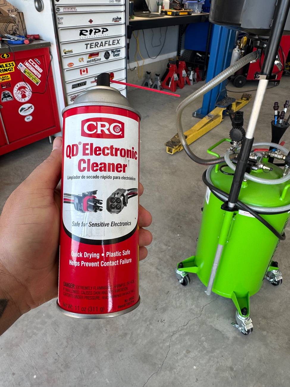

Shawn and Terry, thank you. Shawn, what/where is “the small bulkhead feedthrough?”
Ignore the missing breather tube

and add some dielectric grease before putting the connectors together.
Edit: when I first pulled that connector out, both sides of the connector was filled with oil. Since then, I have changed that feedthrough connector as well.
If you'd like, yeah. It's mostly used for corrosion in moist environments. The factory puts some on that connector and the one for the locker position sensor but it doesn't really help with the hot oil intrusion. It's supposed to be waterproof since it's silicon based, but that hot gear oil still gets through to the inside of the connector.
