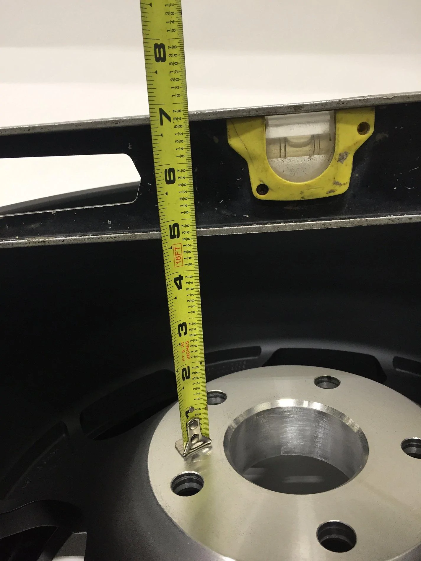

Dang it, typed out the wrong measurement in my post above. The backspace on the KMC XD231s measured out 4-5/8", not 3-5/8".
Above post is edited, here's a pic for clarity.
Jeep Wrangler JL Beadlock Wheels Measurement

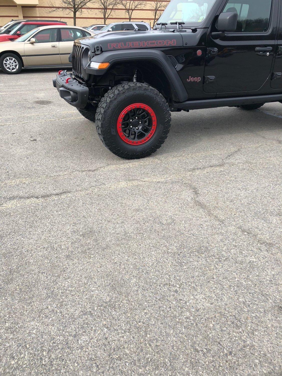

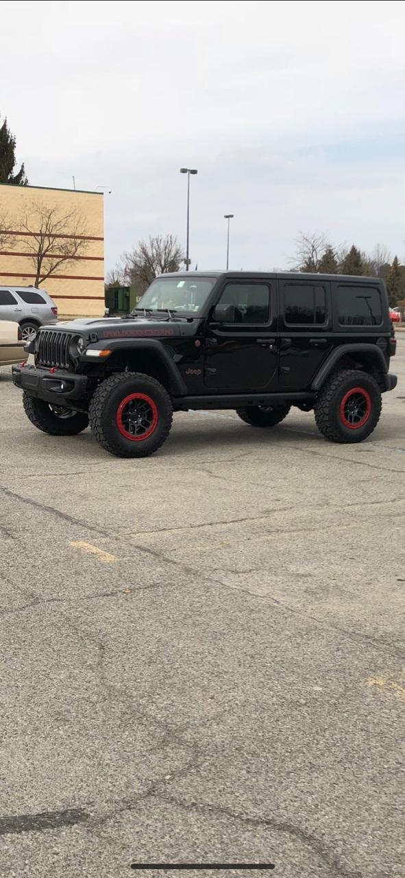

No rubbing whatsoever! LOVE the bead locks, and it looks even better in person.
Jeep Wrangler JL Beadlock Wheels beadlock1
Jeep Wrangler JL Beadlock Wheels beadlock2
Jeep Wrangler JL Beadlock Wheels beadlock3
