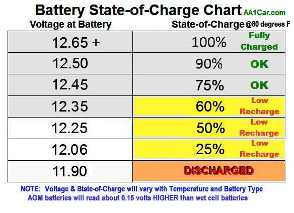

I was around 11.8V for a while and my start stop wouldn't work anymore because of it. Not sure how it kept starting when it was that low but it did. Got the Noco hooked up for a few hours and it's back to 12.5 or above now. Start stop works great. Same thing as you. I stopped driving to work every day so I assume that's why.
Thanks for the information and chart, I saved it for future reference.
