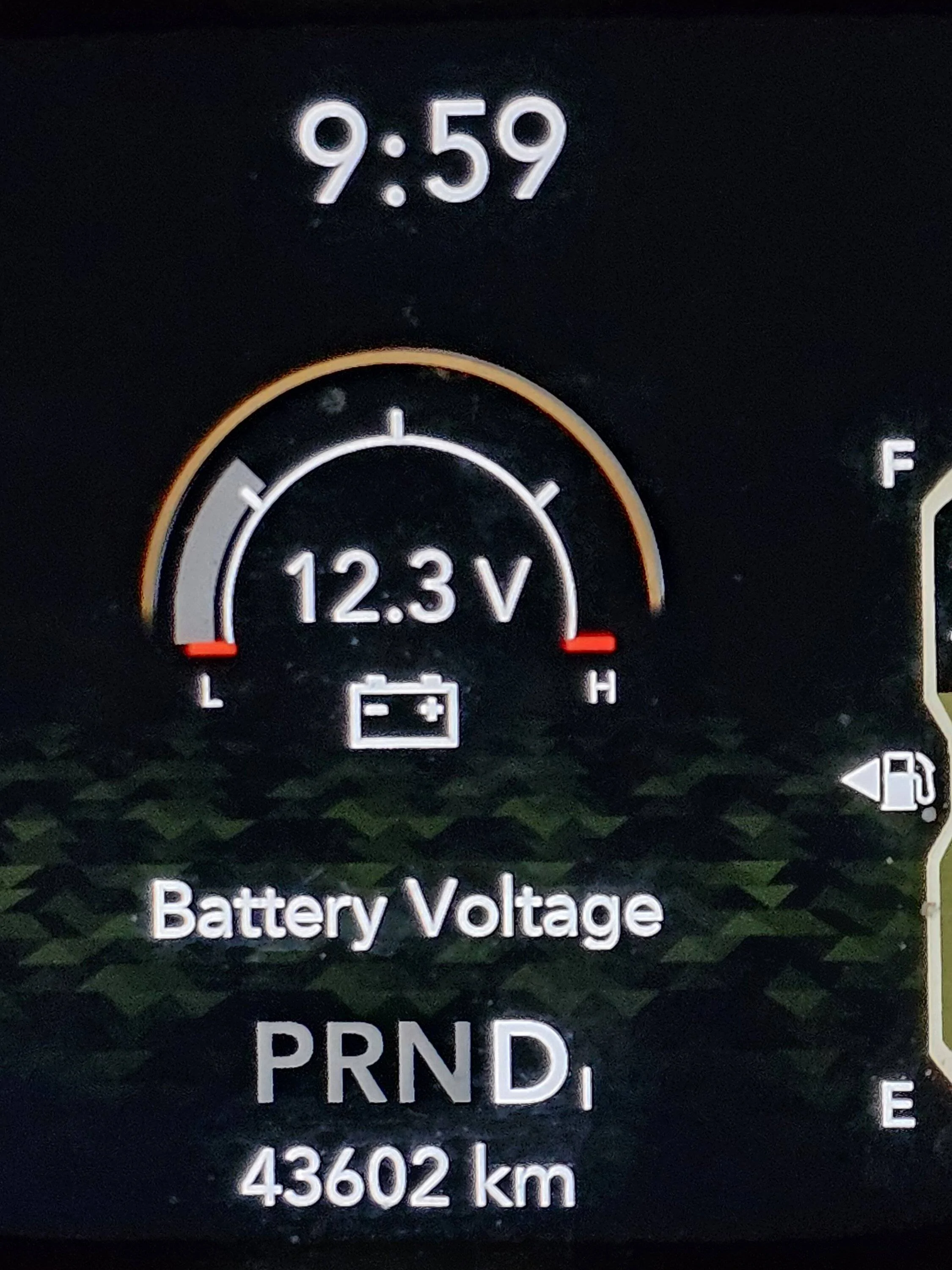

I am wondering what other owners of a 3.6 Ess with aux battery gauge indicates when auto start is engaged and engine is off

That’s about right, it will restart if it goes much below that.

Working as expected. Perfectly normal.

Thanks, this is what it is when it starts.

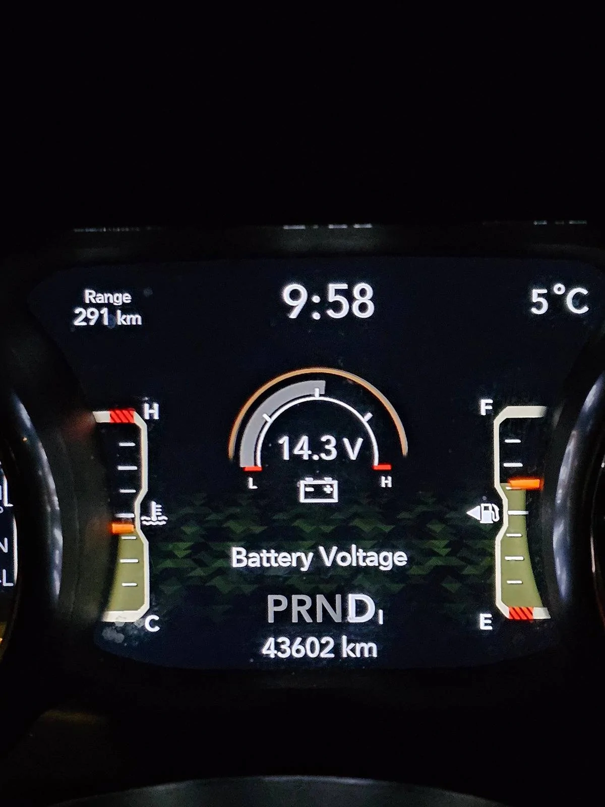

That's what the voltage is when your alternator is fully operating and charging the batteries, which is to be expected after a start. The batteries never put out 14+v. A new fully charged battery will be 12.7-13v. An old battery on its last legs may only go up to 12.4v when fully charged.
ESS will restart the engine if it dips below 11.9v.

I’ve never seen mine dip that low, it always restarts at 12.2.

The vehicle voltmeter show voltage under load. Unloaded battery voltage would be higher.
In a stop/start event, the vehicle voltmeter shows aux battery voltage.
All other times the voltmeter shows the 2 batteries combined.
The stop/start system seems to get a little funky when actual battery voltages get near 12.4.
Gregj
Ummm…his voltmeter shows 12.3?
Battery voltage under load is not a particularly useful measurement unless the amperage is known and consistent. Would be nice if our Jeeps told us amps.

Depending on the load, I would say your battery will be soon good for replacement.
Also note charging voltage change with the battery temperature, here I have see as high as 14.8v charging in the winter time
Your good. Mine got down to 10.1 with engine off. Mine was done
