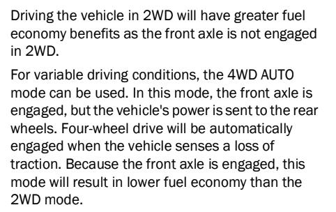

Yeah I didn't think it had much to do with 4A itself, cause at least from the other thread that was linked above, seems like there are others having this issue when in 4H. But was wondering what aspect of 4H that 4A also has but 2H doesn't, especially at idle...
Not saying it's the issue, I just figured the FAD was one of the main differences between 2H and 4A, as it would have to be engaged during 4A since you'd need to be able to power the front wheels. I don't think it does it dynamically in 4A after I saw this in the manual:
Jeep Wrangler JL Rough idle when 4H auto is engaged Screenshot 2022-12-18 at 6.39.30 PM
I should probably capture some screenshots of my tachometer for the eventual dealer visit. Maybe even a video if it could capture the "feel" of the increased idle.
