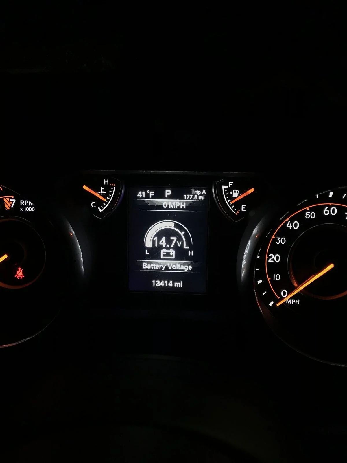

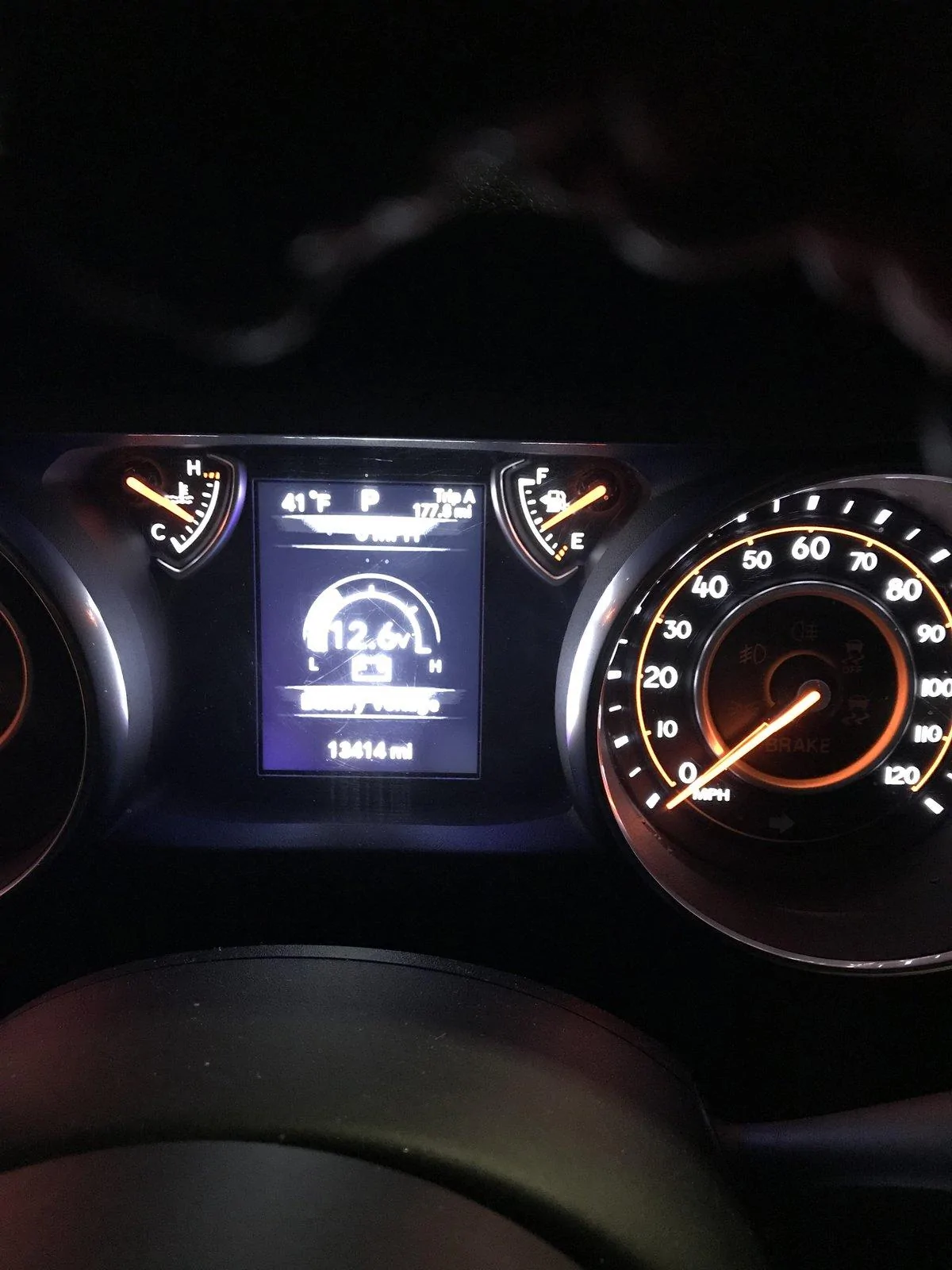

Does anyone elses voltage read this high with normal driving? I feel like my alternator is pumping out too much. And it never drops below this from start up to shut down. After turning off my battery voltage sits around 12.5. Should i get battery and alternator tested?

Mine has been running from 14.3 to 14.7. I’ve even had it in the battery tender.
Except for a brief period of about 3 days, mine has been reading that high for several months. The only thing it hurts is lower voltage is supposed to be better for battery life. When I asked the dealer, I was told 14.7 is OK, but above that should be looked at. Mine is now frequently 14.8, so I will be trying to get it into the dealer when convenient.

Alright at least im not alone lol. Im curious to know what they say when you do take it. I probably wont take mine till its either hard to start or it gets up to 14.8 like yours

This has been discussed in several posts and in short the voltage is supposed to float from 12.7-14.5 and it can display anything in between, when mine showed 14.5 all the time and ESS did not work as it said battery charging it was due to the main battery going bad but it never failed to start.
My current voltage usually runs 13.5 on startup then after driving for about and hour or so it drops to 12.8 and when I slow down by braking the voltage ramps up over 14 then back down to the 12.8, I very seldomly see above 14 unless I use ESS a lot which my Smart Stop/Start module keeps it off unless I choose to use it

In the 3.6L JL, the voltage you see on the odometer screen is best reviewed by pressing the start button twice on a resting jeep, with no foot on the pedal and then examining the voltage with no alternator running. Make sure to press the start button one more time to turn the vehicle off afterwards.
That voltage you see will be, unless you changed the factory wiring, a composite voltage of both batteries.
When the vehicle is on that reading will be those composite voltages along with the alternator; not very reliable.
To get the voltage of only the ESS/Aux battery, remove all cables from the negative post of the main battery and then check the reading when the vehicle is parked as per the procedure above. Make sure to put those cables back on the main battery's negative post when done.
To get the voltage of only the main battery, remove the negative cable on the main battery that is closer to the passenger's side of the vehicle. That is the cable that leads away from the negative post of the ESS/Aux battery. (The other cable is a body ground). Test voltage inside the vehicle and make sure to put that cable back on immediately afterwards.
