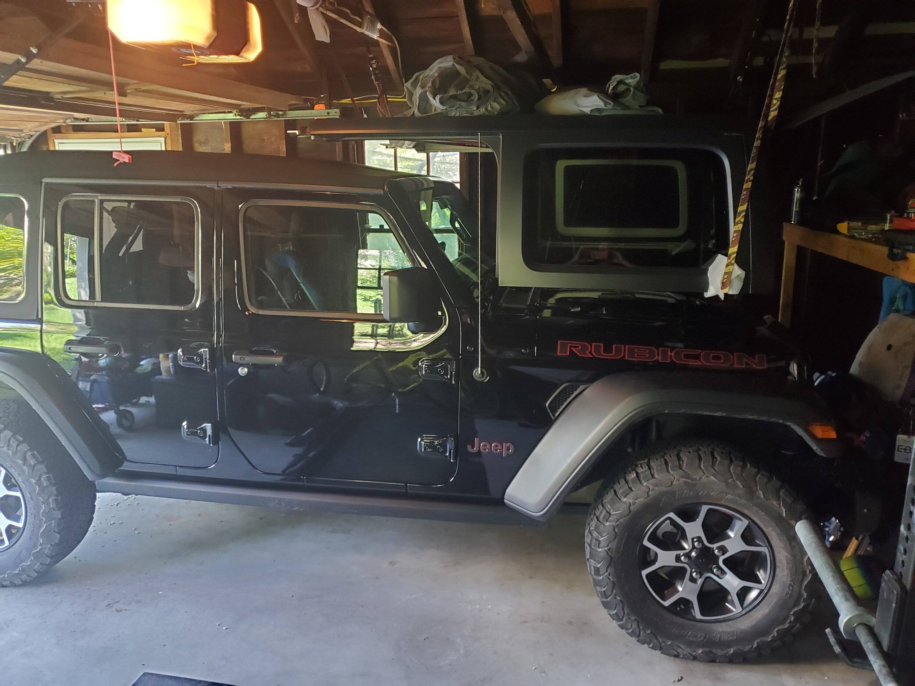

I spent about $50 at home depot for a couple of ratchet straps and eye bolts. works great and a space saver
Jeep Wrangler JL Basic garage floor hardtop storage options 20220806_101356
Looking at your soft top, I'm guessing you use this setup for an entire season. Have you noticed any warping issues with your hard top? I'd be a little concerned that the straps near the bottom of the windows would pull the hardtop out of shape over time.

No warping at all. If you zoom in you can see I have two straps going through the center underneath the whole hardtop for load distribution, those straps under the wo down are only for stability.
Pic of hardtop on for this winter season
Jeep Wrangler JL Basic garage floor hardtop storage options 20221013_123052
