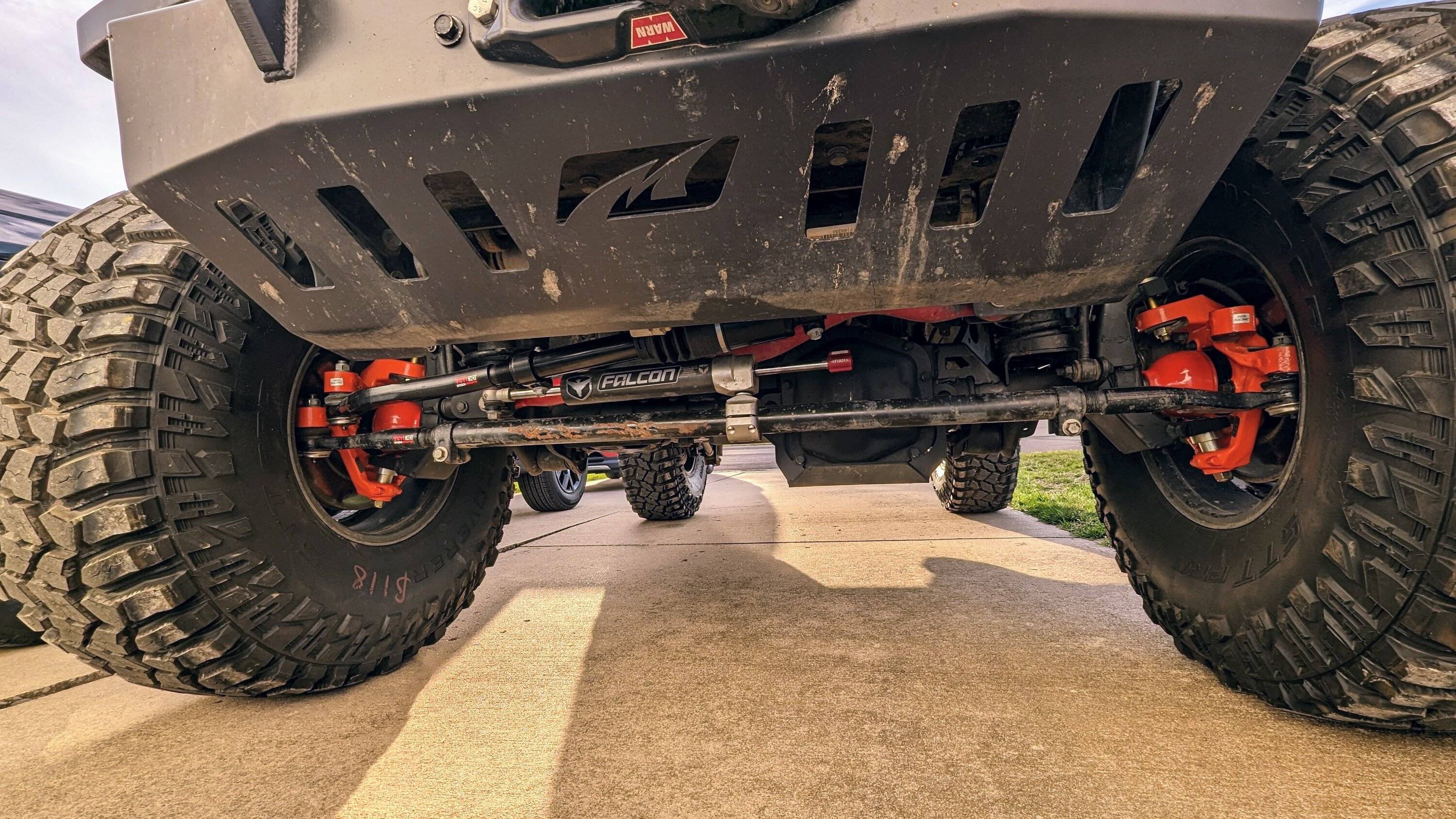

No noise, I've had it on the jeep a little over a month but it's not a DD so I've prob got 100 miles on it. Getting ready to do a 15 hour road trip early June so I'll find out quick. It's def a very stout well made product.

I just ordered the Reid knuckles and he didn’t know what I was talking about when I asked him about the u-joint covers you have. What are they and where do you get them
