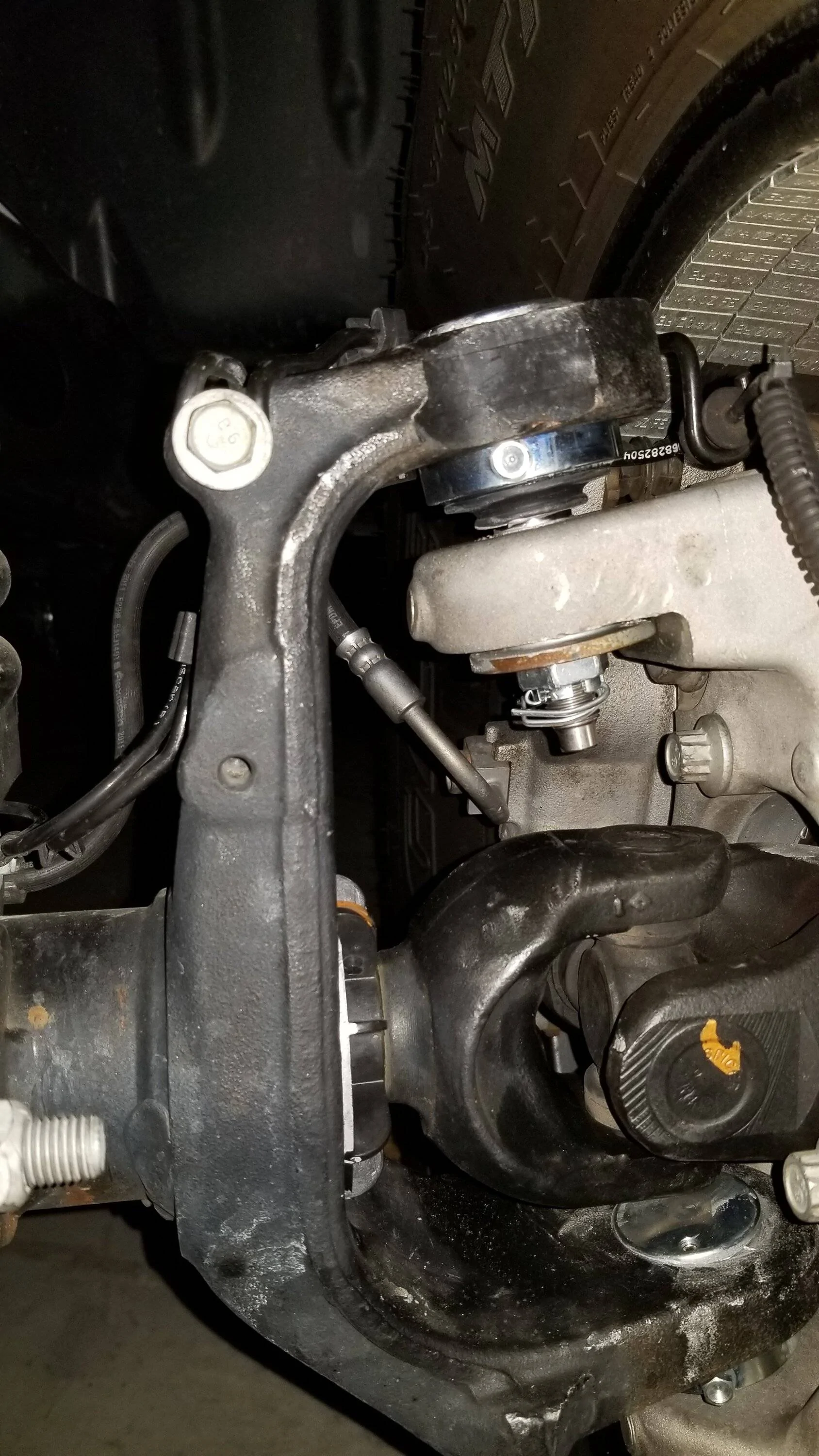

So I just completed my dynatrac ball joint install. 12k total miles, 7k on 37s. No death wobble but a slight shimmy around 50mph that balancing and rotating couldn't fix. Suspension was all tight and I have rusty's track bar brace with a rk track bar.
Turns out my lower passenger ball joint was bad. Really wiggly once out. Must have been weak from factory. Dynatracs totally fixed the shimmy and jeep feels tighter down the road. 2 great tips from other members: spray lots of wd40 the night before to help the knuckle come off, my ball joint stems were already rusting in place and were a bitch to break loose and put it in 4wd so you don't have to open up the axel disconnect cause the collar will hold everything in place while the axel is out.
Jeep Wrangler JL When to upgrade ball joints with 37s? 20221206_154158
