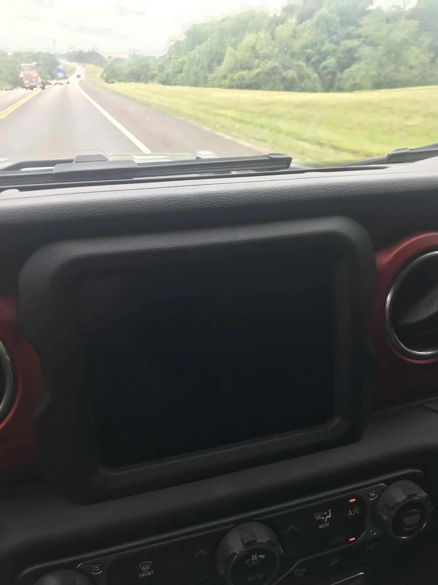

My backup camera is a blue screen and my radio was rebooting itself over and over and now the radio is completely black and nothing. $50,000 vehicle. Dealership does not know what it is.

I am going to ask my Jeep service department for their mechanic’s boom box and sit it in the passenger seat.
Over the air update is going to be released soon
