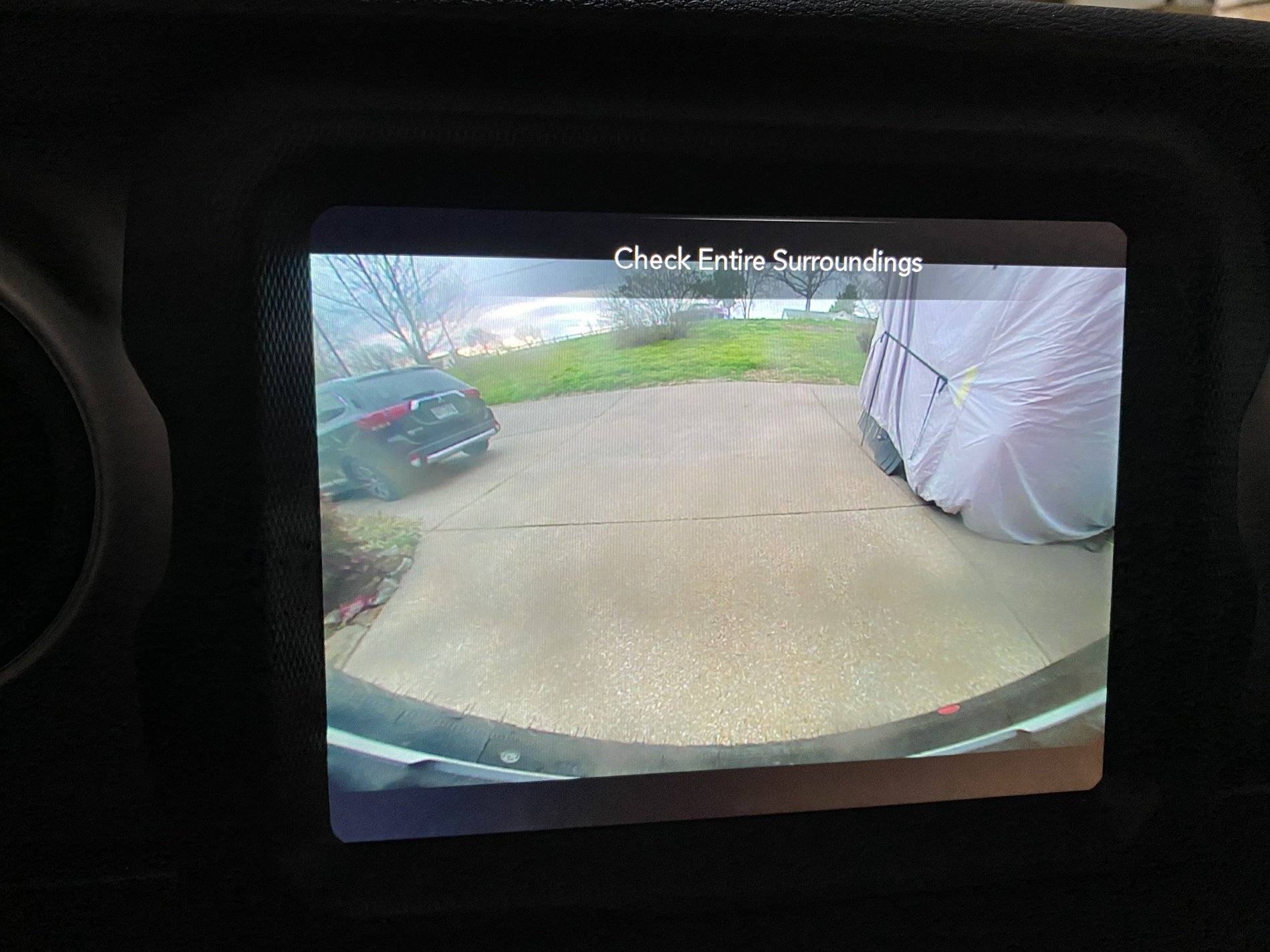

My back up camera view today. No software updates that I can find. Any thoughts?
Hi Jenninpb,
We very sorry that you are experiencing this. TSB 08-127-18 may help with this concern. It was published on 9/29/18 and it is supposed to remedy symptoms similar to what you are showing. I suggest speaking with your dealer to learn more about this TSB and to see if it applies to your vehicle. You may also send us a private message if you need any additional assistance!

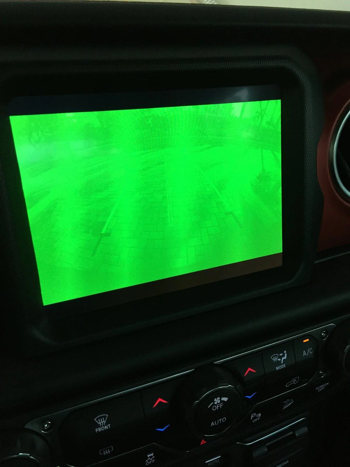

Well...seems I need that TSB fix for sure. At first the missing lines were just an infrequent annoyance. Now... with more regular frequency the camera just doesn't come on at all. And now the latest.....on startup during the "Accept" screen, I have icons all over the place ( last few seconds of video)
