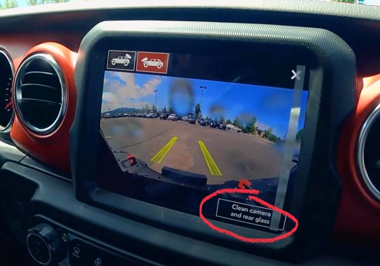

Perhaps I'm missing something out there, but I can not seem to find any list of which Wrangler models/years come with the back-up camera washer? Is that (great) stock feature tied to a certain package? Hoping someone has insight on this admittedly tiny (yet dope) feature.

Apparently so, which is completely awesome. I just can't find much info on which have that feature

Must be a new feature because it wasn't an option in 2019. Hard tops had rear window washer but not the back up cam.

Watch this dufus at 12:00 for a 2022 Rubicon Recon factory backup camera washer:
Or, there's the do it yourself approach:
https://www.jlwranglerforums.com/forum/threads/rear-view-camera-washer-nozzle-idea.127244/
And, it is apparently a stock feature of some Cherokee's also says the interwebs.
Seems like there must be specific models/packages that have it.
Unless I’m mistaken, that’s the front camera and the text refers to the front camera and rear glass not the rear camera. My 23 Rubicon XR with plenty of other unnecessary add ons doesn’t have a rear camera washer

The text of the button definitely implies it's for both cameras, but my rear camera doesn't have one. I assumed that was due to my modified (AEV) spare carrier.
Jeep Wrangler JL Back-up camera washer comes on which models? {filename}
That would kind of make sense, but it doesn't clear the rear glass.

You're right, that is the front camera view getting washed in the video, while it oddly says "Clean camera and rear glass". I've read other threads that mention the rear camera washer being synchronous with the rear-window wiper, which would make sense with the on-screen display.
Still, how can 1 tell which Wranglers have this feature? Is it 2022 on? Rubicons only? Recons specifically?

As far as I know no wrangler in the US had a rear camera washer if that’s what you’re asking.
OEM front camera option has the washer feature for the front camera
