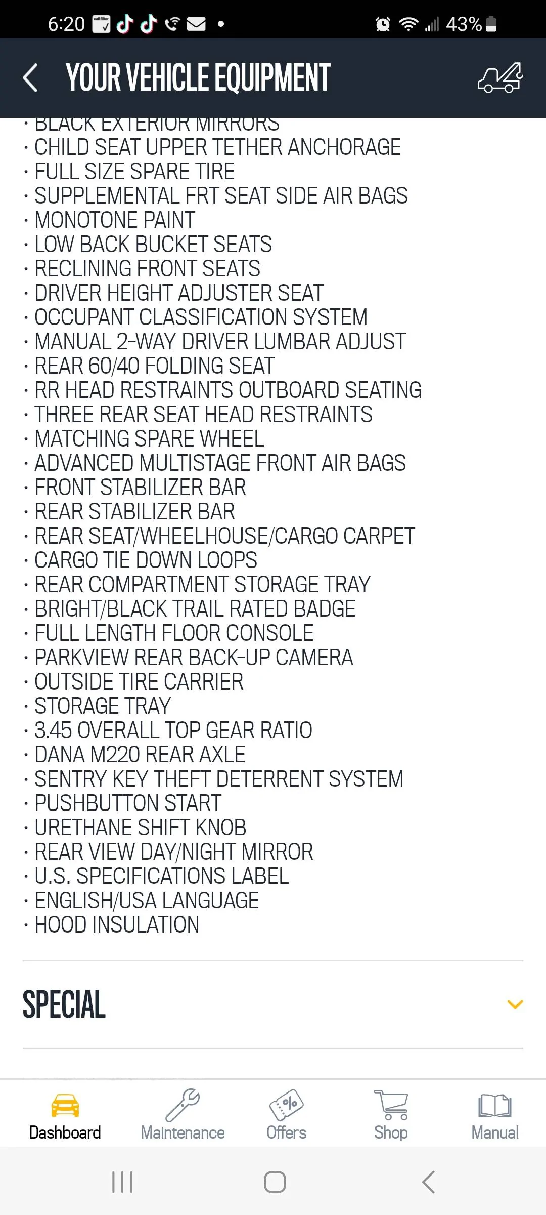

Been reading and doing alot of research on the rear in my 21 Jeep Wrangler Unlimited Spirt Islander. It is my understanding that it has the Dana 30/35 combination. Something I read stated that if it had the tow package that the rear was a Dana 44. This intrigued me so I checked my window sticker and don't see any mention of a Dana 44. However when I go to the myJeep app and look at equipment, it shows the Dana 44. I have attached a screen shot of that. When looking at the diff cover, it looks like a Dana 44. Am I correct to assume that I have the Dana 44 rear?

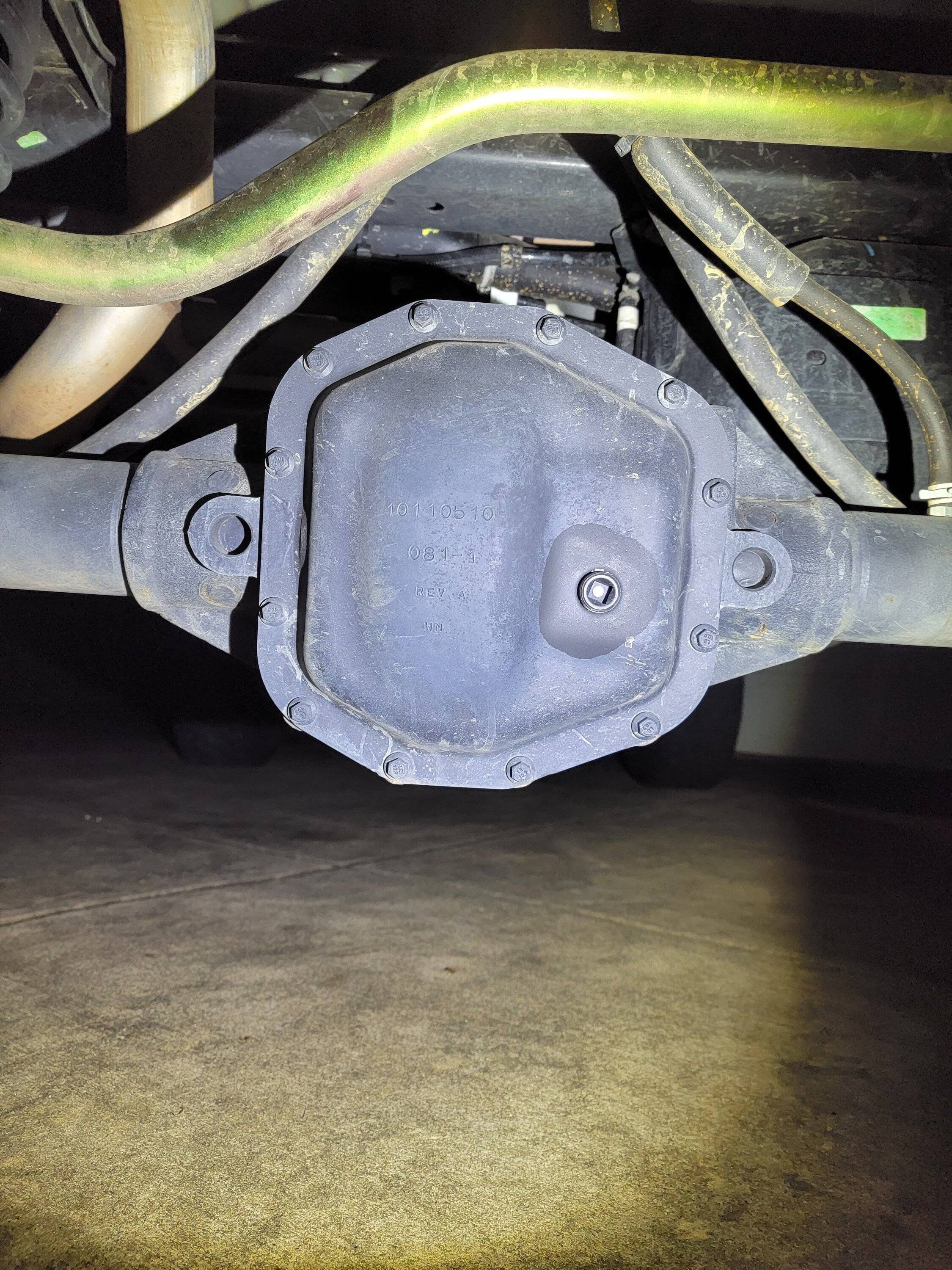

Post the diff cover pic.

Here is the diff cover
Sorry, should have read better. As others have said that’s the M220 (44) diff.
May want to flip the parking brake lines with the MC lift.
Thanks. I forgot to flip the cables when I installed the lift. Been meaning too but haven't had time lately with working on a few other projects. Thank you though.
