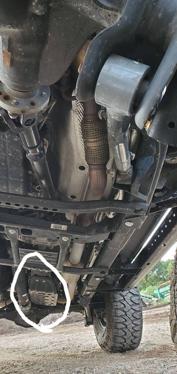

You or your local repair guy can take a quick look under the Jeep and know if you have a secondary etorque battery. Jeeps with the etorque battery still have the empty battery box in the passenger fender area that would otherwise hold a secondary 12 volt battery. From the factory you would have one of the two secondary batterys. The small auxiliary 12 volt battery in the fender area can be deleted.
Jeep Wrangler JL Auxiliary Battery?  Empty! IMG_2682
Jeep Wrangler JL Auxiliary Battery?  Empty! IMG_2681
