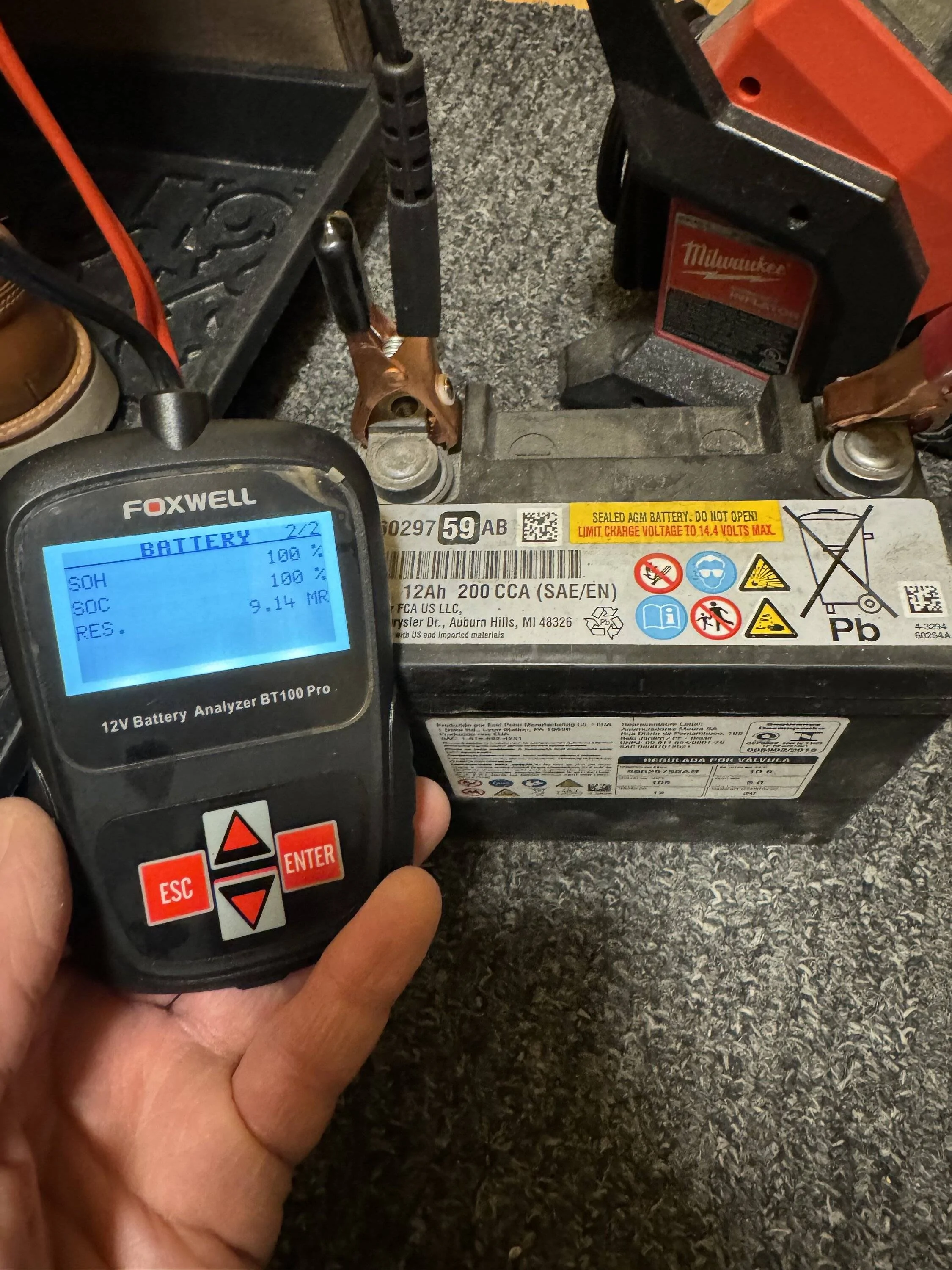

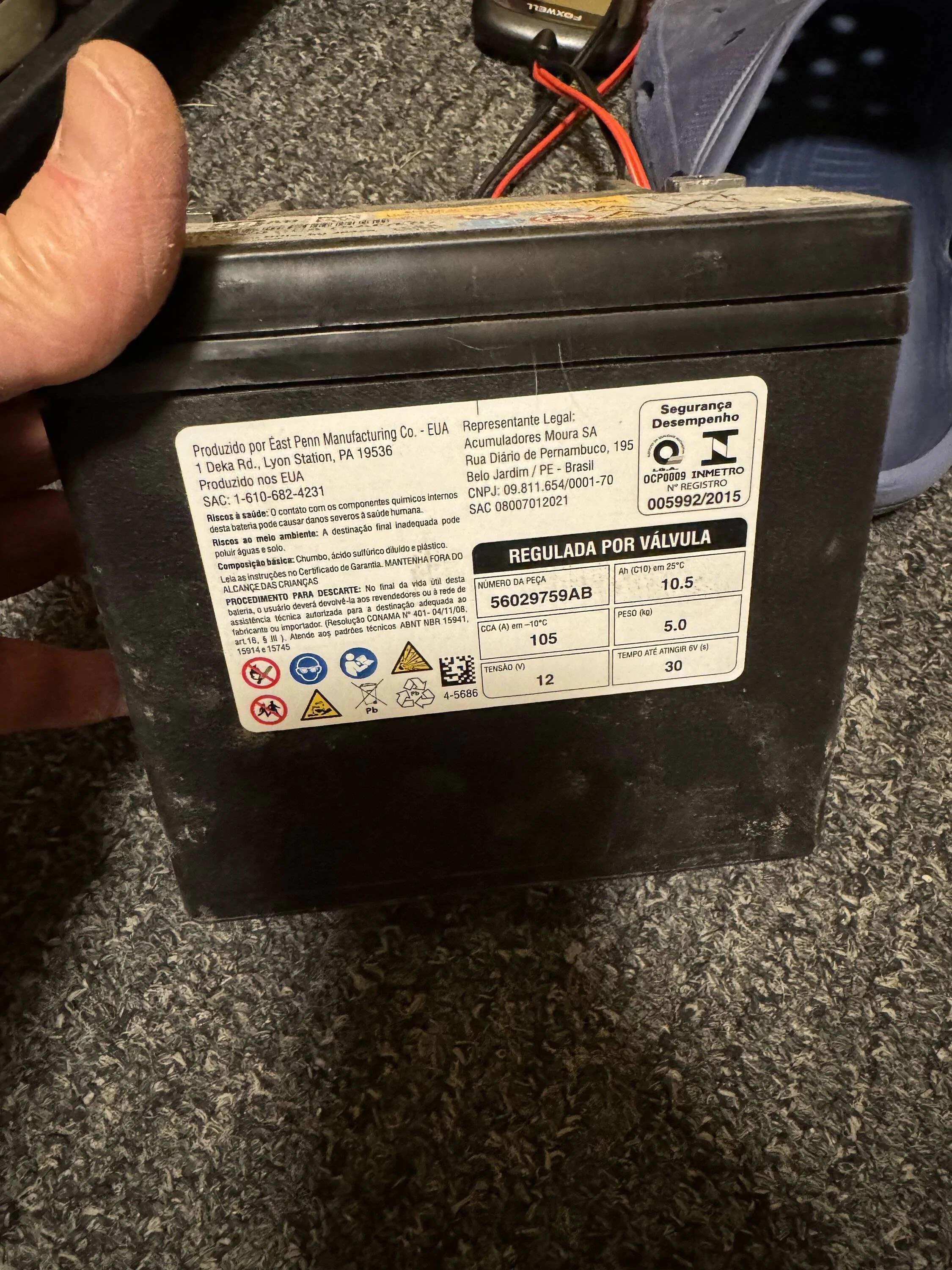

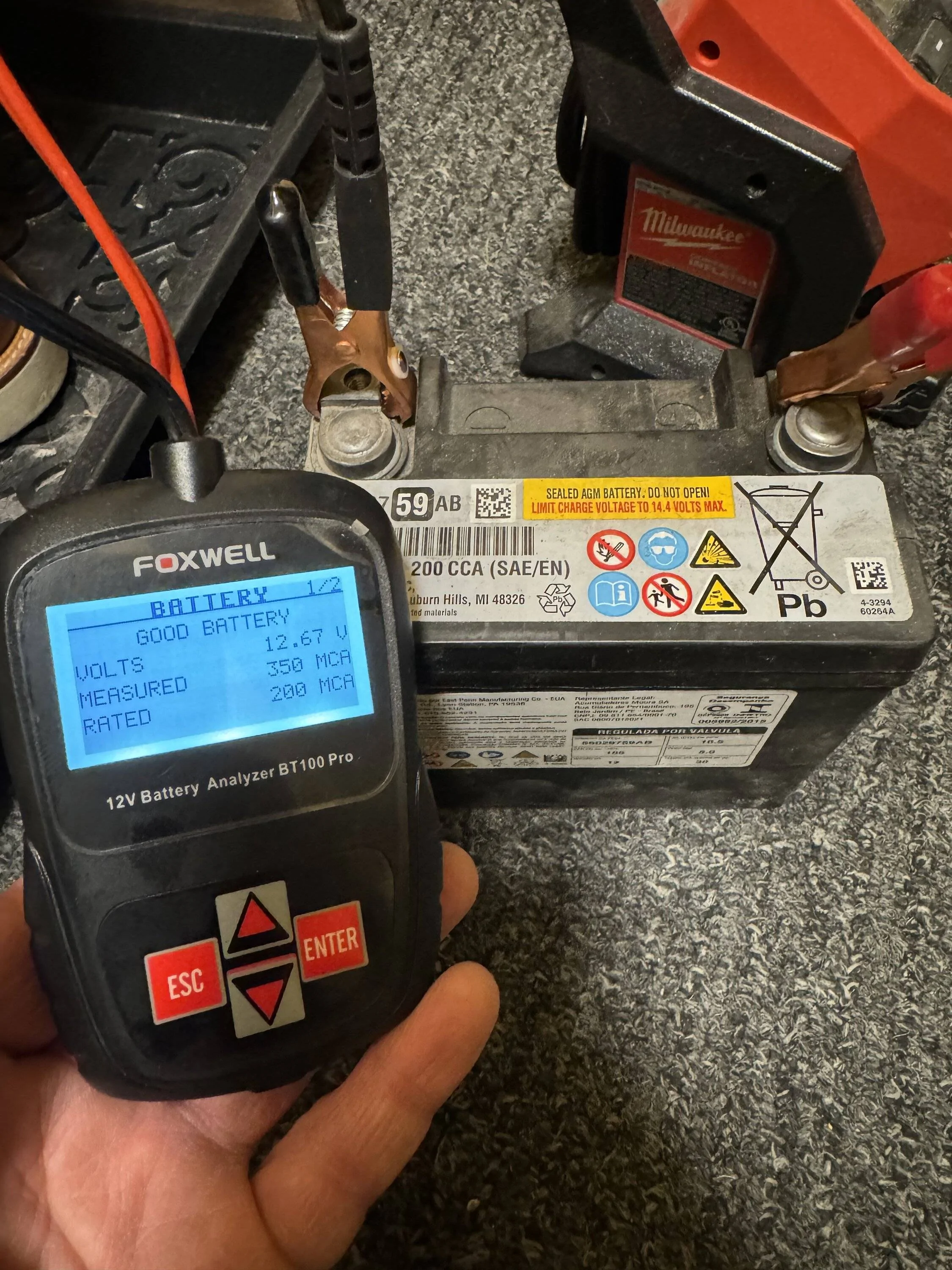

For all of you saying how bad the setup of the auxiliary for the ESS system 2nd battery is. I have something here to share with you. Here’s the auxiliary battery I replaced out of my 2020 Jeep Wrangler. Dated from 2019 production. The only reason I changed it out is because winter is coming and I don’t take chances after 4 years of use. I had no signs of battery issues at all. I changed it out because I always think of maintenance 1st over anything else. Here’s the results after removal from the test. A1 condition after few years use and 76k, can’t complain.?

Dang! $350+ (US) for a battery. ?
I’m not so much a price guy. If it works well and keeps it reliable. My motto is stick with good brands that are proven. Could care less about paying 100-200 more for quality products. Don’t get me wrong, if it’s going to leave me broke and couldn’t do it I’d make other decisions but otherwise, not doing it.
