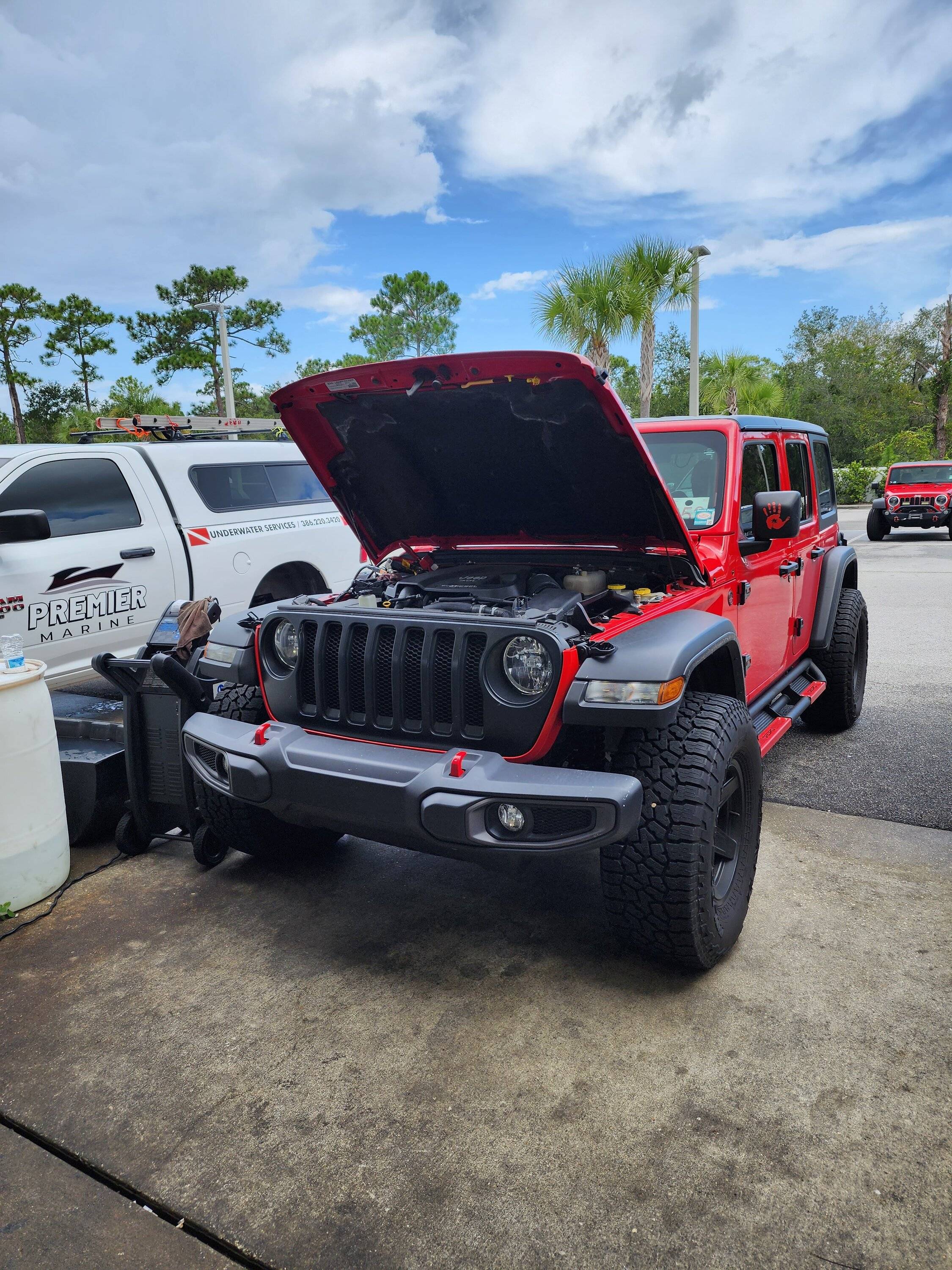

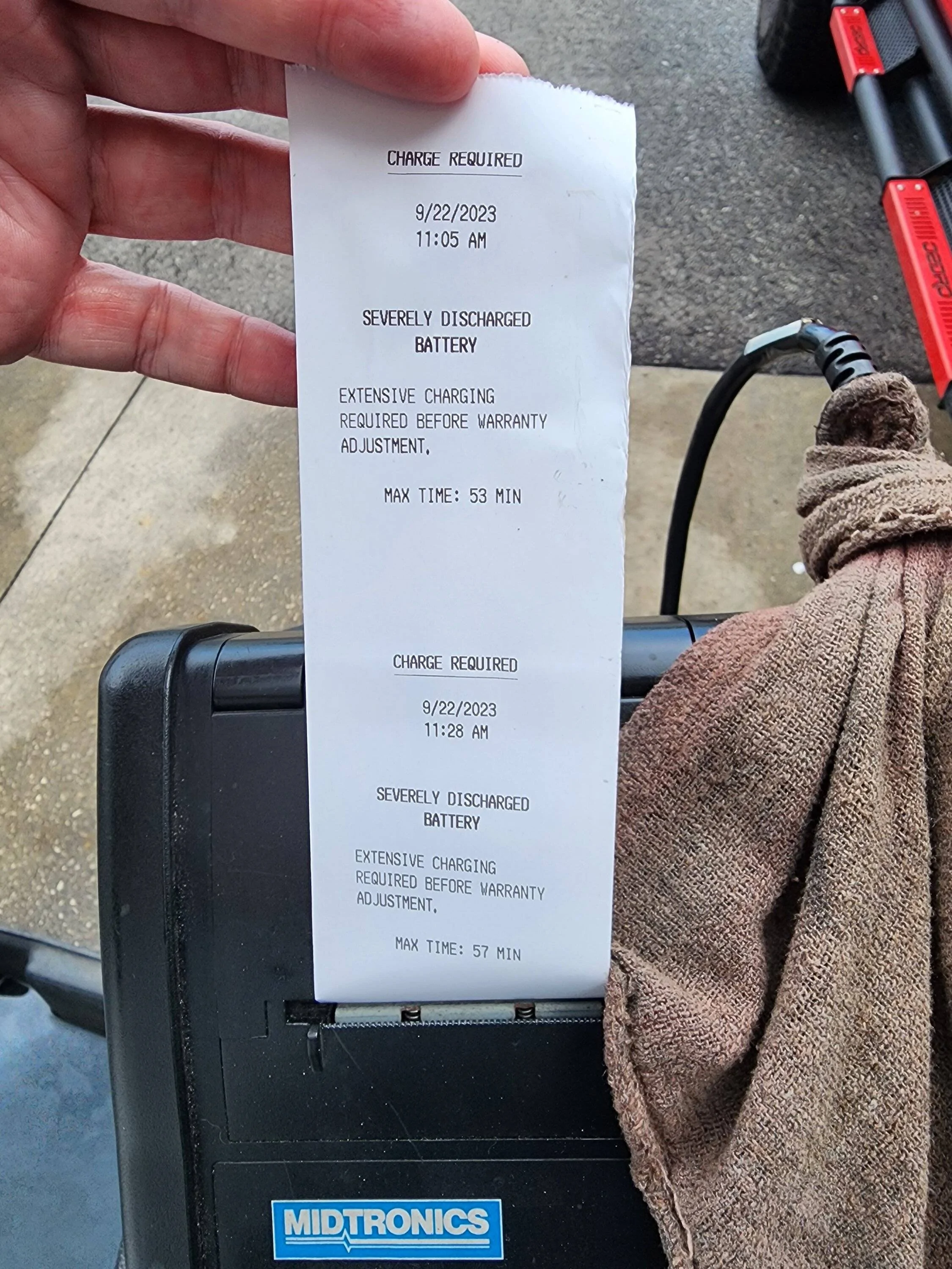

That's exactly what happened to me about 4-6 weeks agoPretty sure mine are going out, 29k miles.
I’ve got constant message of stop start not ready…battery charging.
I even get warnings about aux ports being temporarily unavailable because of battery charging.
read this means my aux is probably toast, and the main isn’t far behind.
dealer appt Monday. We’ll see if they’ll warrantee them since the jeep is less than 2 yrs old. I’ve got hinge bubbles and a non-retracting rear seatbelt that I’d like to warranty as well.
