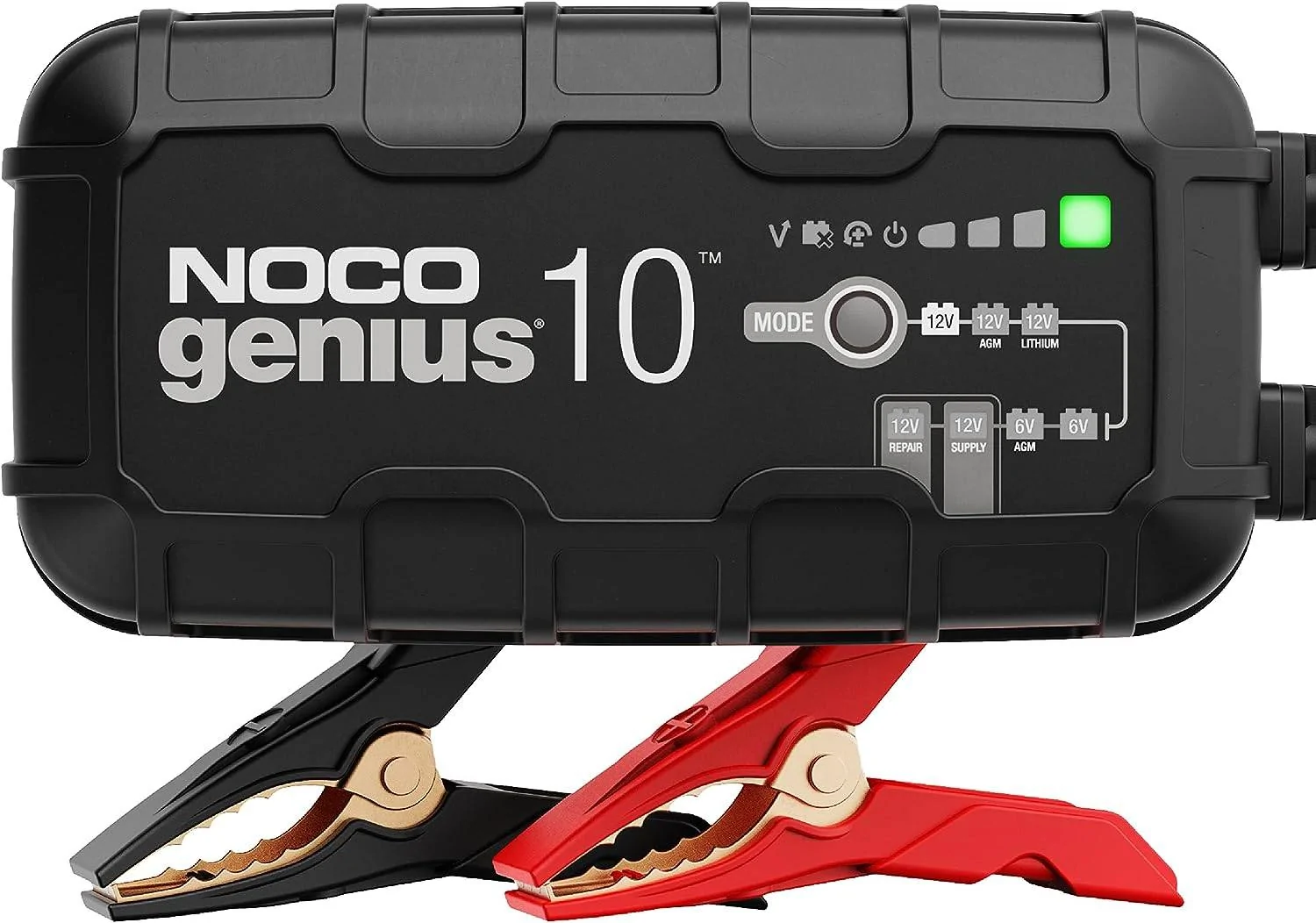

Also, @Rhinebeck01 thanks for the heads-up on the Amazon Cyber Monday deal. I just ordered the NOCO Genius 10. They said they'll even ship it today. So I hereby bequeath my EverStart Maxx to my wife's GMC Terrain. I can now charge both our vehicle's batteries at once. Woo-hoo...
An early Christmas present to myself. Happy Holidays.

For all that want a Noco 10 at a very good price ... it is on Cyber Monday sale right now for
$79.96. Usually sells for about $100.
Thanks for the link.
Just ordered one for my FL car that sits in the summer and is my DD in winter.
I pull the battery when I leave in late spring and this maintainer will be perfect to keep the battery healthy in storage.
