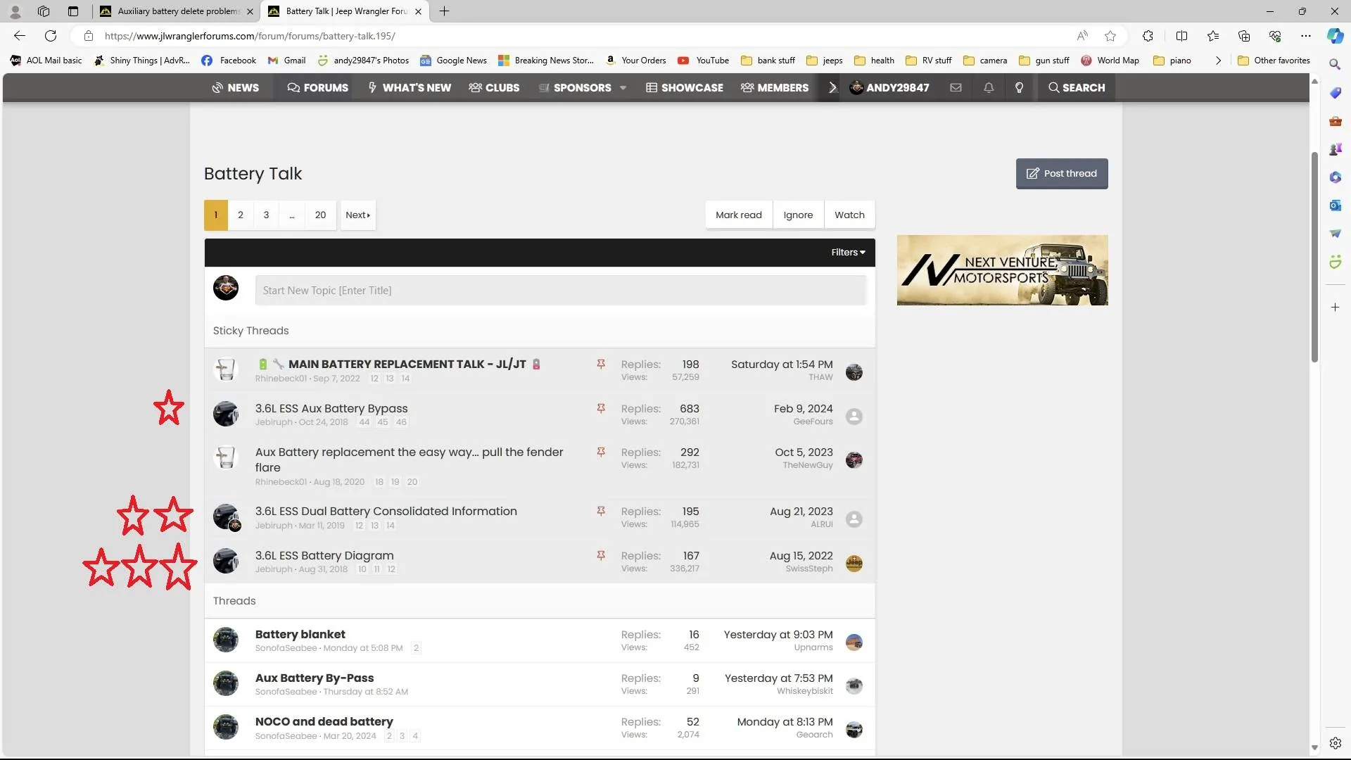

Sarge and others, there is a separate section in this forum just for battery talk. There are 5 threads pinned to the top of the section that you can see when you first open the section. The skinny about Jeep batteries is easily found in these pinned threads. The hard part, as illustrated in this thread, is figuring out the "right" when multiple members jump in with what they think/know/heard/experienced. I am satisfied that everyone means well, but there are a lot of things written that are not quite right.
Jerry, forum name Jebiruph, and Rhinebeck01 are excellent sources (guru status) of info about batteries and the Jeep electrical system.

Sarge and others, there is a separate section in this forum just for battery talk. There are 5 threads pinned to the top of the section that you can see when you first open the section. The skinny about Jeep batteries is easily found in these pinned threads. The hard part, as illustrated in this thread, is that when multiple members jump in with what they think/know/heard/experienced. I am satisfied that everyone means well, but there are a lot of things written that are not quite right.
