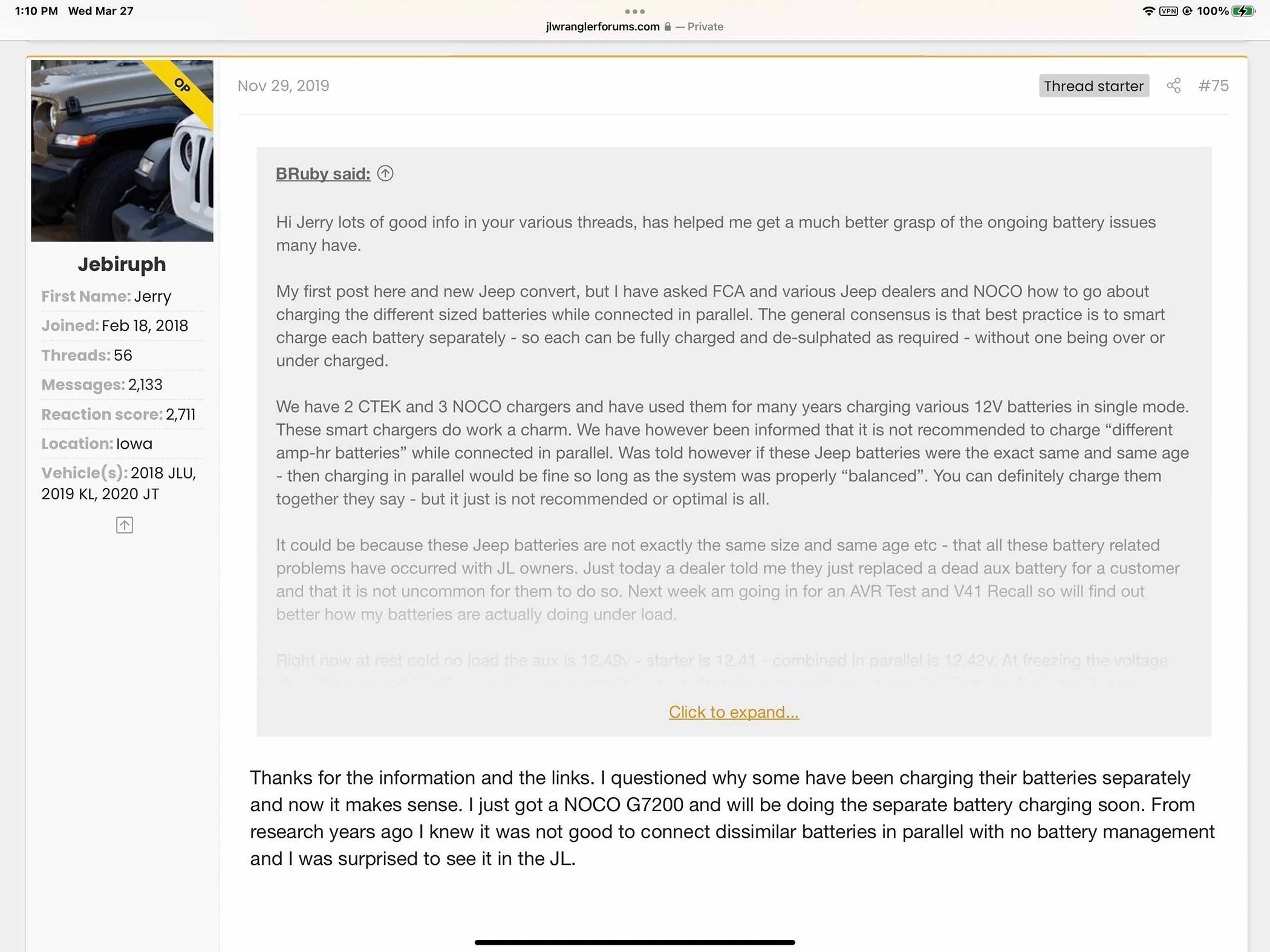

Yeah Jerry and I had discussion on this specific topic many years ago - way before any forum members joining in only 2023. This has been done and dusted long ago:
Not sure what your point is, but thank you for co-pioneering this and providing the information to the forum.
Now if you posted a thread on the best way to search through 1000's of threads and the results didn't come up with over 25 pages, with atleast 20 threads each to wade through... that would be an accomplishment. ?
