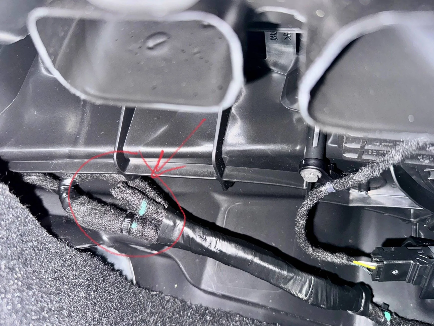

Can anyone post where the Aux wiring harness is in the cabin. I need the ignition on wire and I've seen passenger's footwell AND driver's footwell.

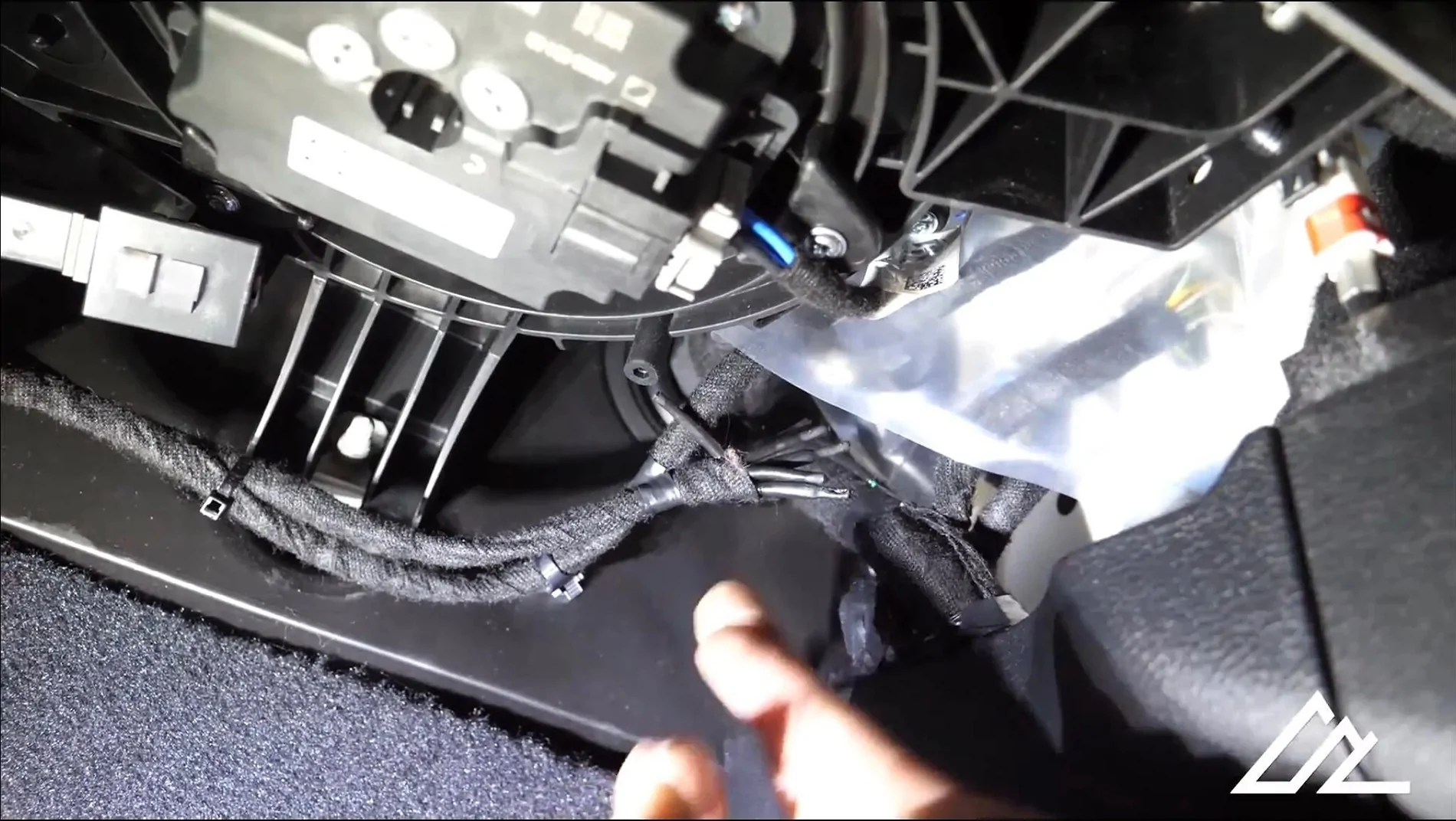

Passenger only. Carefully cut and unwrap the smooth vinyl tape shown in the pic above.

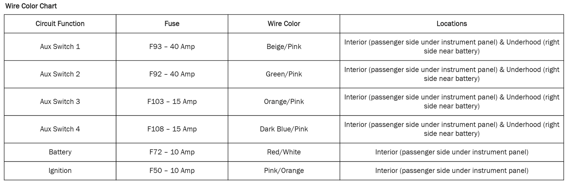

Related note: The Red/White constant 12v battery source is only 10A. I learned the hard way :)

What were you hooking up?
Tury Pro one-touch window up/down module.
I thought I was being clever by using the aux battery connection avoiding running the wire through the firewall direct to the battery.
The module needs 30A.
Oops.
I did hook up my old skool fog lights to AUX1 using the harness under the hood by the battery, easy-peasy.

My 2025 has 6 inside the cabin, 2 high amp aux, 2 low amp aux, 1 low amp switched from "key switch" and 1 low amp hot. It's recommended that if you use the two that not aux switched that you use a fuse. When I wired my GPS I put in a home made harness from the negative standoff to cover any additional wiring to inside.

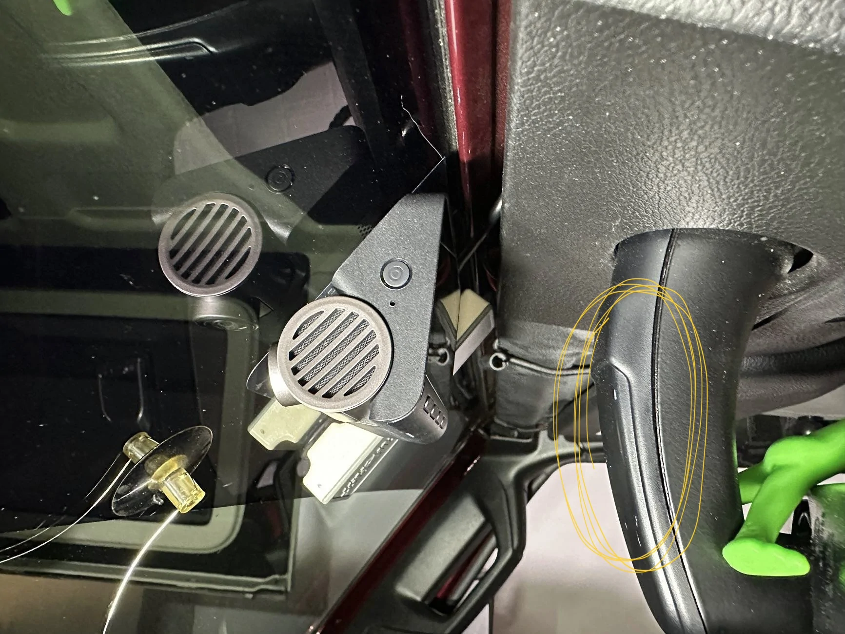

I am using a vantrue N2. I plan on tying it in to the "ignition on" aux wiring. I don't use always on because the Jeep is usually parked in my garage. Makes me wonder if I need a fuse though. The 12v to USB adapter is rated for 2 amps. I usually mount the dashcam's upper right, under the passenger's sun visor.

Great minds think alike:
I have those, that's what i was wiring to the 12v ignition lead. Where's the rear-view camera's power.
In the rear view mirror mount.
Just had to pry it open and tap into the correct pins.
