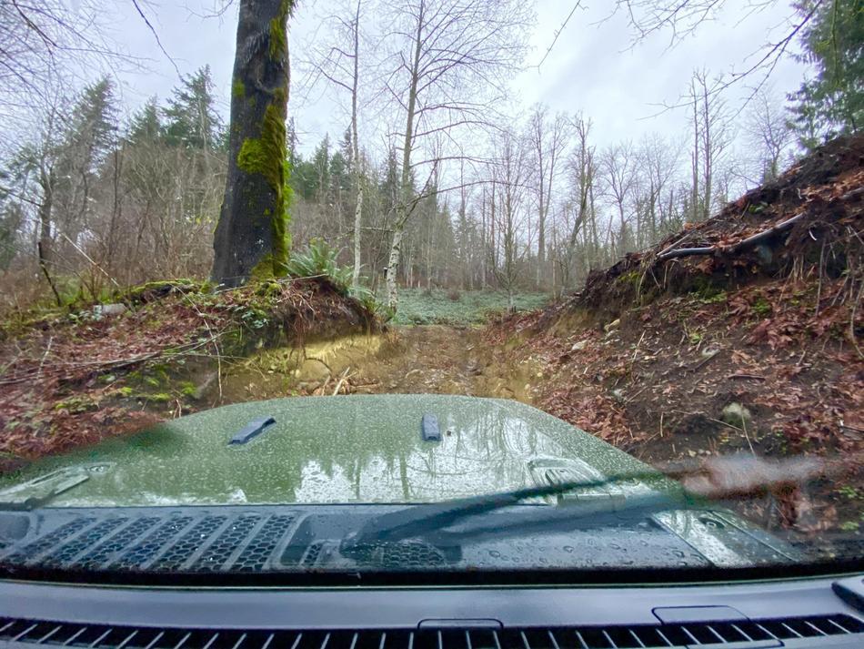

I got into a situation like that a while ago, I'm pretty sure it was the BLD that was cutting power and it really screwed me over. I was trying to climb up a steep muddy hill and the terrain was extremely sloppy and it was raining:
Jeep Wrangler JL Automatics cuts out on inclines lQE56TM
Every time we got close to getting over the top, the BLD would kick in trying to do its thing but that would cut power and slow our momentum at the worst time when the hill was at its steepest. This was in 4L which has traction and stability control disabled. I kept reversing down and coming back with more speed and right at the worst time it would feel like stability control was cutting power (but its really the BLD 'stability control') and kill the momentum when we needed it. Backing down the hill and trying more and more gas was to no avail, it kept killing the power right when I needed it even though I was applying steady throttle and you could hear the brakes crunching/modulating.
I had to stack stones and branches for a good hour to get up the mud hill, but I would of been able to make it if the Jeep wasn't cutting power when I needed it in the mud. This is definitely a situation that I would of benefited from having lockers. I know the photo doesn't look like much, but trust me it was steep and the mud was almost up to the frame. I'm pretty sure this isn't just an automatic issue since manual Jeeps have BLD, but mine is an auto so I can't say.
