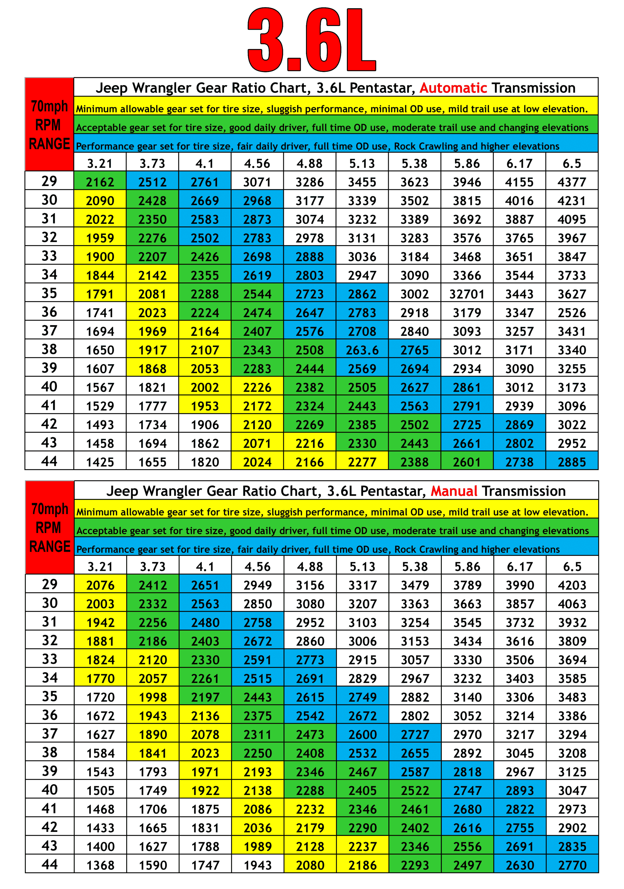

Yeah, Jeep's website configurators really suck. I probably would've spent a little extra for 4.88 gears, but honestly thought they weren't possible for a 2-door automatic.
Sounds like I may be in luck since 35s or 37s would be in the near future after receiving the Jeep. This would save me money up front by having the 4.88s off the bat.
For a 2-door, I don't plan on going any taller than 34 or 35", so I should still be okay with 4.10 gears if this chart is correct..
If i was factory ordering anything, I’d personally chose the lowest set (highest numeric) unless I was particularly concerned with mpg.

Yeah agree, but I'm already in production, so too late for that. Not overly concerned with MPG, but with a noticeable loss of performance. 34-35" on 4.10 should be fine, I think.

Other than worse mpg, would 4.88 on the stock 33s out any excessive wear on the engine? Still kind trying to wrap my head around gearing and how it affects everything. I’ve always just understood it as higher numerical is better for bigger tires.
Would 4.88 with 33s accelerate faster from a stop?
