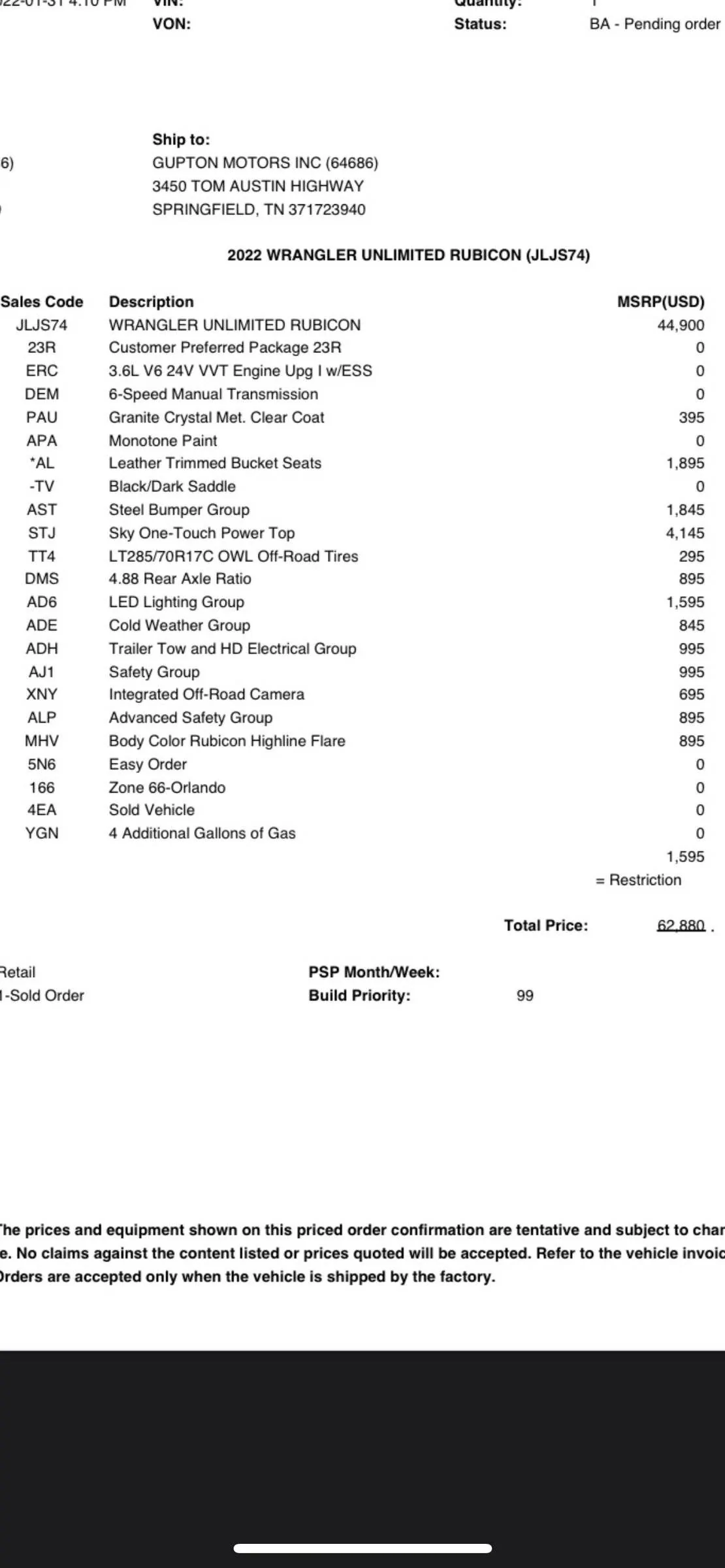

Have any of y’all received y’all’s builds yet? Wondering how well the 4.88s do on the stock tire… just ordered A 2022 Rubicon with them… 15 week estimated build time.
