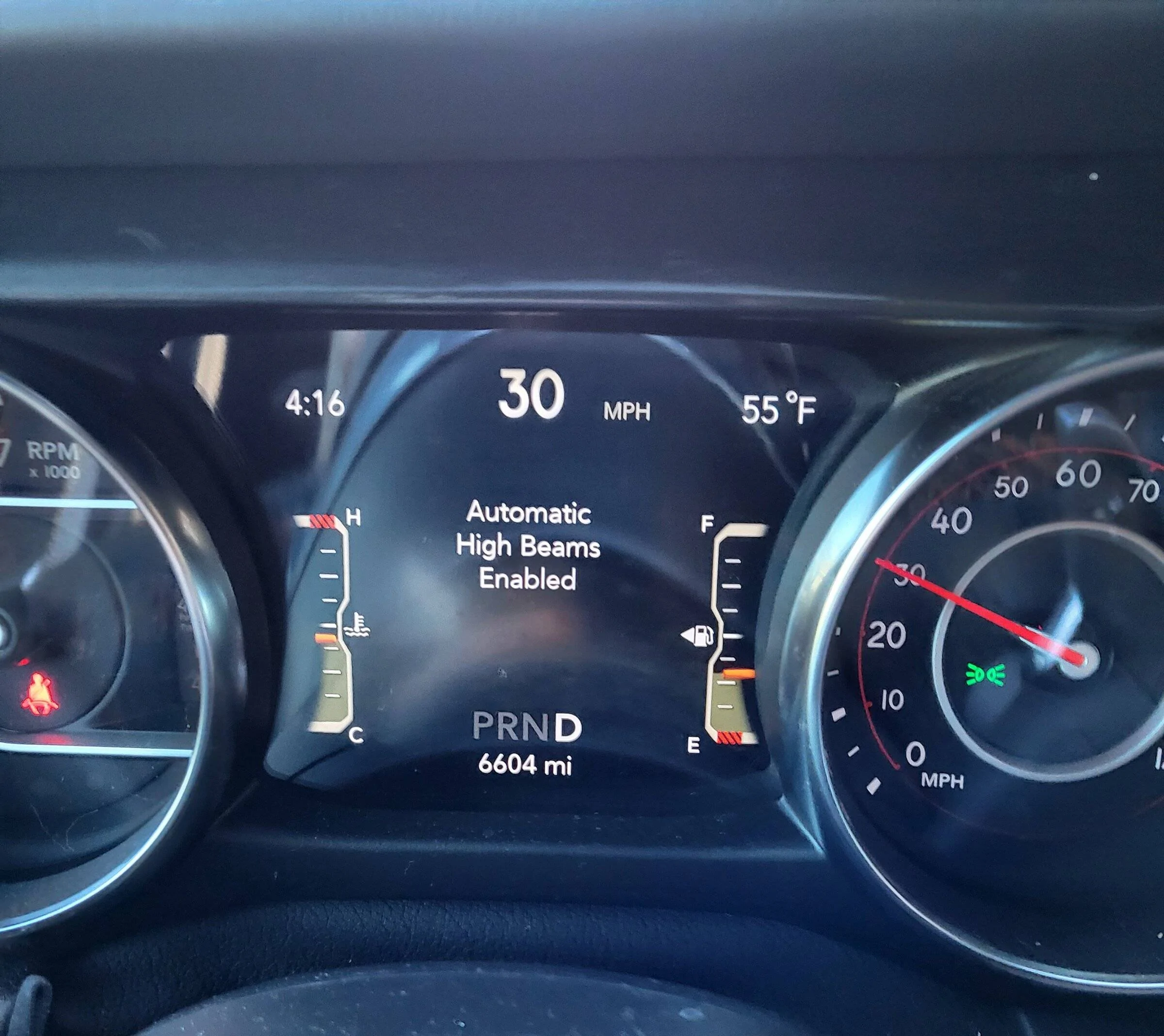

I'm getting this message like 100 times a day. DURING THE DAY. First it says enabled then its says some other crap, lights go on and off.
Did the last update screw something up? Is my jeep the only one doing this? I never got this message before a month ago. I didn't even know I had auto high beams until all this started. It's annoying. As you can see in the pic, it's hella bright no clouds in the sky. So why are my lights coming on and off and giving me this message. I have it set to auto for the light setting....

I get it. But it does seem like the ambient light sensor on top of the instrument panel is wanky. Mine is very sensitive (too sensitive). On a bright day, if I drive under some trees after a few seconds, the headlights will come on.
Hope you get this resolved. :)

At the risk of getting a stapler thrown at me, have you always had “auto-dim” disabled and the update turned it on? Do you usually have the lights set to low beam and perhaps accidentally left them or bumped them into high, netting the message that your lights are changing automatically?
If I recollect things right (still on first coffee), that message pops up when your high beams are on and your mirror senses incoming headlights. When that occurs, it drops the headlights to the low beams and flashes the message. Once it quits sensing incoming headlights, it kicks the beams back up to high.
If your Jeep is not configured for this feature but the women and old men at the dealer flashed your ride with the wrong software, that can confuse your EVIC system.
If you set your high beams to low manually and leave it there, does the message stop?
If you turn the lights from auto to off does the message stop?
If you disable auto-dim in the settings, does the message stop?
If you’ve finished off a six-pack and already traded off the Jeep for a Grand Wagoneer, auto-dim comes standard…..
Mine has all the bells and whistles. I have always set it on auto and never messed with any other settings regarding the highbeams.

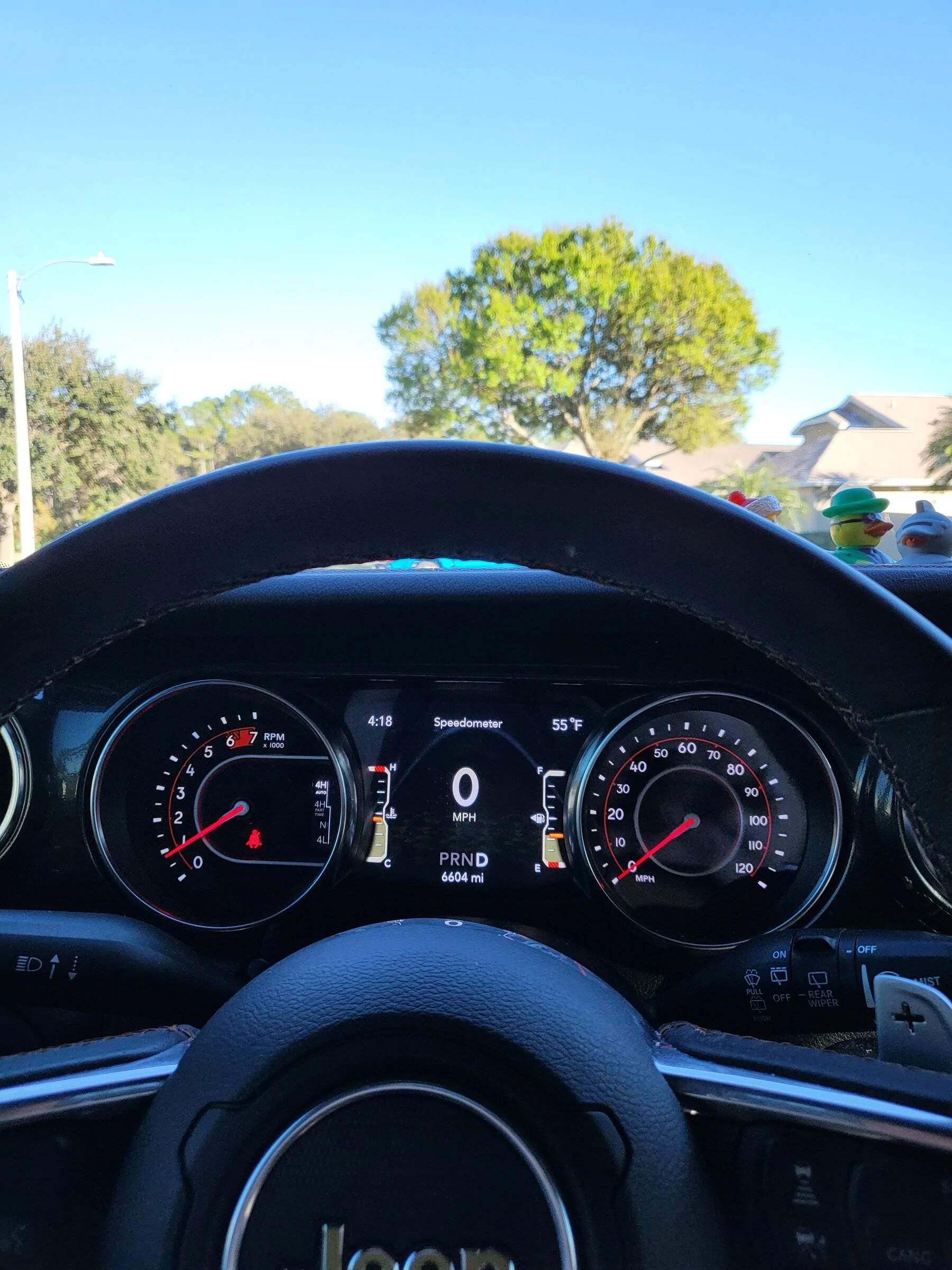

I don't mind the auto highbeams... I'm just mad the lights are coming on in the daylight....bc (smh) then I can't see the uconnect screen, it goes to night setting which is too dark during the day.
