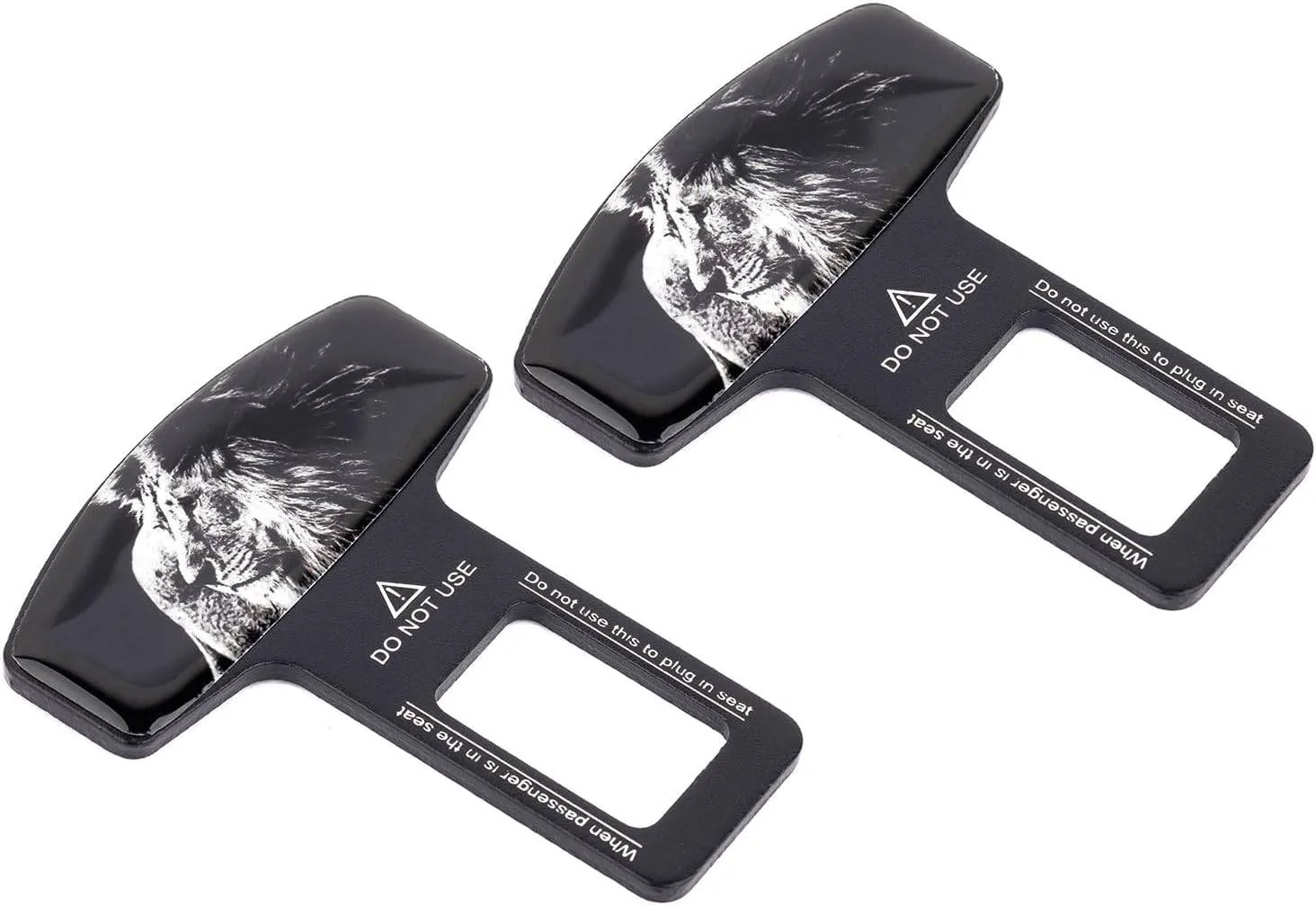

This is *not* a discussion of whether taking a soft top Wrangler thru an automatic car wash is a good idea. I've taken our soft top TJ thru automatic car washes for 20-years with zero leaks or other issues. And I intend to do the same with my new '23 soft top, 8-speed auto tranny 2-door JL. But this is the first vehicle we've had with Auto Park which is causing some concern.
I've been reading old posts on this forum and others online about the best way to take an Auto Park enabled Wrangler thru an automatic car wash. There seems to be one and only one way to send the Jeep thru the wash without triggering the Auto Park and that's to re-buckle the driver's seat belt after getting out of the vehicle.
- Leave fhe engine running for the attendant
- Put the auto tranny in park and get out
- Re-buckle the driver's seat belt and retain the key fob
These steps, allegedly, will prevent the Wrangler from jumping into Auto Park. True? Are other new vehicles eauipped with Augo Park? Are car wash attendants aware of Auto Park and how to trick it?
One old post suggested purchasing a plastic selt belt clip (link below) to insert into the seat belt receiver instead of the actual belt. That seems like a good idea to avoid car wash attendants from unbuckling the seat belt but I can't locate one on line. Anyone have a lead on that?
https://www.wranglerforum.com/attachments/sb-clip-jpg.4205691/
Thanks.
Rich
I bought a seatbelt extension on Amazon and that took care of the auto park issue. I run it thru the auto car wash every week with no problems. Jeep thinks the seatbelt is buckled all the time. Cheap fix.

The belt extender is the best $20 mod I have made. Auto Park was an extremely aggravating PITA with gate in & outs. ? It took me a few days to stop habitually reaching too low and unbuckling it ?
