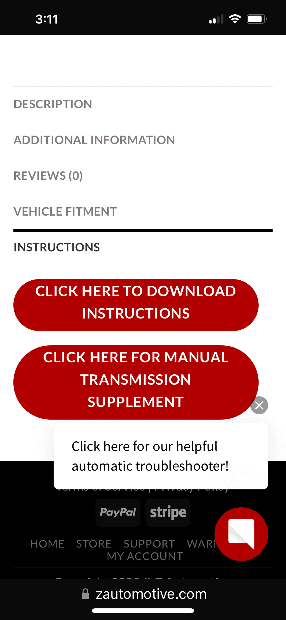

OP; do you have a Tazer installed?
If so, there’s a manual shift supplement for getting the error you’re experiencing cleared.
