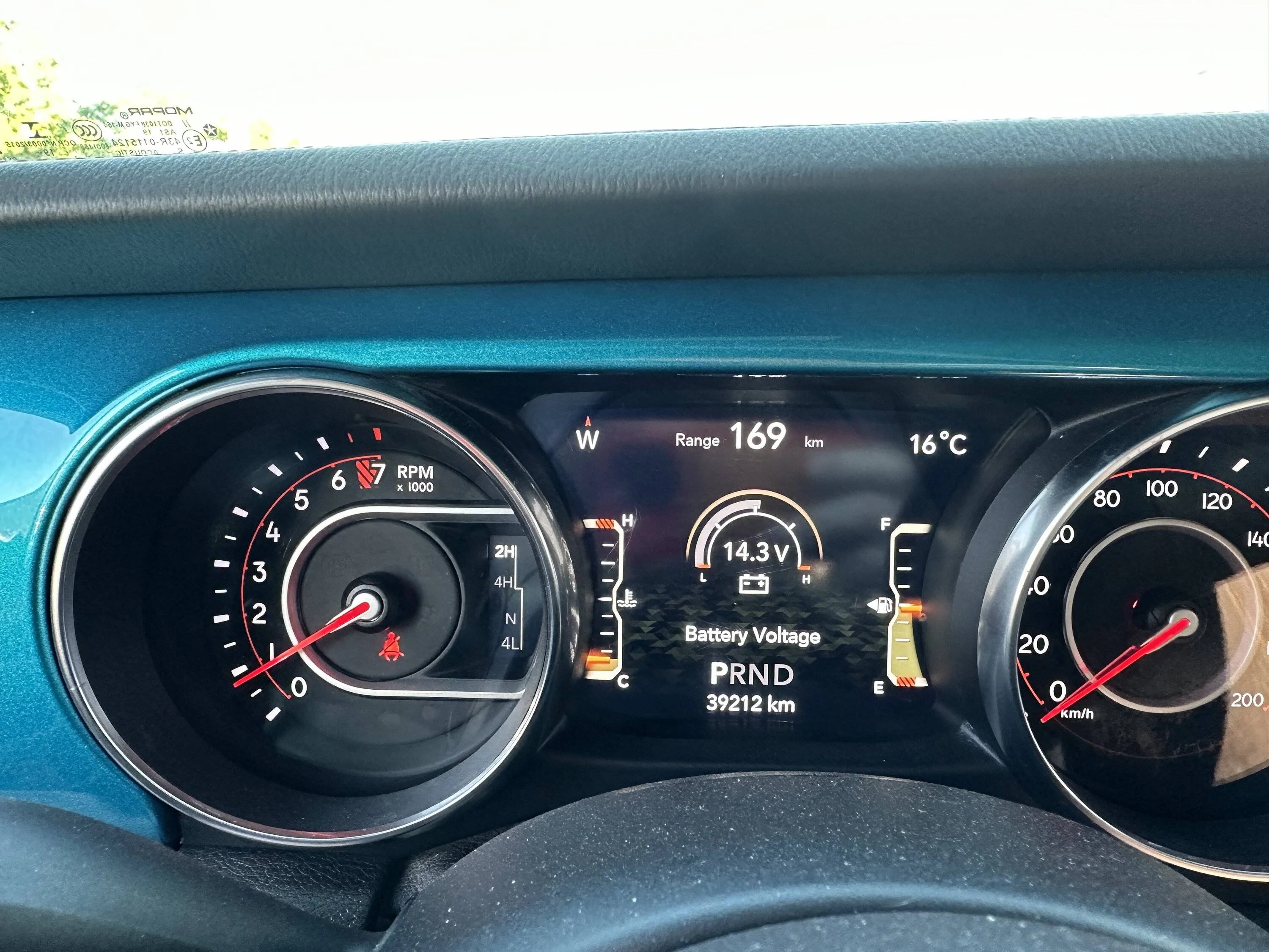

Started first time and showing 14.3v out of the gate. Something we’ll keep our eye on but hoping this means we’re in good shape.
