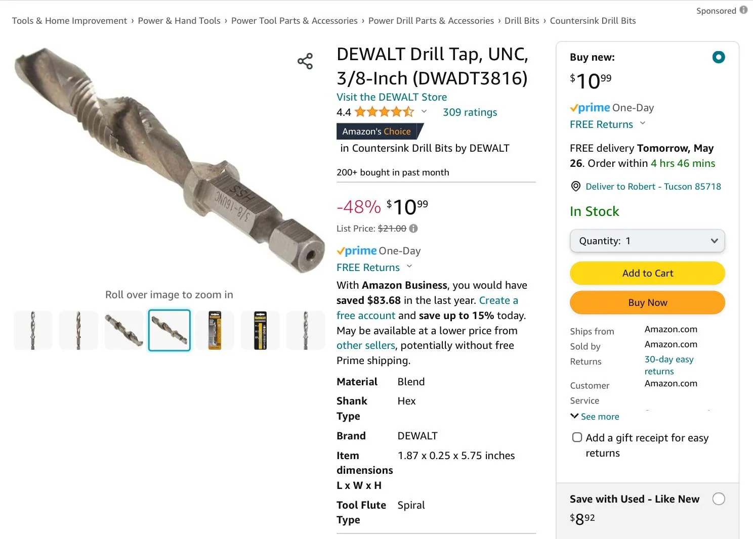

I think I’m going to try this. The hole is about 1 inch deep. So it might work if the end of the bit isn’t too long. I’ll do it by hand.

I would be afraid that that type of a tap won’t want to go in straight. I personally would use a regular tap. Also, if you’re not able to find a bottom out tap, buy a regular tap and try that and if you need to you can grind, probably a quarter inch off the end of the tap to make it more of a bottom out tap. But, if the hole is 1 inch deep and it’s only the first couple of threads a regular tap should do the trick.

No.
Dont go this route.
As stated above, go NPT or a plug tap.
Manually. Slow and accurate. A power tool drill tap is meant for a fresh hole. Not doing a thread chase.
You want a little lube, and a true hand. It'll come out fine.

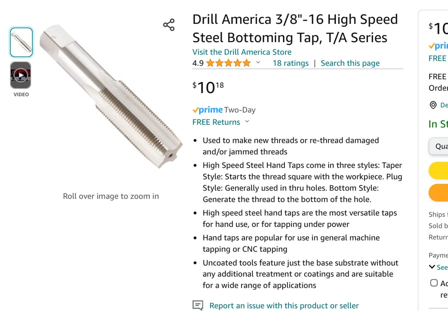

I ordered this…

The bottoming tap you ordered will work…but - what you really need is a thread chasing tap. You don’t want to cut new threads, you just want fix threads you buggered. A thread chaser won’t cut new threads, a tap will. If you use the bottoming tap, make sure you start it in the existing threads, don’t cut new ones. Go slow, use some oil.

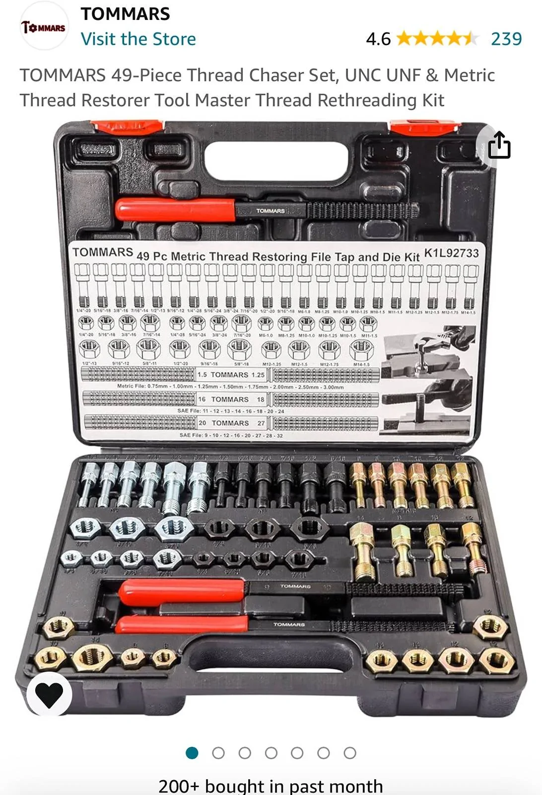

DO NOT USE THE TAP!!!! I’m guessing the people on here don’t realize how a tap works. It’s not for cleaning up threads. It’s for cutting new threads. There is no way you’re going to get it perfectly lined up to the original cut. You’re going to damage them even more the tool you’re looking for is called a thread chaser.

That was my concern, if I tried a tap - to get it lined up. I’ve ordered a thread chaser kit.
