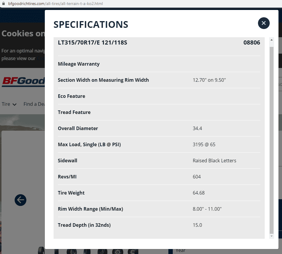

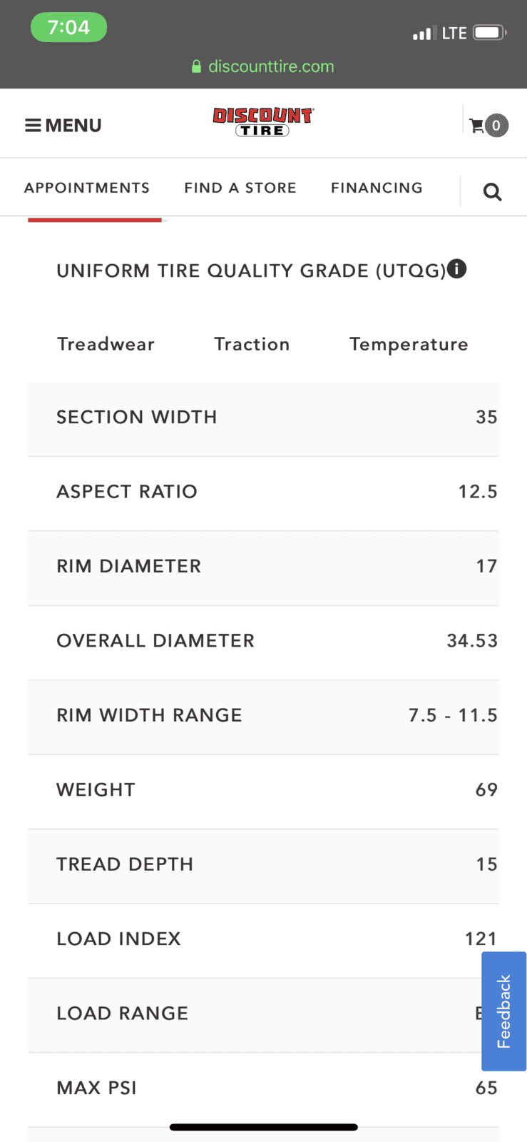

BFG KO2 35 bruh?
There is so much misinformation spread by a few select people on this forum, it can get frustrating at times. There are a lot of people who intentionally do this so they can air down to a lower psi without losing a bead. Still falls within spec for “most” tires.

BFG KO2 35 bruh?
Manufacturer's website... versus discount tire. I know which one I am going to trust.

BFG KO2 35 bruh?
That's 3rd party...prob put that width for sales.
The min. rating is 8" go to Mfg website.
Take a lap dude
Take a lap dude
Funny enough, years ago Discount Tire itself refused to mount 35x12.5 General tires on my factory 7.5-wide Rubicon wheels because they fell below the manufacturer’s recommendation.
