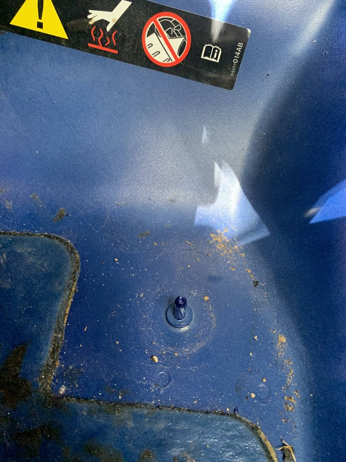

Another install question: when I removed the plastic posts in the front floor pan that attach the mats, it leaves a small stud exposed that the plastic posts screw down onto. The stud is small and pointy. Won’t this poke through the Armorlite floor?

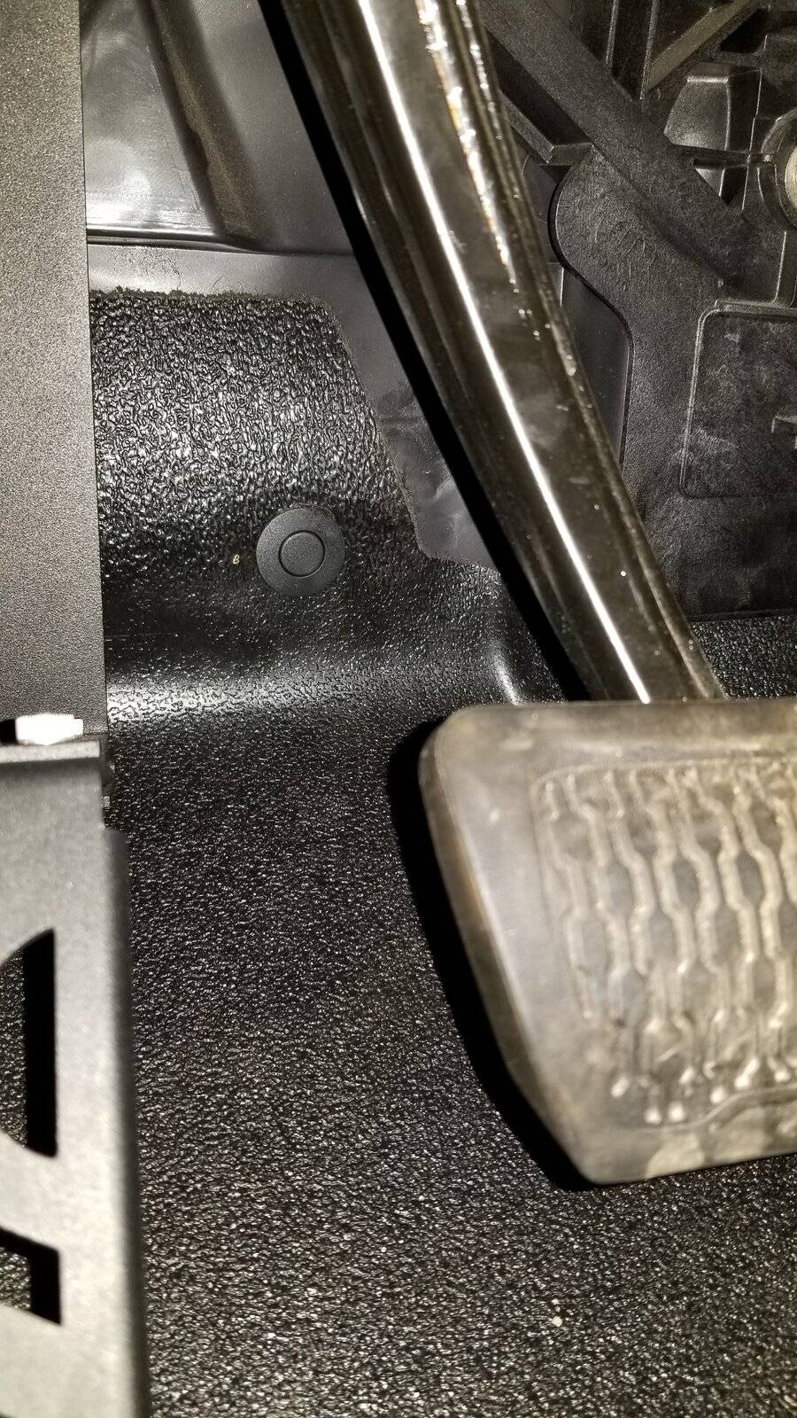

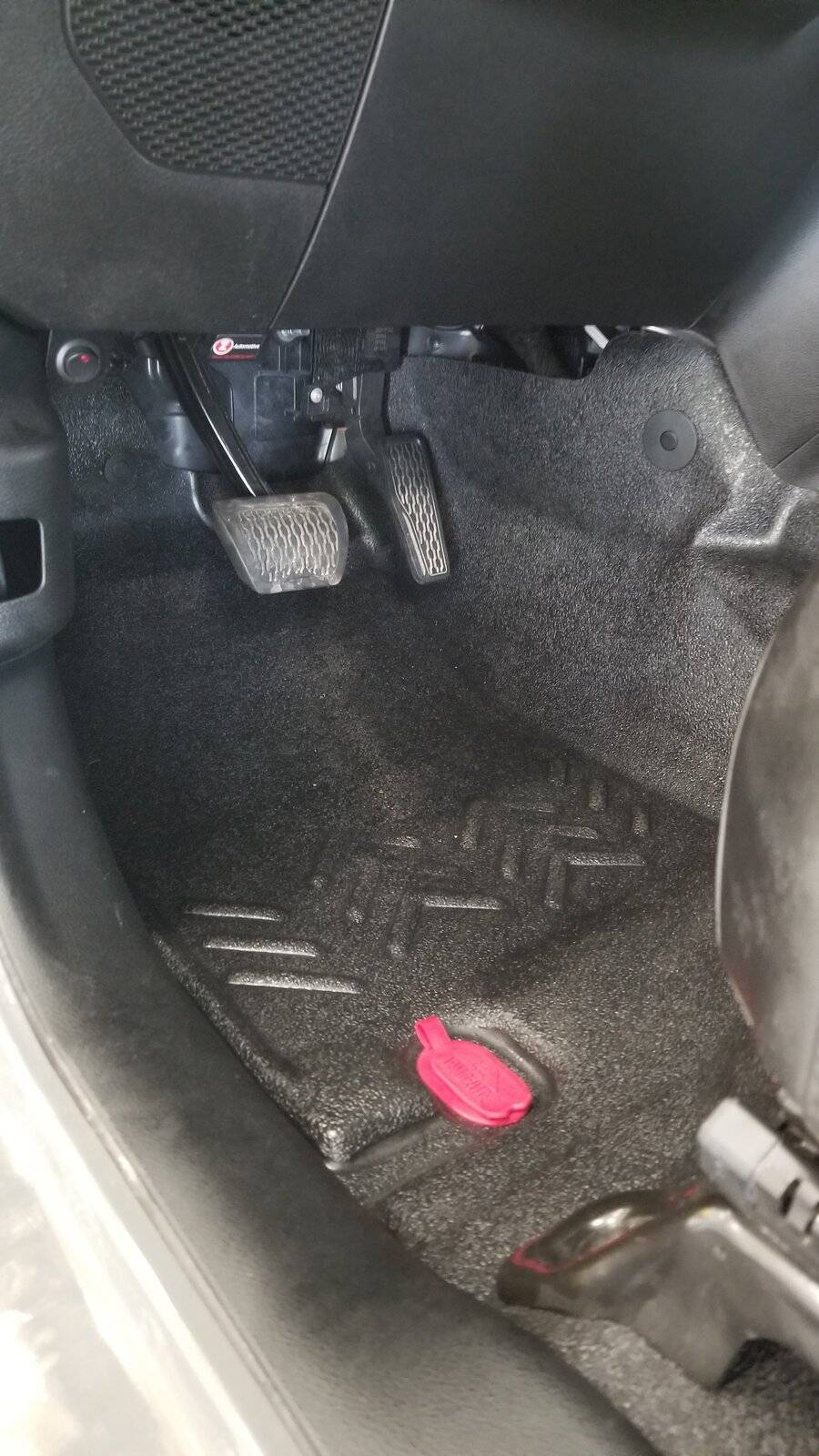

Did you use the floor mat clips to snap it in? It doesn’t seem like the ones holding the carpet will go through the holes they drilled.
Used the carpet ones, here are some pictures. The smaller holes in the Armorlite look good with just the back side of the carpet clip. Don't need the front piece. Looks factory finished this way.
I also used a couple in the back.
Thanks, I will give it another go. It does look really good. Those things are a pain to pry apart…
Yes they are, I used one of those pry tools that come with the no-mar trim kits on Amazon. I have e a couple so I actually used 2 probably could use 1 and a screwdriver. I wasn't very excited about the holes being "unfinished".
It is designed to go over those, it wont poke through.

https://www.moparpartsinc.com/p/Jee...iUuvfI6oumEC5qaVXHu830luyY4gl_GoaAp3LEALw_wcB
You can buy them from mopar or on amazon and ebay. You only need the outer part as it is the one that clips on the stud. The inner part is to hold it on to the floor during installation at the factory.

Very happy with it so far, although I think it is a little thick in a couple of places like the rear seat trim or the console. I had to push the console down while the wife put the bolts back in.
It actually made a pretty noticeable difference on the sound level inside the cabin, which I know you guys advertise but to be honest I wasn't expecting much. Mostly bought it for ease of cleaning up sand and such.
