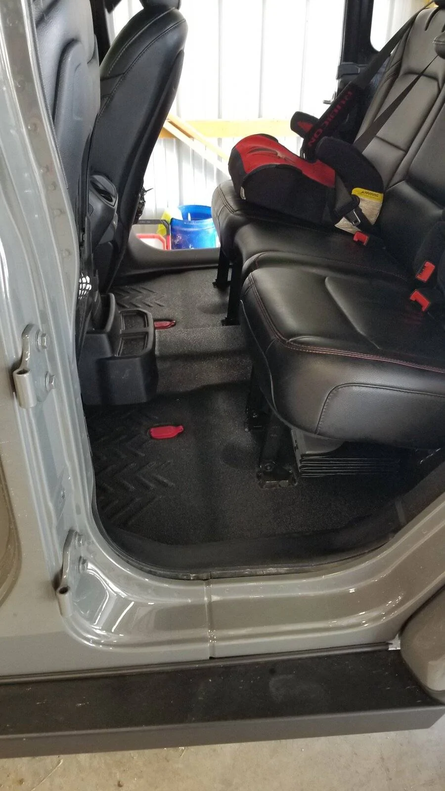

Jeep Wrangler JL Armorlite JL Floor System 20210511_131626
Not a fan of the stress gaps created by the thickness.. May want to use thinner insulation where it goes under trim, have checked and rechecked the cause of tenstion is flooring thickness from what i can tell.
Low_Spark
Apr 14, 2021
326
295
Washington
2021 JLUR 4XE
While not ideal, how feasible is it to shave off a little bit of the insulation where it slides under the panel?

Yes, trim or something. Panels under the door jams popped loose snapping multiple clips on the wire troughs. In hindsite I should have done similar or shaved insulation off the edges.
In regard to the console, I have been able to push it from the back before tightening. But I will pass along to the engineers to see if they can add compression to the insulation in this region.
Issues with side trim tabs breaking is usually from forcing the install downward and not on a horizontal plane. All of the clips install by engaging the clips in a motion away from the console towards the outside of the vehicle not in a downward motion.
Best method is to identify where the clips clip in, then line it up apply pressure down on the trim then pop it in by pulling it towards you (outside of vehicle) you should be able to pull it but a light bump with the bottom of your fist can do it. If it does not click in do NOT force it, instead patiently try to line it up better. This is where taking some time really pays off. I personally have done ton of these and this method has worked perfectly for me.
We are working on some videos better explaining these tricks. Since the JK generation had issues with trim coming loose and carpet blowing when doors were off, the engineers threw in every clip they could on the new models.

Yeah, i have since figured that out, will be ordering another wire trough. Its is helpful to push down, then slide into the clips i found.
I was sliding from the console to the outside. The thickness of the flooring creates a mismatch if you dont give a little down pressure while sliding back home.
I get to do it again, half of the chevrons were not pressed in so another set is coming.

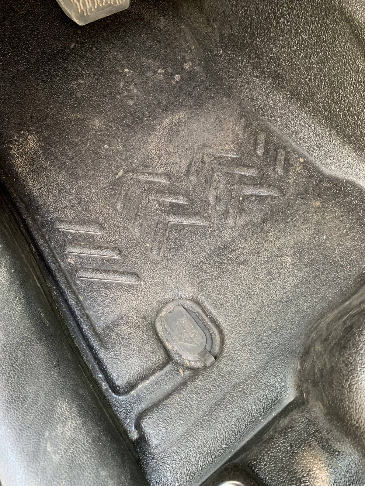

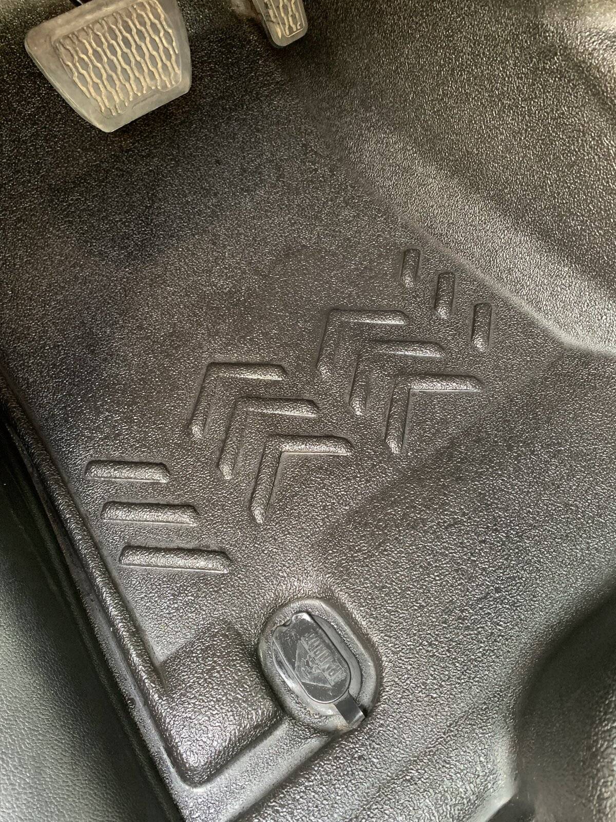

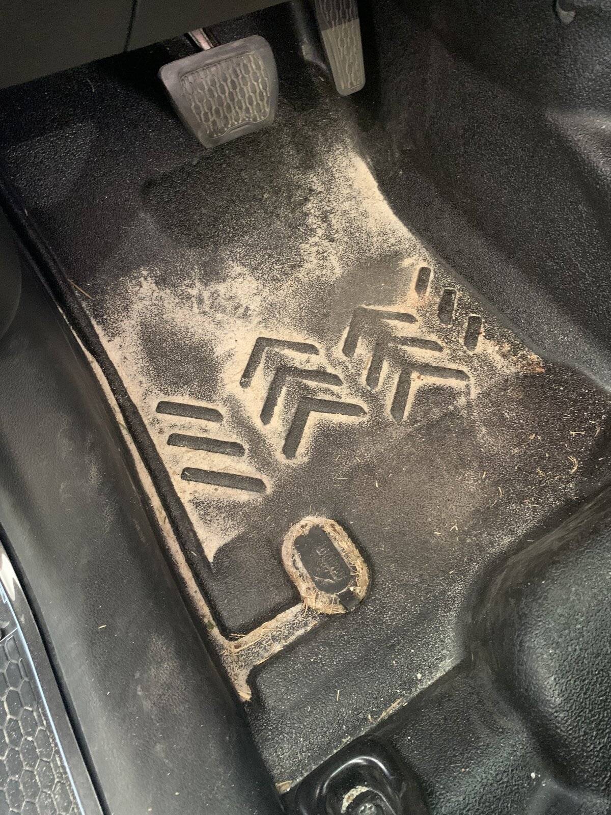

Spent a week at the Beach in Panama City for Florida Jeep Jam. Accumulated a ton of sand in the footwell. This first pic is of all the sand I was grinding into the floor for a week.
Jeep Wrangler JL Armorlite JL Floor System 8A8754DE-9EBA-4DB1-A609-B266D7B21601
The second picture is after vacuuming the loose sand.
Jeep Wrangler JL Armorlite JL Floor System 9FA1E232-9AA9-45F8-9320-33641126AC07
The final pic is after wiping the floor with a towel wet with soapy water. Floor looks as good as the day it was installed.
