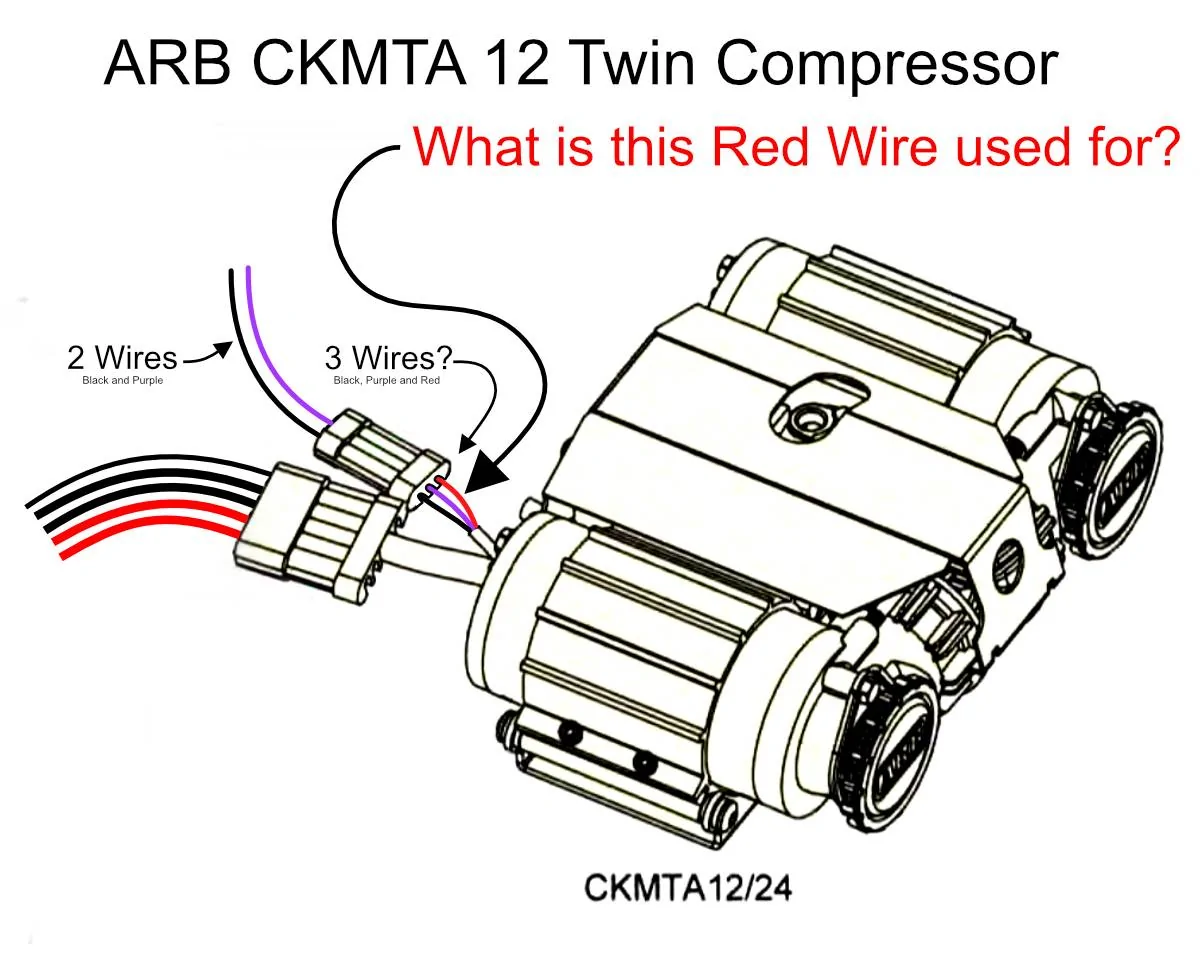

I was installing an ARB Twin Compressor a few days ago and wondered why the switch loom connector has a 3-pin connector with two wires on one side and three on the other.
The wiring layout does not show the wires between the loom connectors and the Compressor, so I mocked up an illustration:

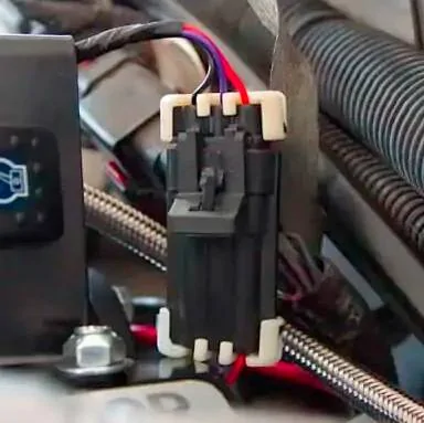

Here's a photo just in case it helps:

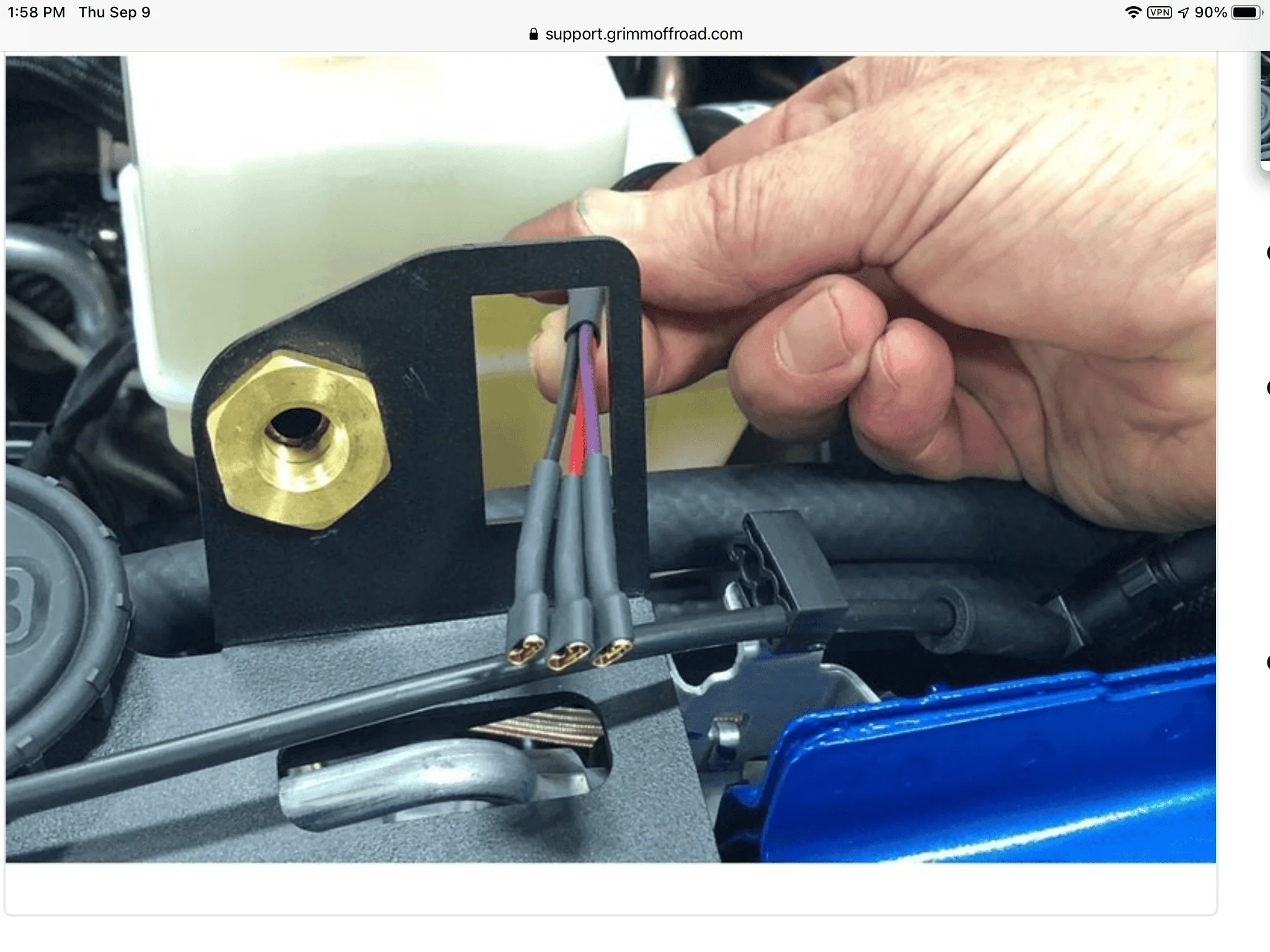

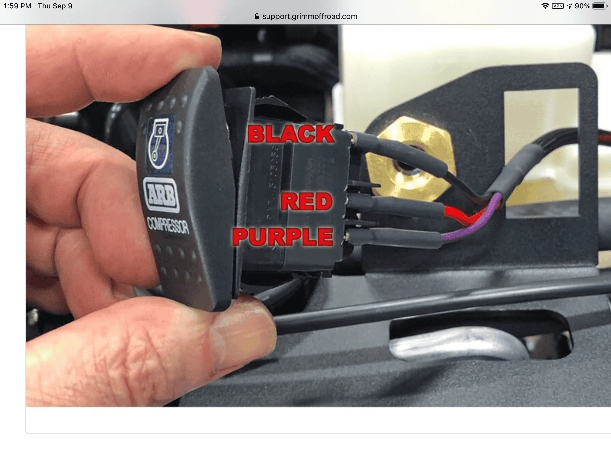

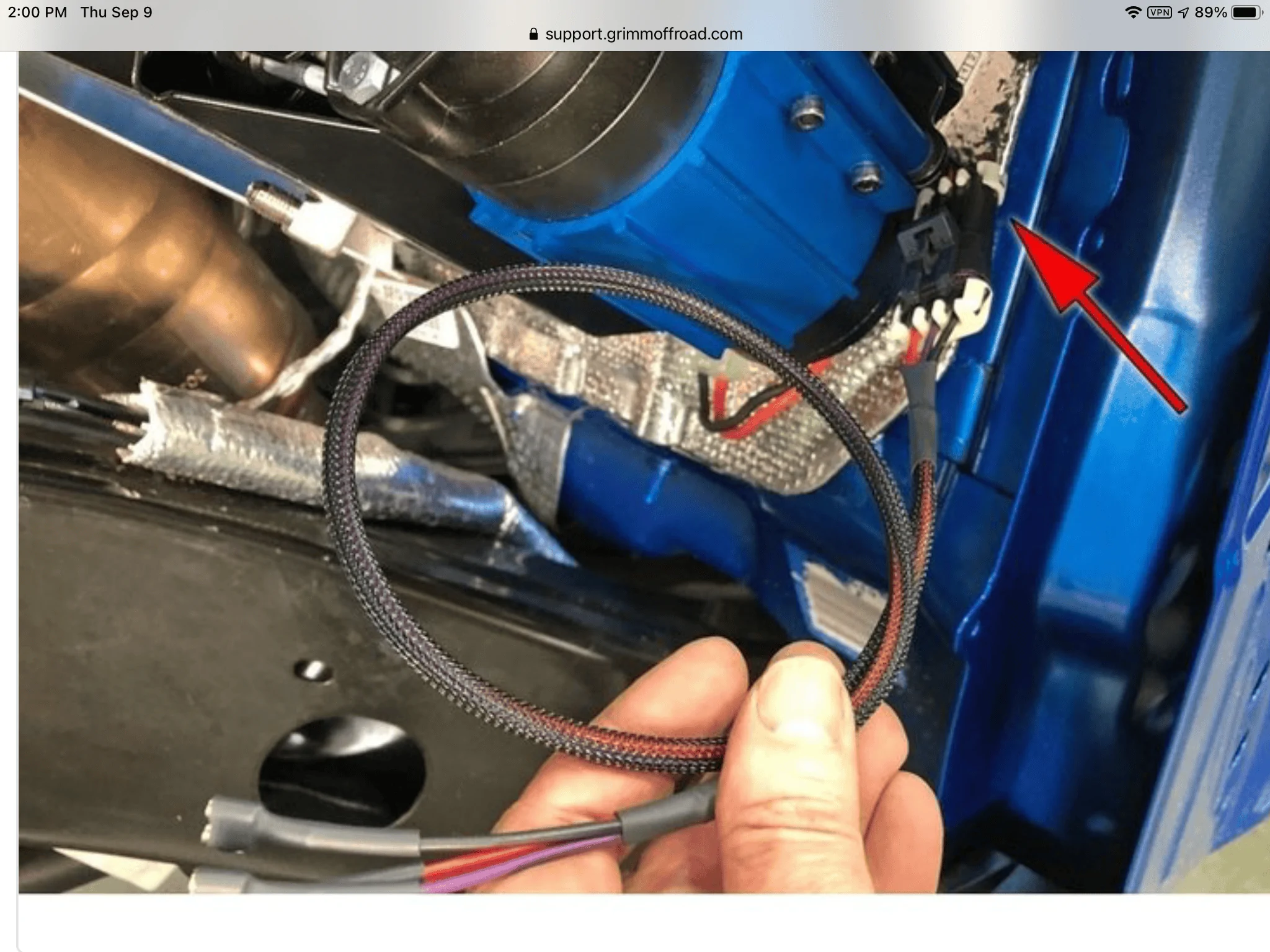

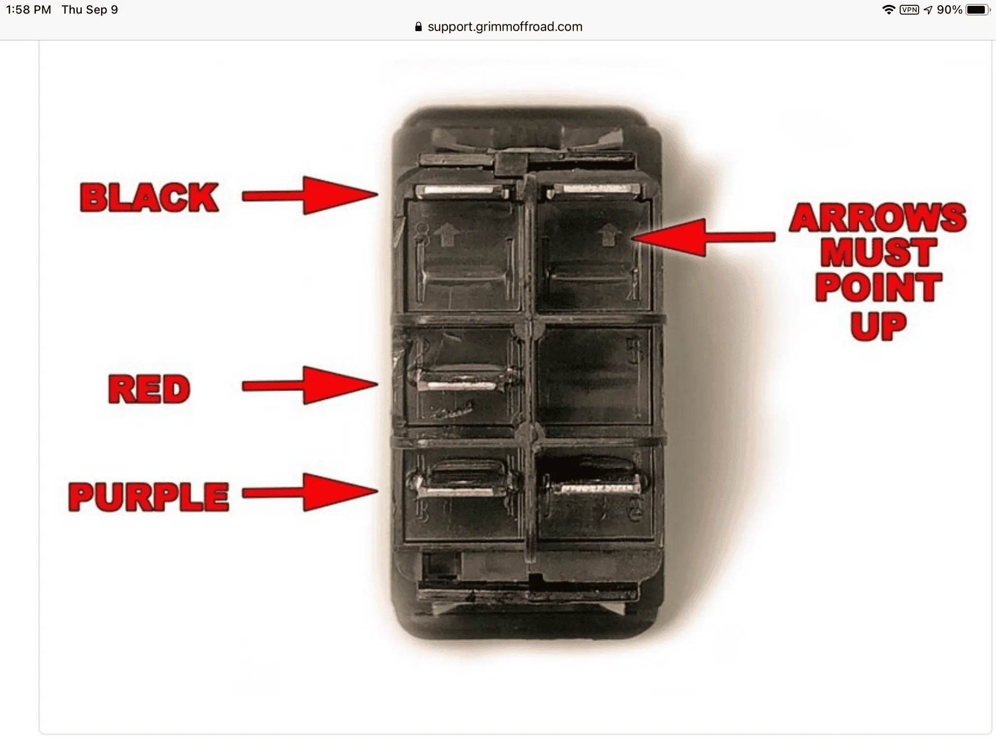

I don’t have a direct answer. I wired my ARB twin with a Grimm Offroad replacement 3 wire harness that connects to the back of the ARB switch for a simple constant 12 volt on off switch. The back of the ARB switch looks like this. I’m not sure if that helps or just confuses things.
Jeep Wrangler JL ARB Twin Compressor: Extra wire at switch loom connector? IMG_1577
Jeep Wrangler JL ARB Twin Compressor: Extra wire at switch loom connector? IMG_1578
Jeep Wrangler JL ARB Twin Compressor: Extra wire at switch loom connector? IMG_1579
Jeep Wrangler JL ARB Twin Compressor: Extra wire at switch loom connector? IMG_1576

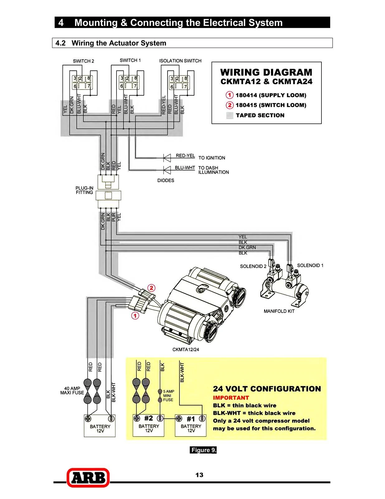

When I studied the wiring diagram in the supplied manual, I could not see any reason to connect wires to the switch pins 2, 6, or 7 unless you were using the Ignition or Dash Illumination features. It seems that pin 3 Hot and pin 8 ground would be sufficient to switch the compressor on and off. I could be wrong.

I believe it is +12V from the compressor power supply. The compressor switches on when purple gets +12V, so is the supply for the switch. The other ARB configurations (air lockers etc) get their +12V from the ignition via a diode, so don't use the red wire. I'd double check with a multimeter.

Thanks for the information. This is starting to make sense. I guess the Black ground is just a safety ground, the Purple is a 12v "return" from the switch, and something needs to supply the 12vDC through the switch to the relay in the compressor assembly.
The source of the 12vDC could be the ignition circuit or a split from the compressor's main power supply.

The red wire tests out showing it is tied internally to the +12V power to the compressor motors. It appears to be provisional and with their current wiring is not needed.
The purple wire is used for the pressure switch / motor control relay and is to be connected to a compressor on/off switch. It needs +12V to operate.
The black wire is a ground and is tied internally to the small ground wire in the motor power connector. It does not need to be connected (if the other small black wire is already grounded).
