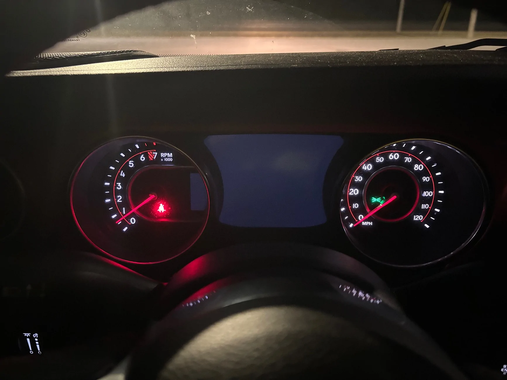

I have the same issue going on right now with my 2023 JLU with 37k mi. VIN not included in recall. Initially wanted to charge over $1600, agreed to replace for $129 under Goodwill after complaining with customer service.
10 days in quarantine so far at the dealership. Was told part would be expected in a week initially, now they aren’t giving me any timeframe and will not provide a loaner.
way to go Jeep :no:

I am having the same problem on my 2019 is the only solution getting a new cluster? Some forums say replace the batteries which I plan to do this weekend but they are still in green during battery test just a little low. The screen went out 12/7/25 came back on 12/9/25 for first ten minutes of drive then went back out. It is still back lit so idk. The recall seems to just be for the 3.5 base display
Weird. The funny thing is when a LCD craps out they go white, not black.
It's still possible that the flex cable itself is just broken and not repairable, thus the new lcd module getting installed by united radio when people send em in.
Not so sure about that. My lcd verified was out and it went black.
